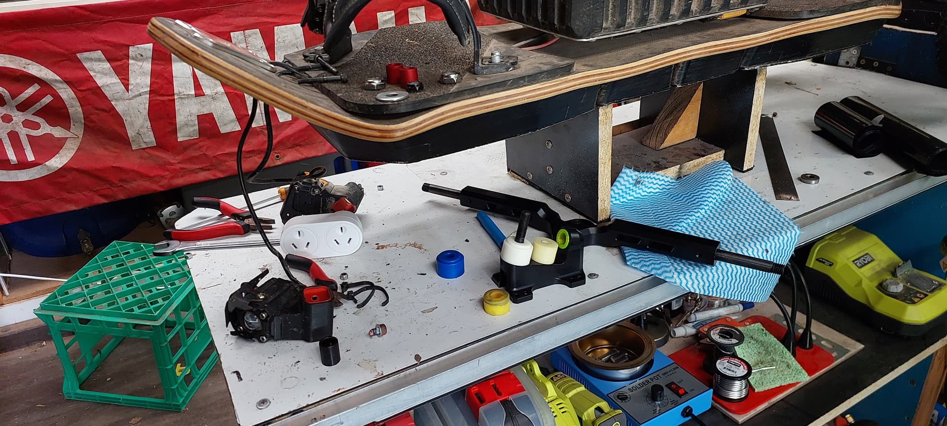

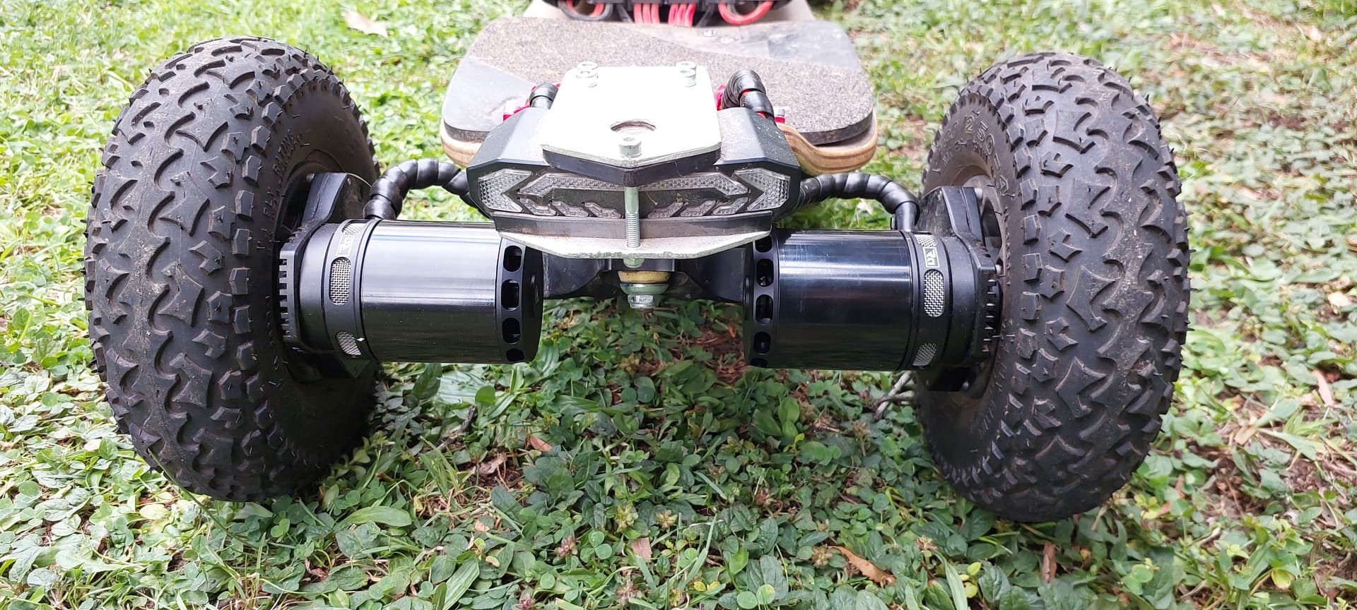

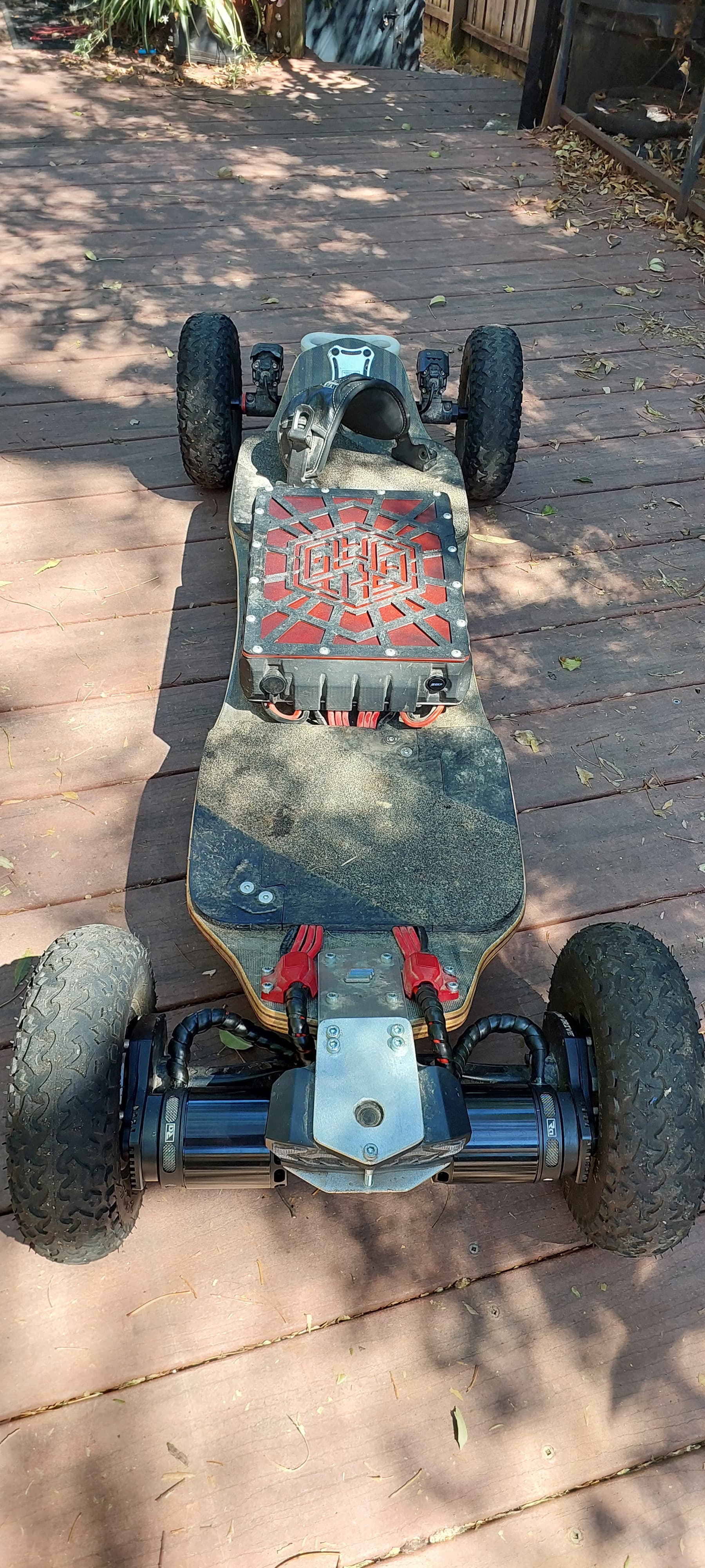

New 151kv radium motors attached and drives reassembled. Back yard test was good so will take for a spin later.
I’ll probably open the drives again to check backlash as they sound different on each side.

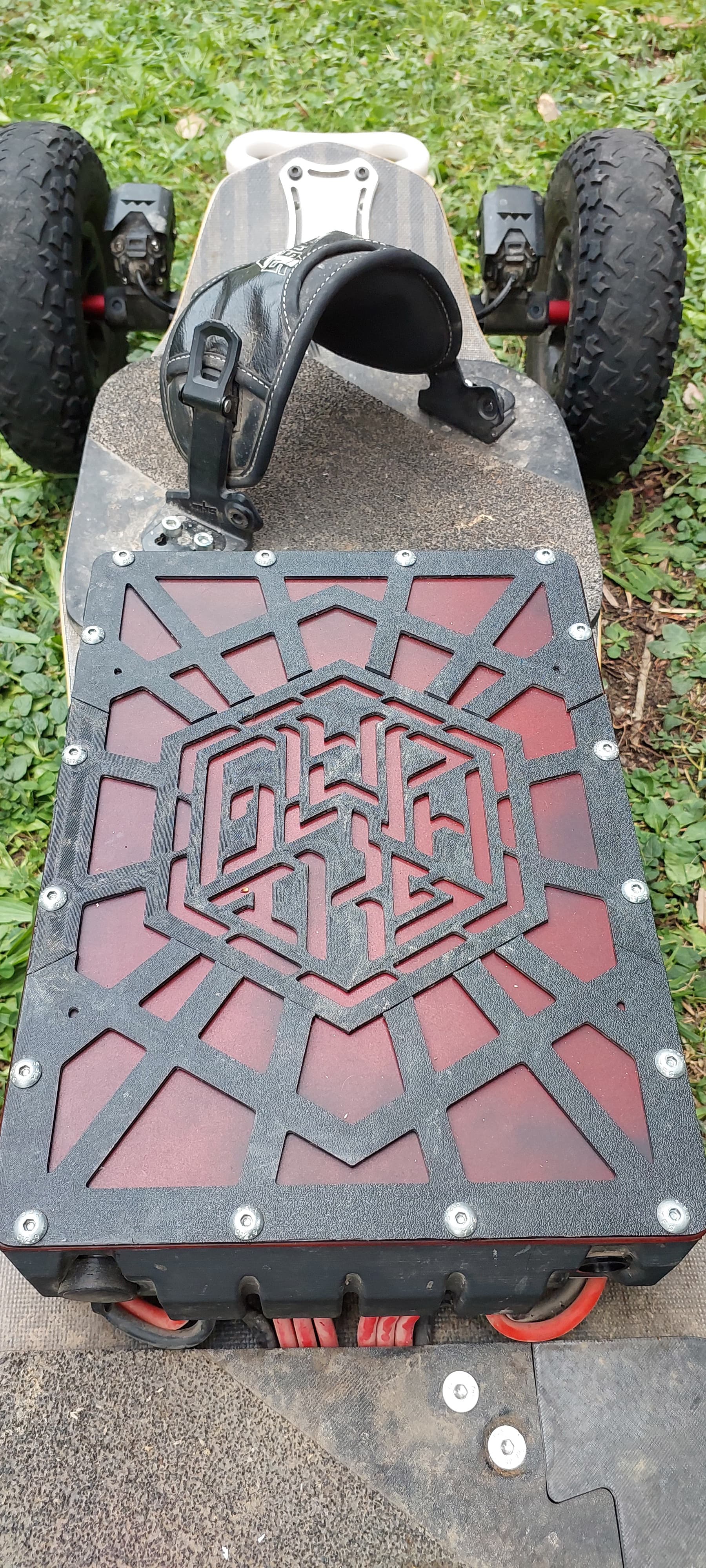

Opened the box and had a poke about inside, so nicely packed :ok_hand: and thought i’d give the box some touch up and kinda ended up on a red underlay with a filthy smattering of black over to muddy it up.
Front truck will be here tmoz so looking forward to an ealy morning golf course run in a few days.
The red lid looks sweet, keen to hear how it goes with the new front end!

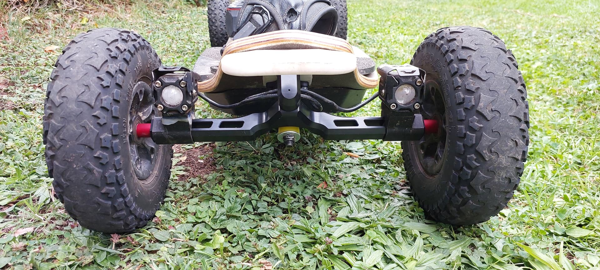

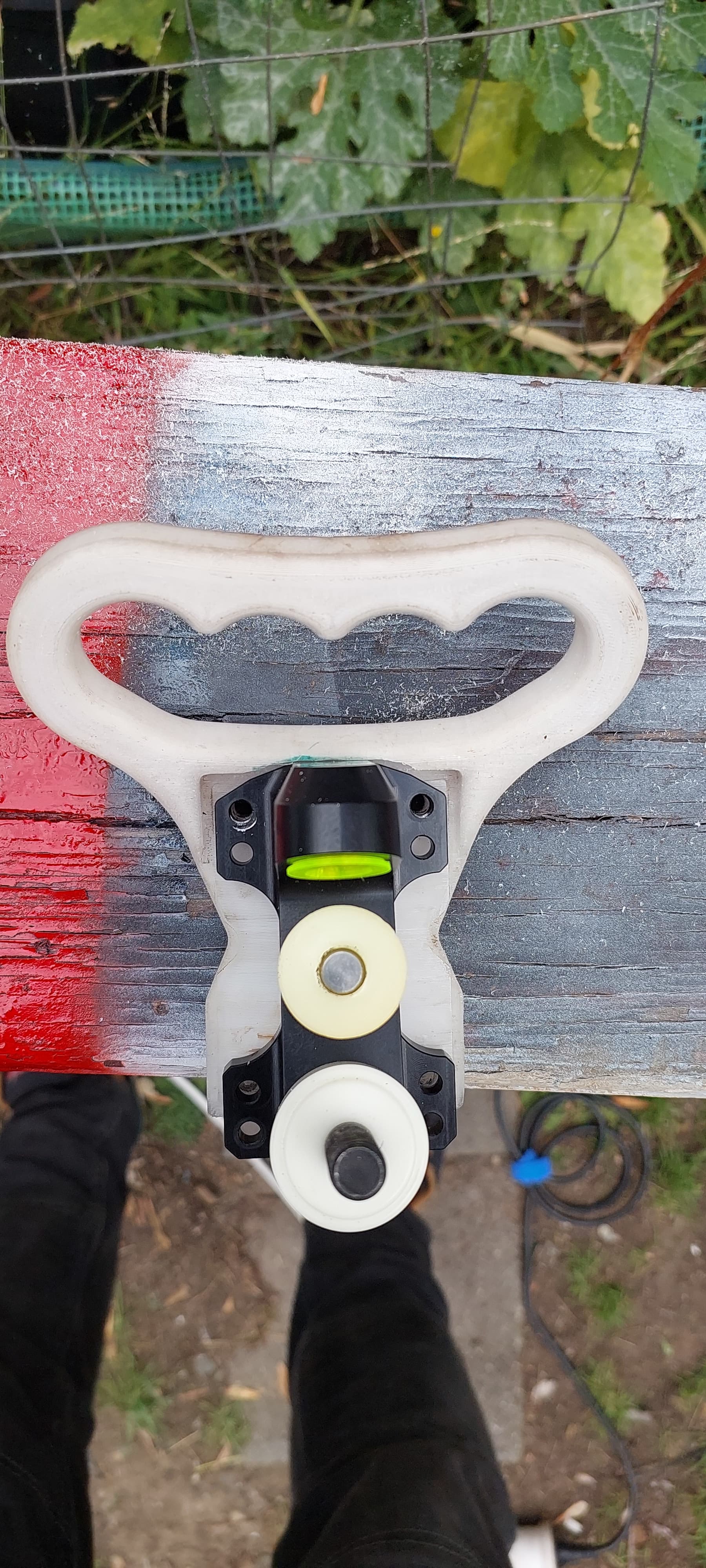

Wasy fit, 2 mins with some good dremel bits
New front
New rear
The lights went on so smooth ive not even bolted them yet…

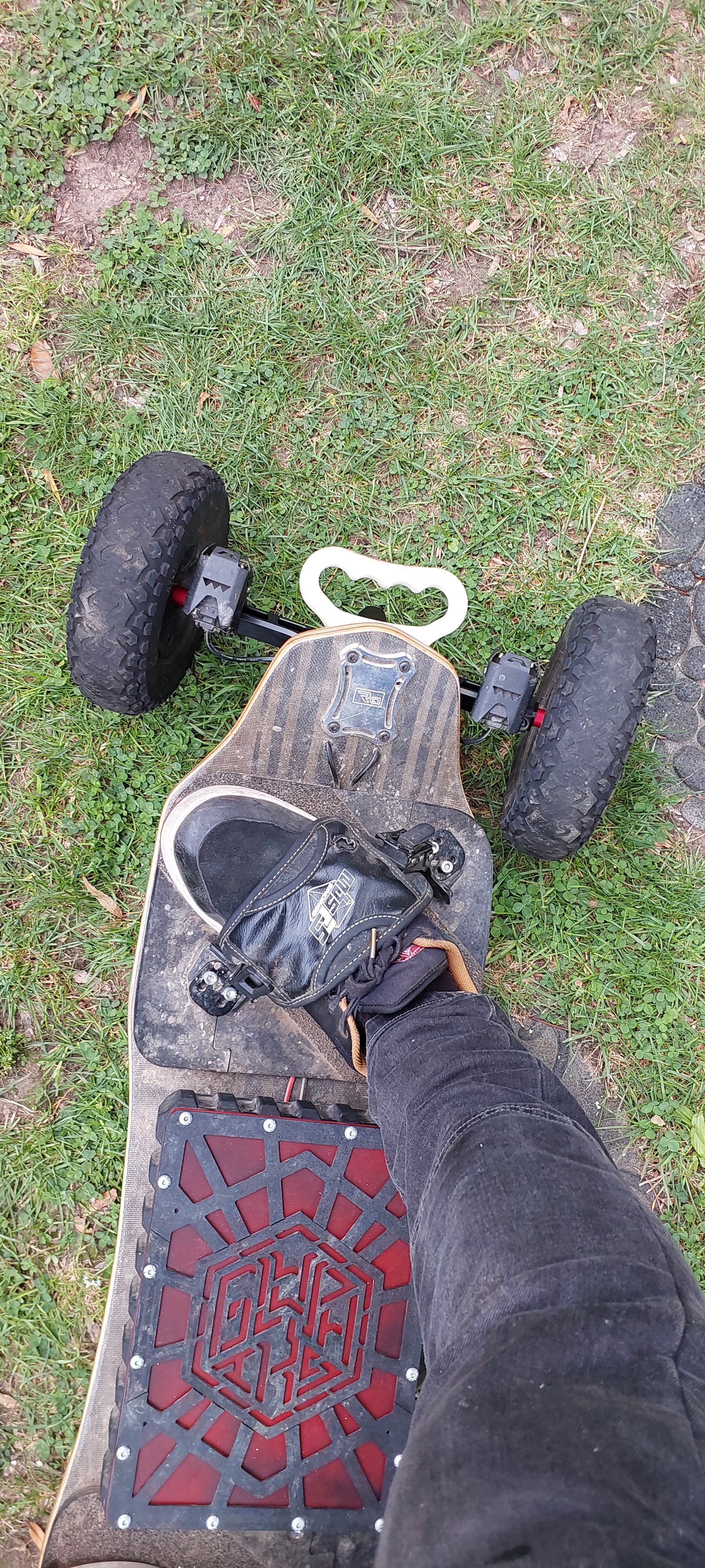

Felt nice and turny in the backyard, ride pending for the feels and i still need to make cables neat and dial in bushings. So far, so good and all worthy upgrades for this board.

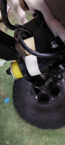

What’s your bushing setup on the Newbee’s? I have tall 90a krank barrel/fatcone on mine. But no third bushing yet. Haven’t ridden them tho, waiting for money to buy a nice deck
Glad to see my lights are holding up out there!
One of them is held together with hot glue :rofl:
I just hit it with a white tall barrel and a chubby. No real thought other than go super soft anf then ill tune harder if required.
The yellows are APS barrels. Can’t remember the duro. They were nice on the airs tho
Lol evidently the mount got a little loose oopsie
Its ok, hot glue fixes everything
Didnt notice when putting it on even. It had sone thin red sleeves on the airs which wouldnt go back on the fit is so snug.
The newbee trucks are sick… even without tuning doing digure 8’s in a small car park gives a great deal of feel.

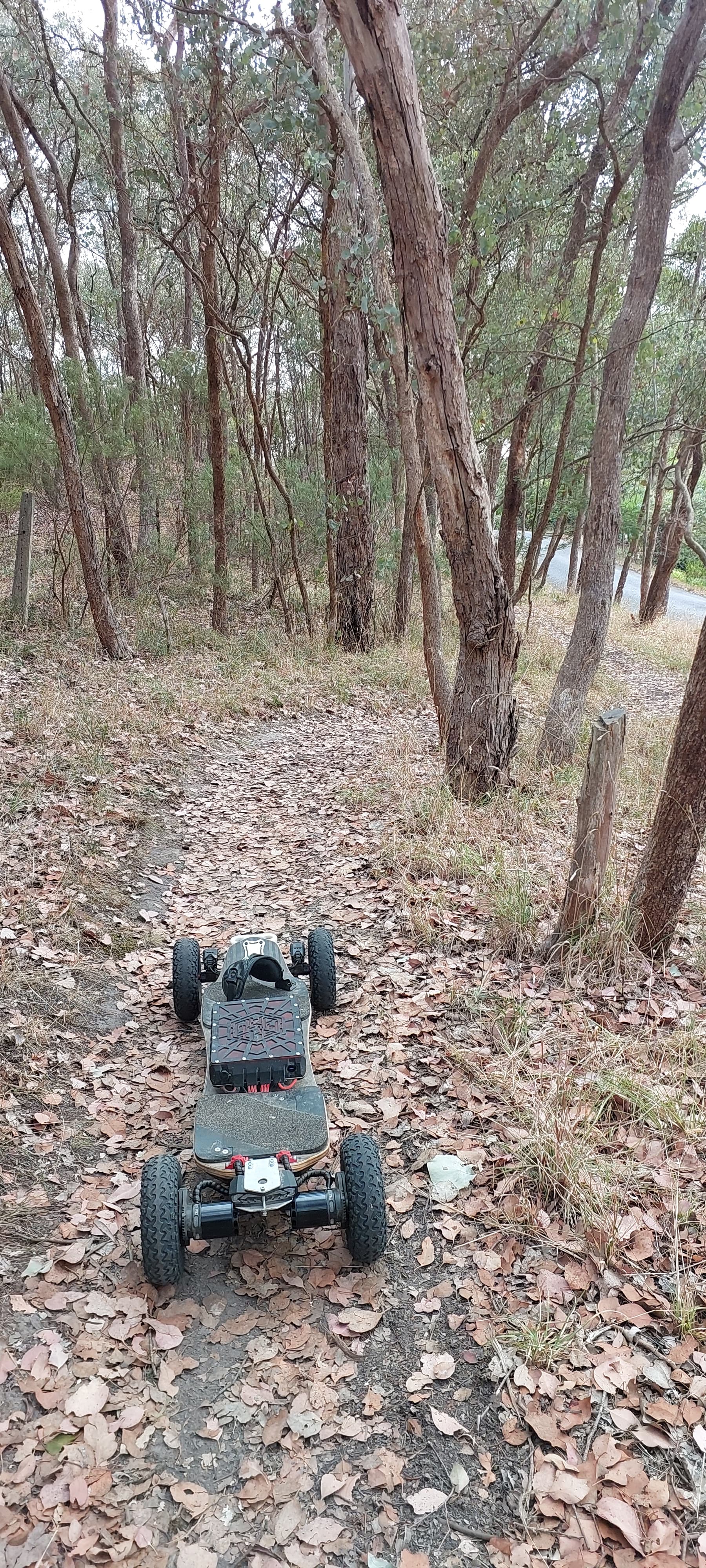

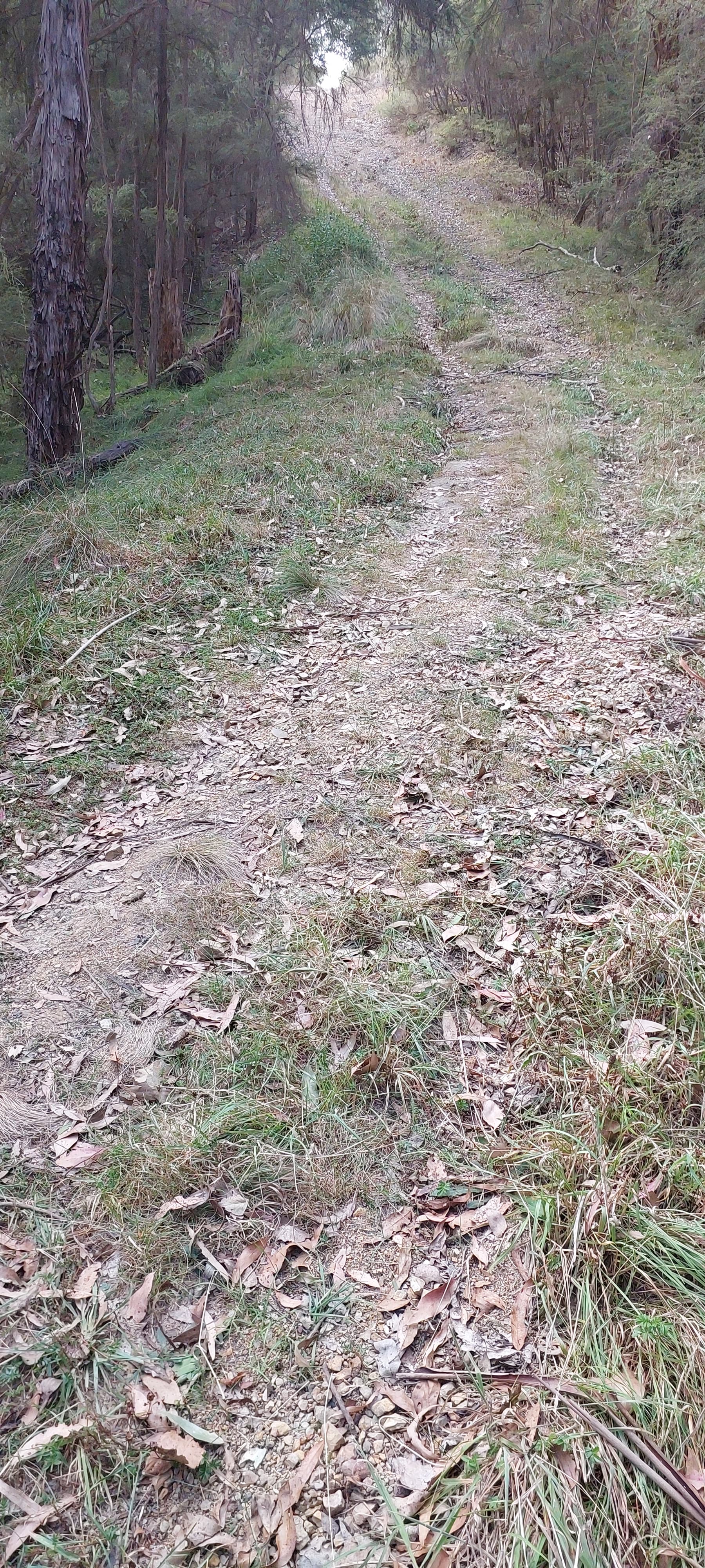

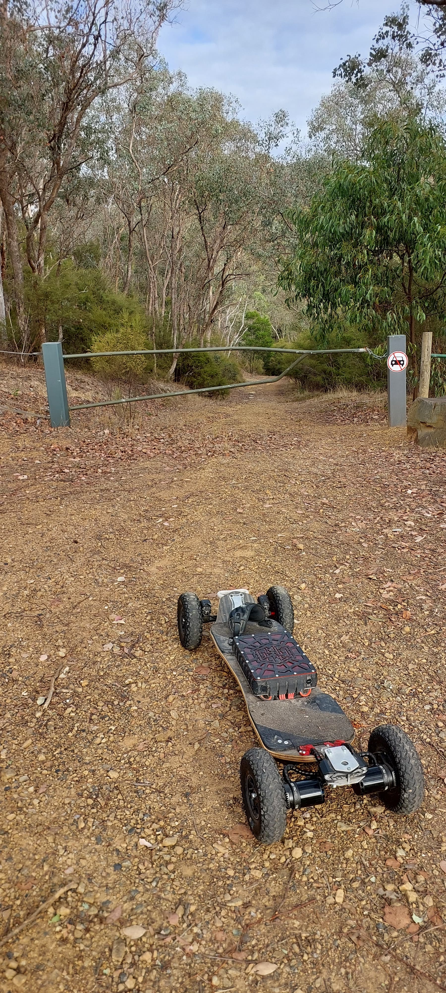

Tight turns through trees are possible… nay… a fun thing to do
Did 2 of the sickest hill climbs ive ever done. Laughed my face hole out. Nearly shat myself a few times both up and down. :laughing:

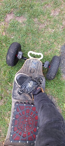

I took her for a spin up the road and its a bit soft at speed so ill dial that in but to be fair, Ive done no tuning still so im certain itll get to where i like it.
Super stoked i waited for these trucks as an option, if you’ve been on the fence… jump over

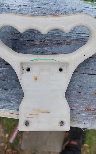

Walking around, quite pleased with myself. I havnt ridden this since I rode it to pick up the M1 and deliberately didnt give Al a ride as something just didnt feel %100…

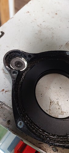

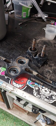

Fast forward to today, and im starting to look at muddy tracks so thought to have a poke about and not just charge on in and go for a ride. Retaining compound failure. Pulley was loose on the shaft and eating the case. Better clean it allup and redo.
Fuckin helicals!
Im dead, :rofl:

Hey Al, over the StepBro’s life, did these 3DP parts ever leak? Not asking about the gaskets between the deck or aluminum. Asking about the actual plastic parts themselves. Like, did water ever leach through pores in the print? I’m planning an enclosure like this for my new build, so I’m curious if I should seal the printed parts or something.
I 3d printed a bunch of plant pots out of the magic TPU. No leaks, if that helps
I never had any reason or concern to open it and find out.
If it was ever submerged for any period of time i might worry, but for splashing i didn’t have any concern
