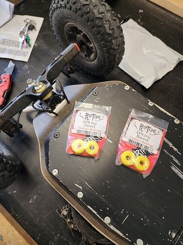

Ordered some 90A APS barrels to replace all my boardside 87A krank fatcones. Just swapped them out, on the charge now then i’ll pop out in a bit to give them a run.
So definitely worth updating the ouch firmware then?
Puck :joy:
Yeah i think so. If you don’t like it, you can tune it back to the way it was. Or like i’ve done, kept a couple OG and just updated one
The bushing swap was great.
Turning is easier to initiate, more fluid and has a little less center.
But i haven’t really gained any turn :expressionless:
And the occurrence of heel and toe bite has steeply increased.
Next steps: add an extra 5 degrees at the front for a 40/30 split and push the front and back trucks out a little to stop the bite. Will push the front a little more than the back to compensate for the extra 5.
