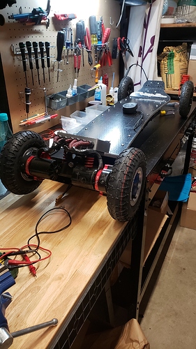

First time charging this battery
Love being able to just see this

I think you might still be the first lol! I got impatient with trampa because they did not have the bigboi in stock and asked then to send me a 17ply holypro :call_me_hand: which is what this is
So far really happy with it. Havnt riden yet but about to. Flex seems perfect at standstill.
Sorry to be the bearer of bad news, but that’s not a holypro mate, that’s an HS11 short nose (or possibly Bigboi long nose? Check the width and length of the deck and I’ll compare it to mine).
Holypro has holes in it!
Double check your invoice sheet mate, it looks like either you or Trampa have made a mistake :confused:
36×9 looks like hs11. I think I made the mistake. But no this was the board I wanted instead of the bigboi. Kinda glad I got this, after riding it I feel the big boi might have been a bit too long
Ok here is what’s up, first ride, went really well, overall very happy! First few concerns, APS motors have a very shallow key, atleast these ones do, standard key does not fit, going to retighten loose spur gear this time with 380 loctite. Next
Replacing red springs with barrels
And swapping orange for red mbs blocks
Should feel more stable…and stable is very important
Although I did not actually do 60mph on it the set up is 1:4 gear ratio on 9" tires…probbaly capable of propelling me over 50mph the metr data that shows that high speed was a no load pull test. Very exited about this build!

Is there an easy way to replace trampa springs? Or do I ah e to take the truck off?
I don’t know how you’d remove the springs w/o removing the center pin/hanger unless you have a tiny spring compressor, lol.
you need one of these. make sure you put something between the deck+bottom of the truck or its gonna mark it badly.
