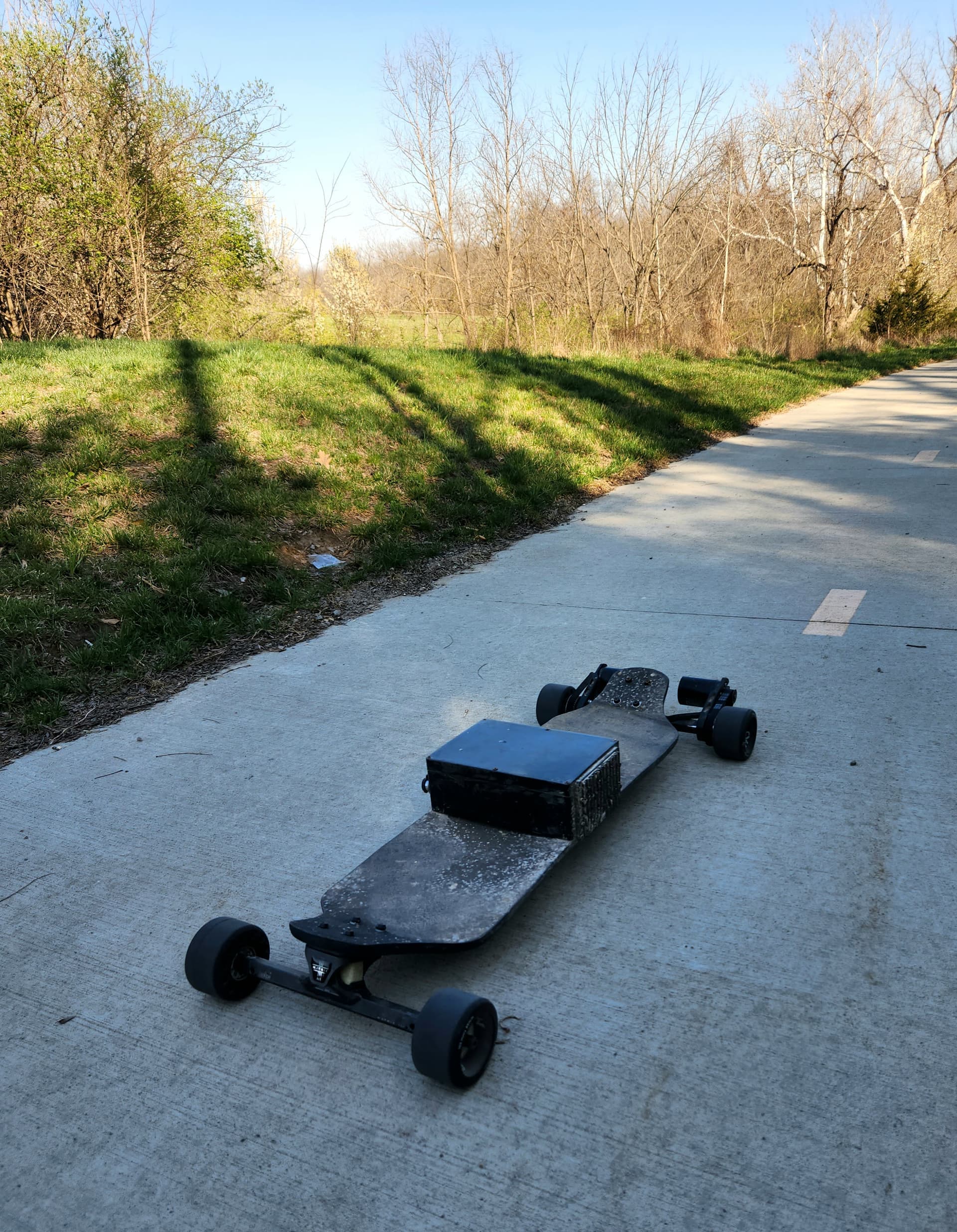

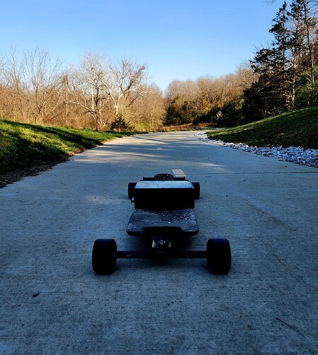

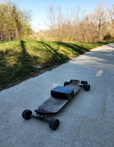

Just installed an A/C setup on the board. Initial impressions are interesting after a ride, but I’m not sure how much Brad wants me to share in public while they’re in testing
I think I would like to compile results from several points of reference privately as we are guessing the appropriate duro and if need be, we will send out harder or softer sets to suit until we can more accurately predict the response of different setups. I have only tested on an unpowered board so the dynamics are different.
Are the baseplate bushings guards supposed to be in the inner position?
Also the little green bushings just blew my mind.
This is so different than I had envisioned…
I pictured two of the regular bushings melded together…
I would at least like to see what your board set up is and what they look like in there.
Install seems super straightforward… So I’m guessing you didn’t have any issues?
Also what stock bushing set up did you have before the experiment?
