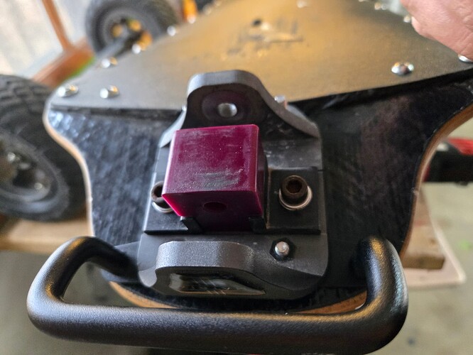

The Singularity™ bushing design for Channel trucks.
Board is 320mm matrix 3s on a LaCroix Lonestar deck.
Original setup was whites outer position all around.
The bushings are small. You can’t really see them installed in there.
Install was as easy as stock bushings

For those testing.
Add loctite to your bushings holder thingies.
I moved to a Socket Headed Cap Screw on mine:
Do you happen to know the thread size?

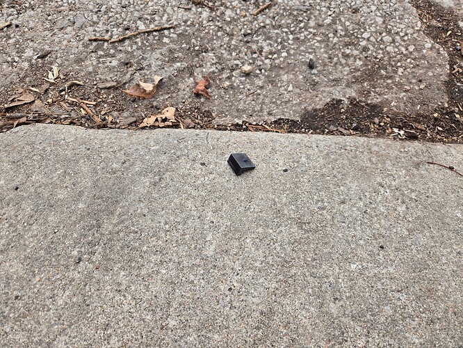

I dropped a little plate again…
Apparently my tiny screw is not engaging…
And … We are back on.
