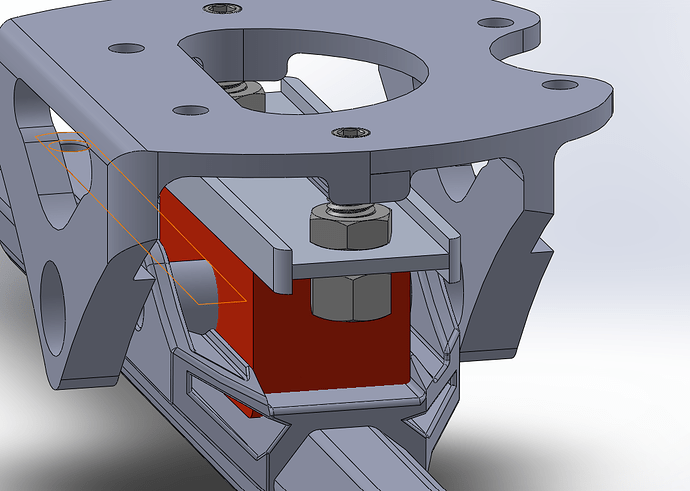

The Singularity™ bushing design for Channel trucks.
So now the face on the inside of the hanger becomes one big bushing seat.
Is this bushing seat in line with the pivot axis?
With that much surface area on the seat, does the bushing need to drag itself around on that face in order to conform with the rotation of the hanger?
I imagine this configuration has a very solid center, but I’m having a harder time imagining it being able to allow for deep leans even with 60a. Am I underestimating how squishy this can get?
We can always make the bushing narrower to gain more lean if necessary, plus we could also tune with different diameter holes molded in which could also be modified for people who have a weak side turn.

Not sure is weight is a penalty but each Singularity in it’s current configuration is 48 grams so a total of less than 100 grams per board.
Well more weight almost never helps, but it’s interesting that it’s actually slightly lighter than shockblocks! I measured the medium orange ones at 25g each, so at 100g total it’s nearly identical. Maybe it’s the metal plate on them or something that adds weight.

Our Rev-A is working well but Rev-B is on the near horizon. We have learned a lot and pressing forward in pursuit of perfection.
You guys looking for more testers?
Once we have the design we think we will go to production with, I will be sending out to select testers.
Here is a peak at Rev-B at under 40 grams
