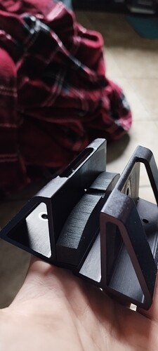

This is what I’ve ended up with recently that’s been working well:
Its actually incredible that ninjaflex TPU has enough rebound to make this work.
Making it as simple as just a big block of urethane, while also keeping all of the truck articulation, is sort of the dream.
That reminds me of the time I printed HTD5 belts in TPU to check which tooth count I’d need. The belts themselves technically drove my board, but would stretch too much and skip at anything over very light throttle. Tried putting them on a scale and hanging off of them (160 lbs dry) and they stretched but wouldn’t break.
Why not have tension cards built in as a “wear surface” either side of the hanger?
You mean like, using the shims as resistance?
Urethane shims.
That’s an idea. They’d be thin enough to stretch for the whole range of motion.
But the hanger wouldn’t be as well captured at the extremes of the deck tip.
Its taking both components that wear and need to be replaced, and combining them into one part.
And it would be a great way to ensure that they do get replaced when they need it, so people aren’t riding janky trucks that aren’t working right.
I’ll give that a go.
Would be cool to see it work if the idea is worth it. Worst-case you add some higher density slider material in there for the shims if it binds too much or wants to start wobbling off-axis due to the compressibility of urethane
