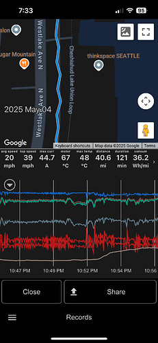

Anecdotally, I can’t seem to exceed the envelope of stability on either so far. Last night i did a 47 mile ride on the singularities, 25 miles being on a group ride through some rough and some twisty roads. Seattle seems to import small sections of the moon to pave the side streets idk. I was able to comfortably keep up and carve around 30-35mph.
I’ve definitely settled on my ideal setup for the singularities. Front: b93a 30 degrees. Rear b93a 20 degrees. I out turn and corner everything and have to check my speed to make sure im not losing other eskates or leading them into turns or terrain they can’t handle. On my home path i hit a long fresh curvy asphalt road (greenlake way) and get up to max speed often. Stable and carvey.
My max speed for the Bog Roosh is only just 42 at full battery but i hit max duty cycle a bit more often than i like now. I didn’t think these trucks would ever be stable enough to maintain that speed but now im starting to flirt with the idea of upping my motor kv a step.
My duality build is on 170ish kv so tops out at 47mph loaded and i haven’t maxed it out. Im going to take it for a spin this week to get some fresh eyes on the comparison while i put the bogRoosh on the work bench and swap in the final riser/wedge design and either fix the sensors or tune the hfi better if they’re dead.
