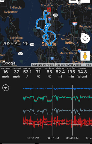

Got a nice little ride in, it is so weird to be able to just carve like a crazy person throwing your weight at low speed, then punch it to 25-30 and feel like a dart, and start carving again at 30 like it’s 10mph. There is some magic in these - cant wipe this stupid grin off my face

60ish miles on the (edit - is actually 30/20 final angles) 25/15 degree b/b 93a and wow. Feeling so good at 30 and under but i think a bit too soft and responsive to get any deep carving in the 30s. I think ive got the ankle strength and control to swing the high 30s but its an a game play. switching to 90a c rear but the rest the same today to soak up some more of this early season weather.

Ok, didn’t put as many miles on the b93/c90 setup as i thought i would, about 30miles. Before i swapped in the c90/c90 for a shorter run and went back to the b93/b93. Rain started last night at midnight so cut my ride short and no morning ride today… and that’s when i get on esn, otherwise i have to clean my work benches :laughing:
With no binding and the asym setup the return to center and the force to break into a curve/carve i was steering from the rear. My back foot was doing all the work and without more leverage it was less fun. Absolutely rock solid stability and still had most of the turn radius. Went through some of the Seattle streets they imported from the moon ( cobbles with failed asphalt and busted up sectional concrete with big kutchunk energy) and it did really well. Still loose enough to hit big nasty holes and bounce back under you.
Just in general these keep the board under you so well. Day and night from the original bushings. Even if im running the c/c setup (biggest return to center) or the softer b/b setup there is just a better feeling to the way the board reacts to large sudden bonks and diagonal or parallel lips.
I didn’t carve on my original matrix 3 bushings on concrete roads before because you can get a train track effect from hitting the transition/expansion joints and it can pull the board out from under you and you have a bad day. The confidence of the b/b setup has me experimenting on these streets and i can definitely feel when i hit the joints as im pushing into a carve. Definitely some of the big 1-2” drops and rises try to get ya but the trucks are so compliant and responsive and predictable it’s not a high stress incident.
TLDR b93/b93 is my jam. Took brads advice and put a little more preload in the rear on the b/b setup more intentionally and it’s hard to get off the board. Turning circles around apex airs and the Lorentz major and still solid jumping up to the high 30s to catch up from sweeping and blocking on group rides. 10/10 singularity evangelist.
