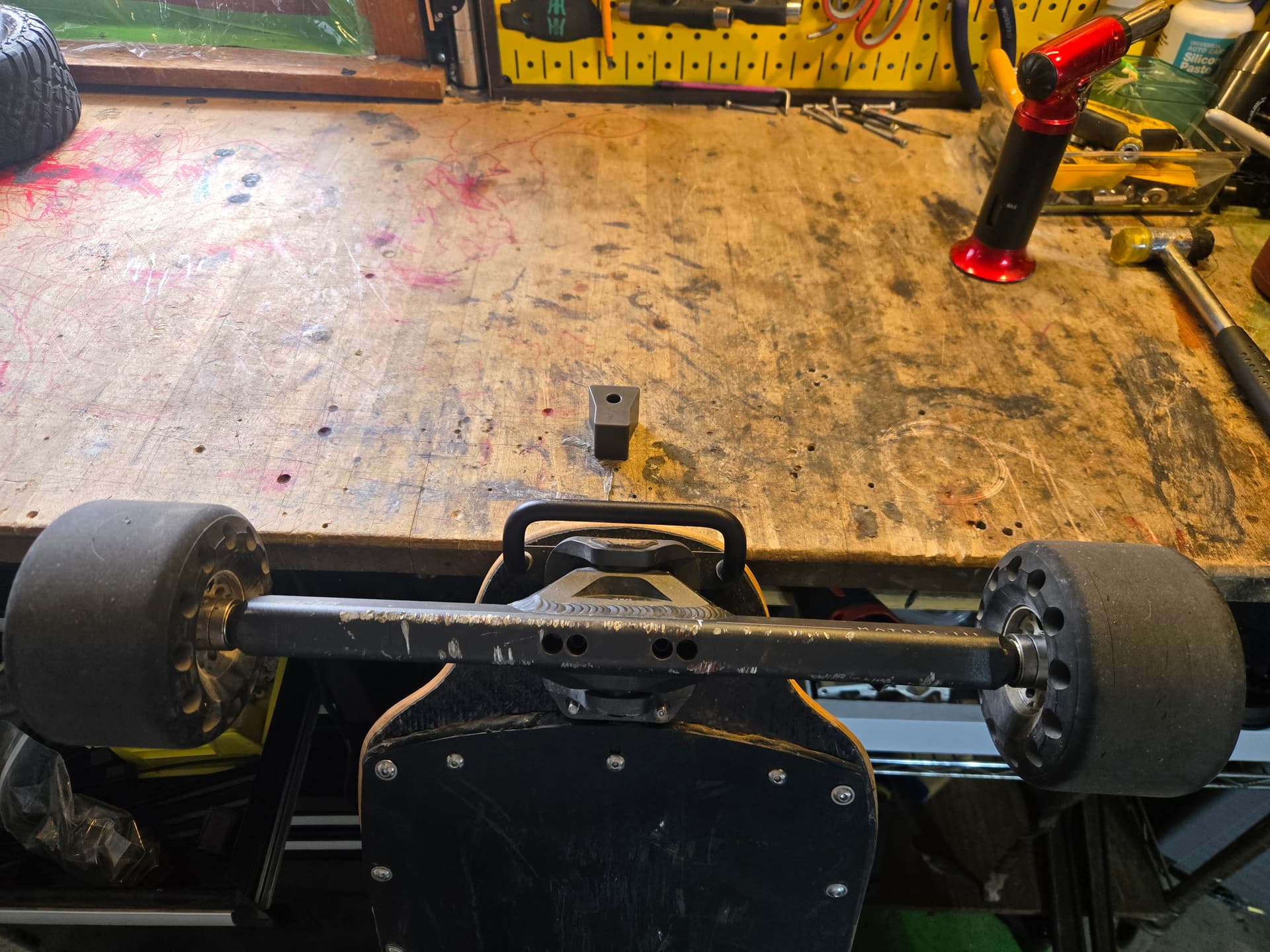

Anyone making 5 to 10 degree angled risers for the Matrix III? I am willing to trade a Singularity kit of your duro choice for 4 of the angled risers.
We have a 15 degree riser I can send you if you can make that work.
Those would be perfect! My address should be on file with you guys! I only need one pair.
Awesome. We’ll get a pair out to you.
