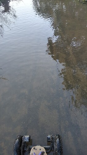

What about using them for off road, from the sound of it they might be good for off road usage where you need the trucks to move alot with little effort.
@MichaelWA I got around in the woods better with these than anything ever before.
And I’m on a giant LaCroix Deck with no bindings.
The turning and super lean really shine in the woods.
Focus on the battery box to see how much the deck leans with these.

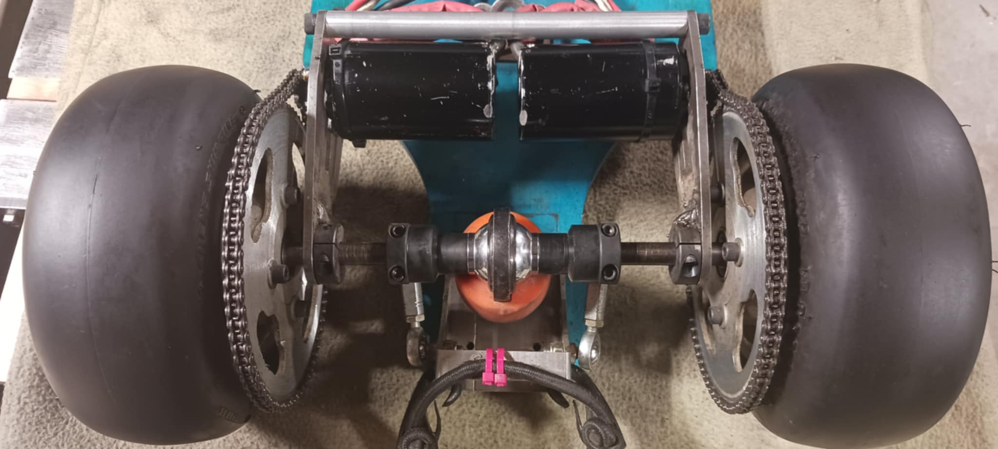

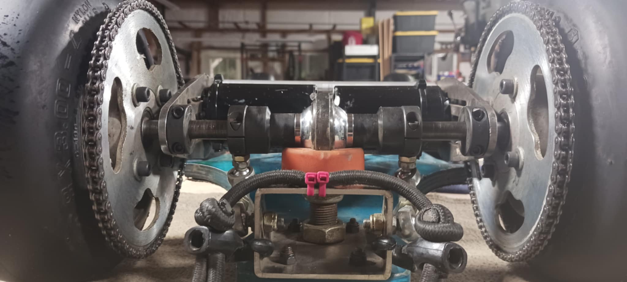

An early version of the Singularity that I just added a #25 chain drive to with a 8.9 ratio.
Can we see the whole board?
