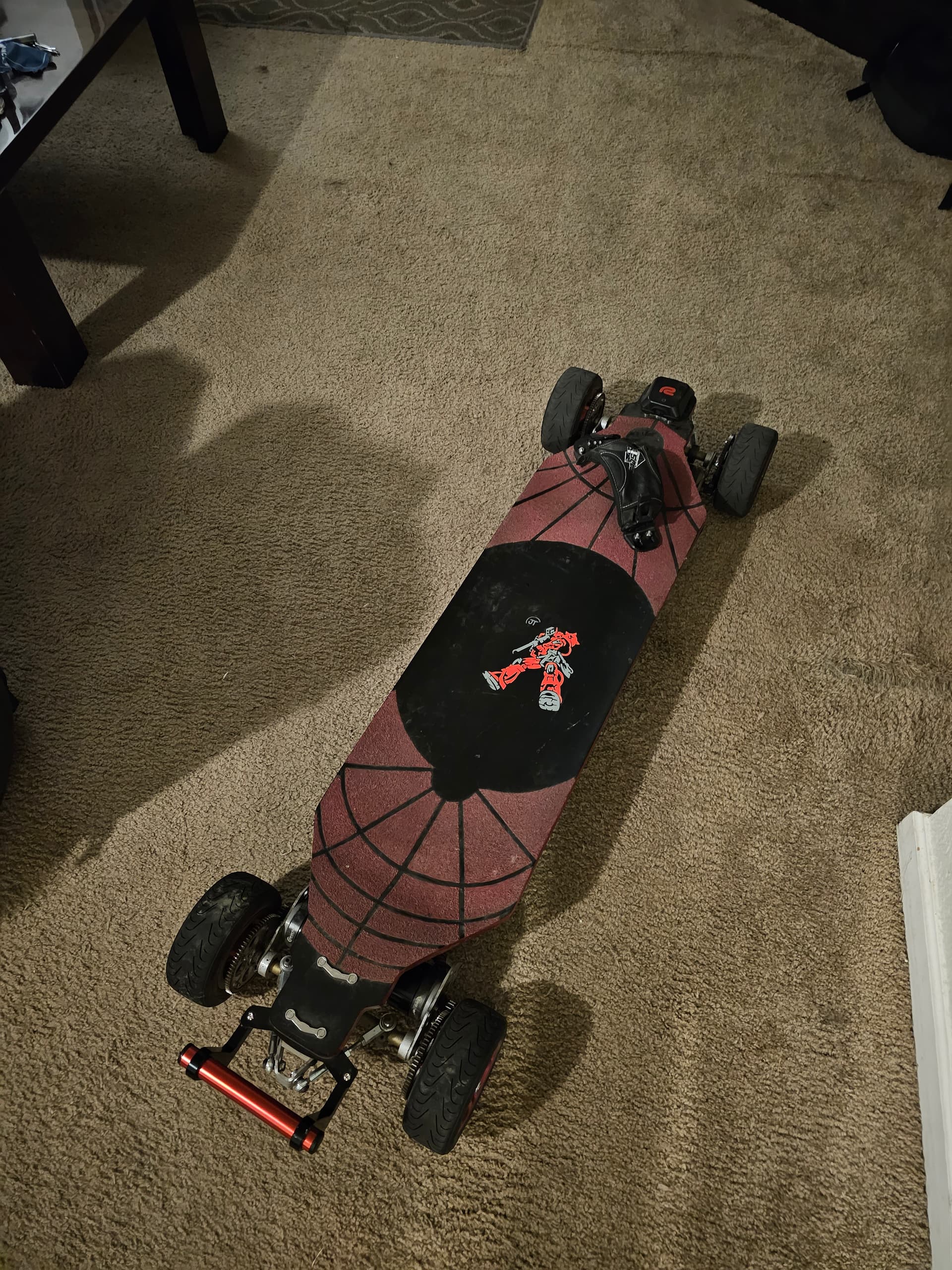

Thanks for the board.
Wait this isn’t the drop off cleaning service lol
