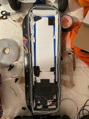

Did final preparations this evening before handing the board off. Here you can see the inside layout:
Phase wires do a loop, their bullets are held together with fiberglass tape.
Behind the ESC on the left we have the charge-port fuse holder wrapped in foam for silence, and on the right we have the mini remote receiver.
On the side of the ESC I also have the Robogotchi stuck in place.
All connectors (sensor cables, power button, robogotchi and remote) are secured to the ESC using hot melt glue. I find it to be the best to keep connectors in place, but with the possibility to pick and pry at it to get it off when you need to unplug things eventually.
Here’s a shot of all bolts put in (quite short, only 12mm flat-heads!) and a baggie with some spare bolts (slightly longer, in case the butyl tape adds too much thickness). You can see how wide the enclosure lip is! – I wish Eboosted did that. (But you can also see that the enclosure could have easily been made wider :fist: )
Finally, the back truck bolts had come loose, so I added blue threadlocker to all 8 and tightened it well down. Some final glory shots:

Final enclosure layout was such:

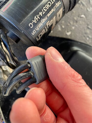

The second issue encountered - one of the motors spazzing out :scream:
This would happen very randomly, and was nearly impossible to make out looking at logs. We opened up the gear drives, opened up the enclosure to check for unplugged phase wires, no luck. Switching ESC sides always had the issue lead back to the same motor. We had managed to pinpoint that the issue was likely a phase wire short, but the question was - where?
Well, after a few months, we finally found it – I had done a subpar job soldering the MR60 connectors, and over time stress on the wires caused the wires to fray and make small shorts :open_mouth: :disappointed:
After consulting with fellow community members, I got instructions on how to solder MR60s with ease and with perfection. It boils down to stripping the 12Awg wire and losing a few strands for an even smaller cross section, tinning the wire to eliminate any stray wires, tinning the cups of the connector itself, and then using a thick soldering iron tip to heat up both so that the wire can be carefully seated in the cup. You also need the male MR30 connected to the female for additional thermal transfer away from the plastic of the connector, to prevent it melting. You also need the stripped section of the wire to be exactly the right length to get a good solder connection, and not have any exposed wires, because there’s no room for heat-shrink with these.
Since the outside wires connected straight to bullets for modularity, I was able to solder up a new set of adapters and mail them off to my friend for replacement. Somehow I can’t find a picture, but they were absolutely perfect :100:

After replacing the connectors one of the motors would sometimes spin in the wrong direction, or refuse to move at all. I had a pretty good idea that this is due to a sensor issue, and when my friend opened up the board, sure enough, he had put too much pressure on the sensor wires and they had broken off the glued-in JST connectors:
Also we noticed that one of the phase wires internally had almost unplugged. This is crazy, because they connect to epoxied MR60 connectors in the enclosure wall. I guess it goes to show, vibrations will make anything come loose. Use adhesive lined heat-shrink, folks!
After my friend fixed the sensor wires, the motor would still behave weird. Doing motor detection didn’t detect the hall sensors, so most likely the sensors inside the motor had died (despite my conformal coating layer), and now the motor was being run in sensorless mode, which sucks.
