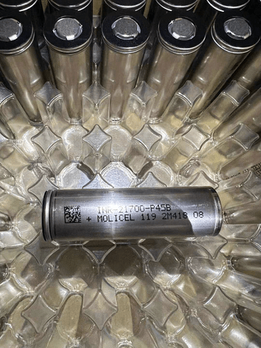

does this looks legit to you?
Sorry, there’s no way I can determine authenticity from a photo and anyone who says they can is just guessing.
AFAIK there are no P45B’s available for sale yet but there’s always a chance someone sold samples they received.
There was no printing on the metal can for the samples I tested and all the cans had a laser-etched code on them. They might have changed things since I tested and they might have not.
If the top insulated ring is self-adhesive that was not done by Moli and that is not a standard Moli 100-cell box (which has always been paperboard/cardboard).
Do you have a capacity tester?
I don’t have them yet.
I have a cell charger, I guess I can full cycle one of them to get a capacity value
Check that the charger goes down to 2.5V when it measures capacity. Many stop at a higher voltage.
