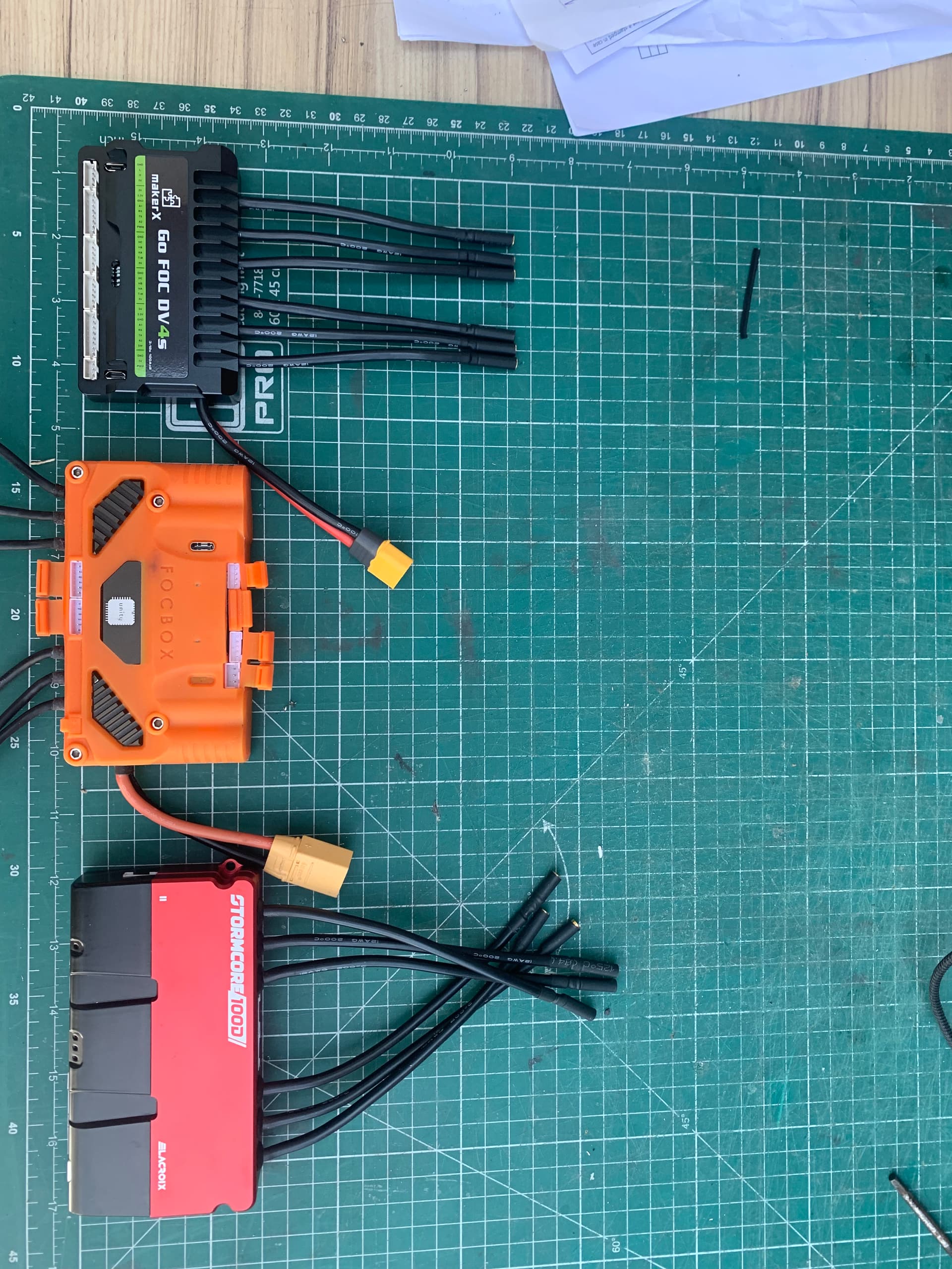

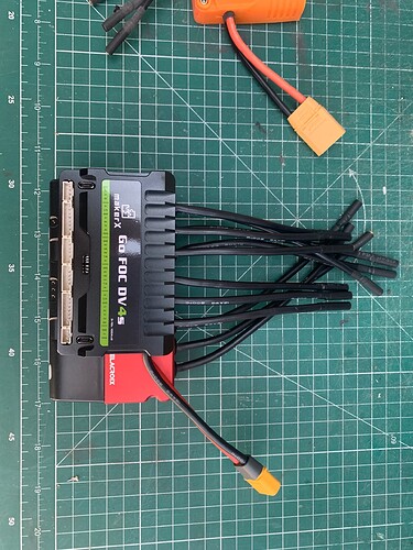

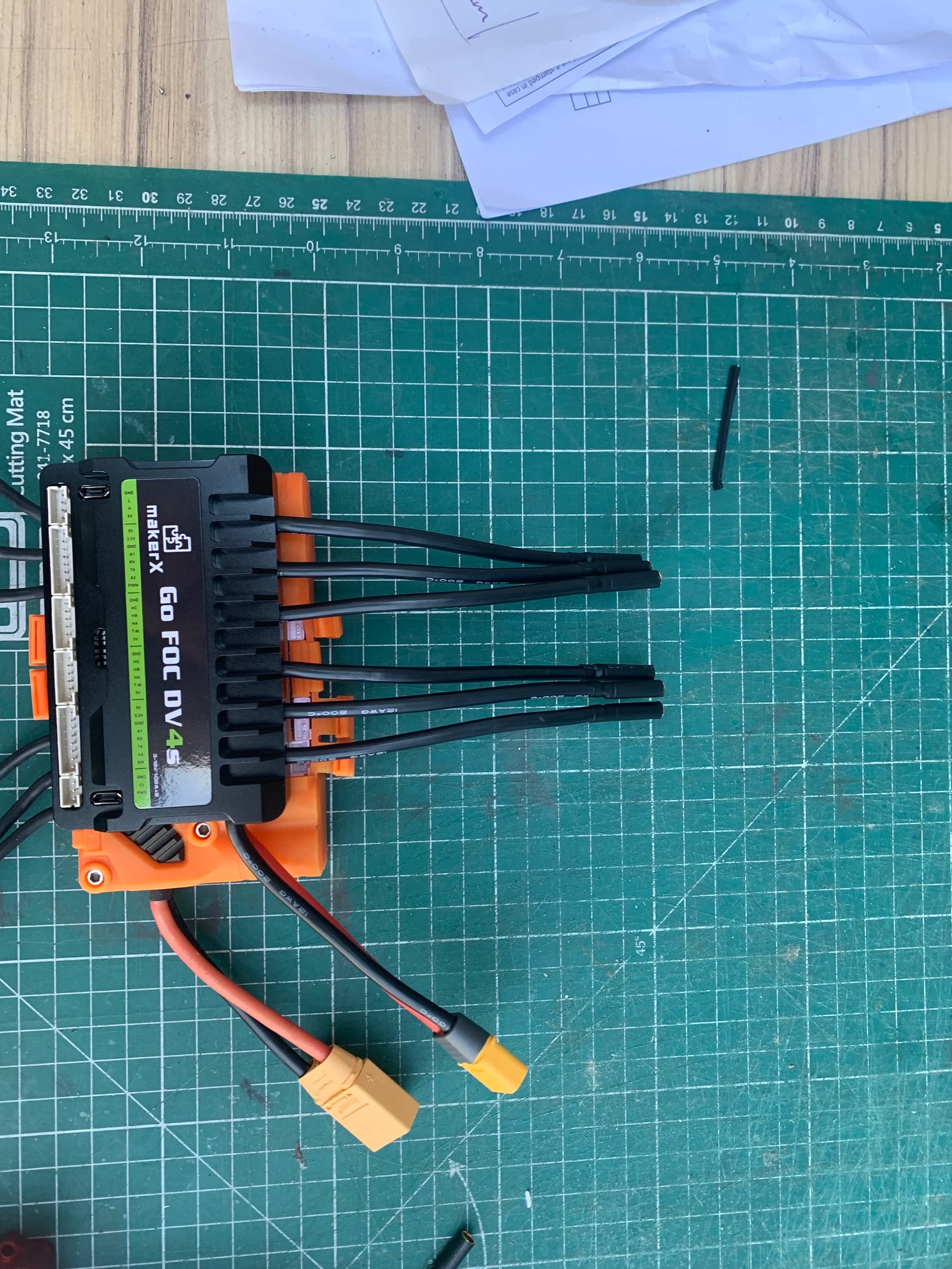

So small, and really nice looking solder joints on those phase wires!
It is so smol.
