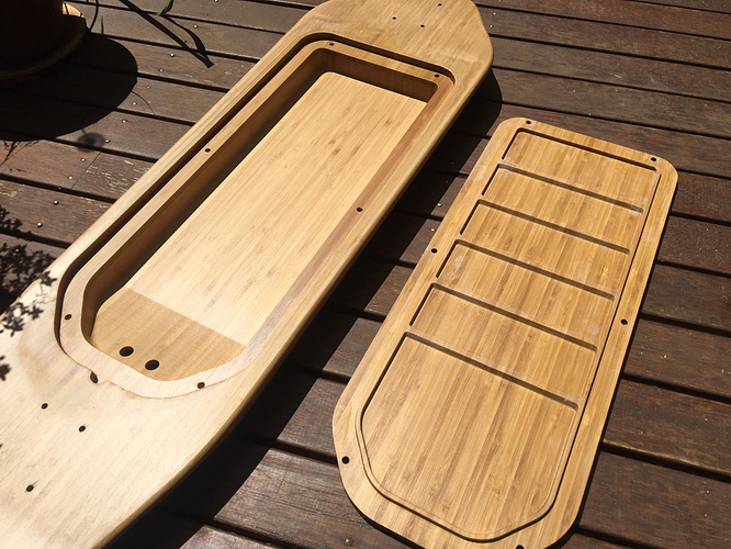

The Deck
In mid October Jeff told me that my deck had finished being CNC’d and was nearly ready for shipping, but because of the cracking/delamination issues experienced by a couple of people he would be producing a new deck of the modified and improved design, which would take a few more weeks to produce and get to me, around this time the group buy was ran on the forum, so I was able to see progress by that. I am very happy with the way Jeff handled this whole situation, I absolutely did not expect for him to just dump the potentially faulty deck and produce me a brand new one, for no extra charge, this solidified my view of him as a great member of the community, something that I’m sure everyone here can agree with me on.
I get an email from Jeff for address confirmation for shipping and was elated, about a week later I got a message from AusPost saying I had a package waiting for me at the local post office, not realizing what it was, I rode there, this was a mistake…
Getting it home was a fun time /s but I made it, and just about ripped into the box to see how it was, the deck was everything I ever wanted and was absolutely prime craftsmanship by Jeff and his team.
