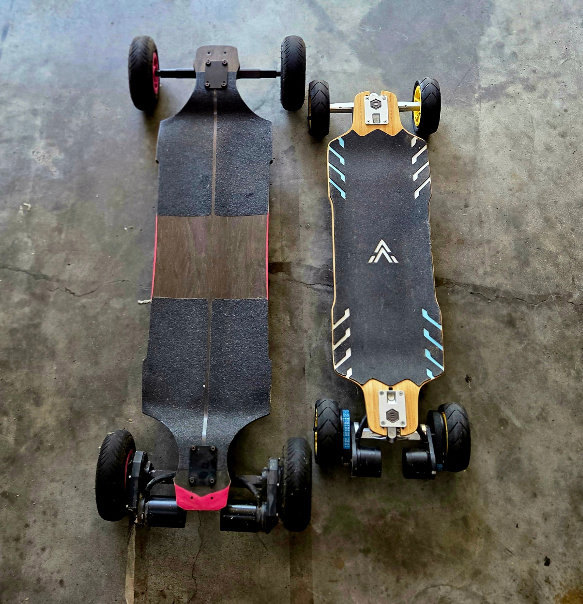

Long story short, Hash got confiscated by the cops about 2 years ago because boards are illegal, but i want my mini AT to live on.
I’ll update this thread once i figure out what parts to go with it, some parts have been obtained and some are in the midst of, could use all of your help to decide how to put this build together.

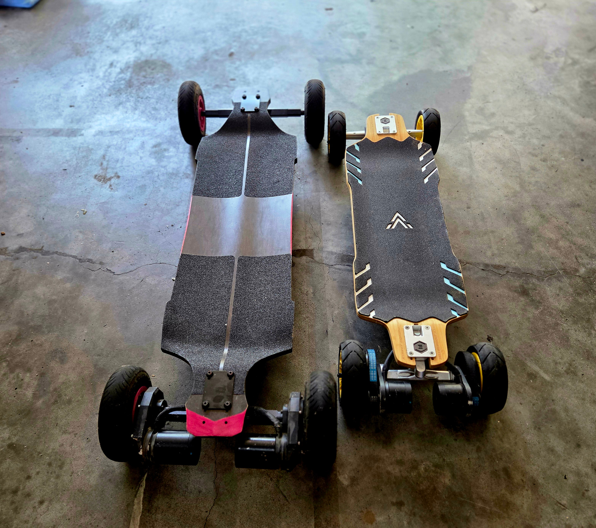

I made a little DKP pneumatics board for Luca.
It’s tiny.
Evolve trucks and wheels. 6 inch Hotas.
acedeck Breeze deck.
It’s tiny…
It kinda rips!!!

This is what I got for now.

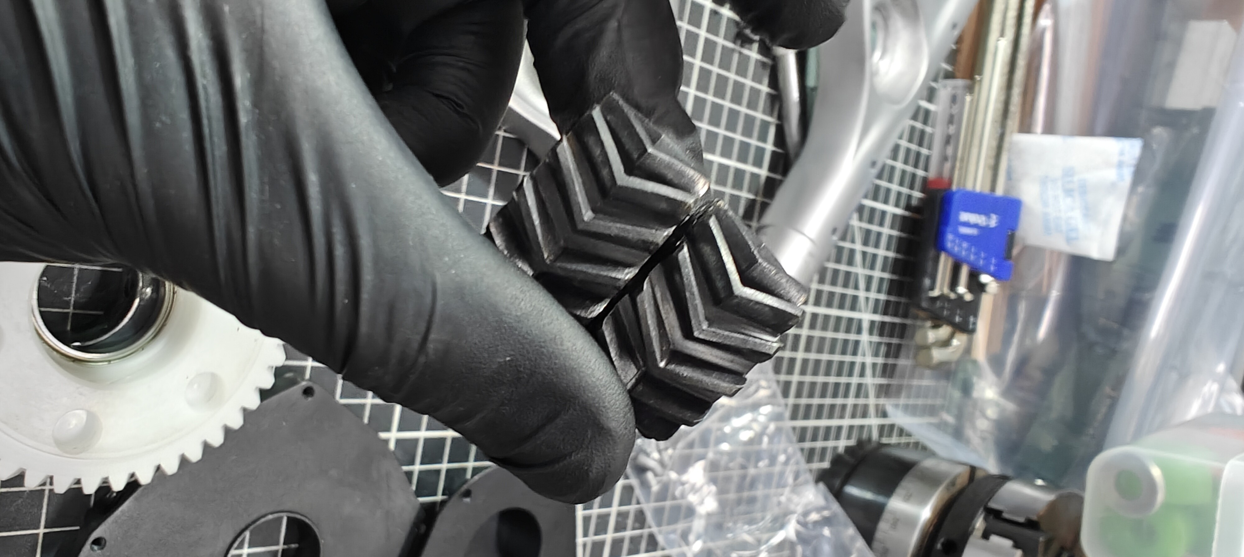

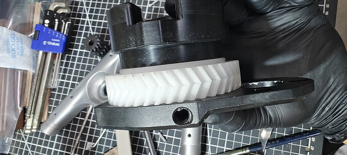

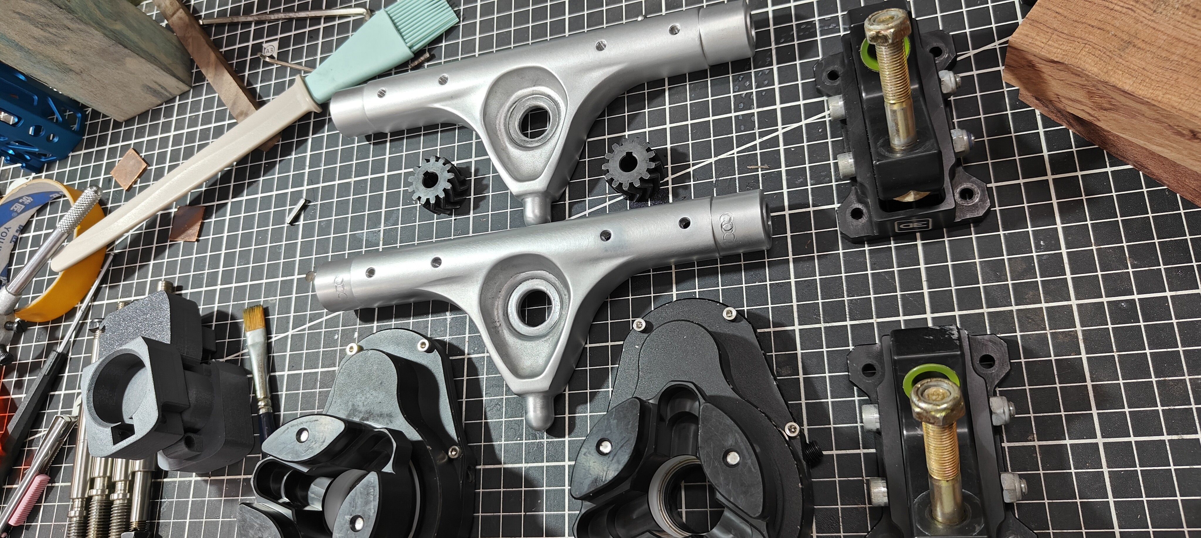

@Dnollie was selling an Avio herringbone drivetrain set which is the exact drivetrain I used last time. Only difference is that it’s using maytech 6374s and forged haggy Kahuas. It arrived a couple days ago so I cleaned it up. Condition looks good.
Besides this, I also got a set of Luna trucks with BN belt motor mounts.

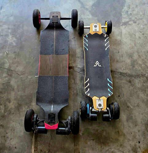

When that arrives I’ll decide which drivetrain would be best. But so far my requirements are to have it relatively lightweight so around 10 to 11 kilos.
@BillGordon has a trampa Urban carver deck and enclosure set, which I might snag. I plan to get a pair of 6355 reacher motors.
That’s about it for now, I’ll update when more stuff show up

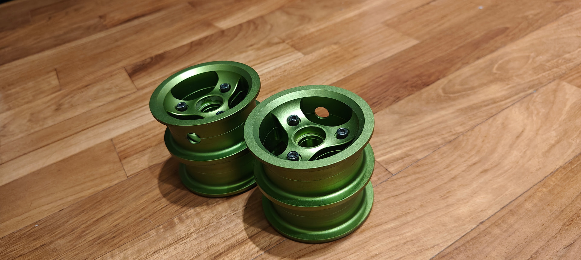

If I do go with this drivetrain, I’ll pair it with the bergs. The green on this is a bit on the lighter side, so I might re-anodize the hangars and the hubs for an even green.
I also realized that I might not be able to use the 3dservisas baseplate if I do the trampa deck, the baseplate does not adjust that low of a degree so I might have to get a different adjustable baseplate

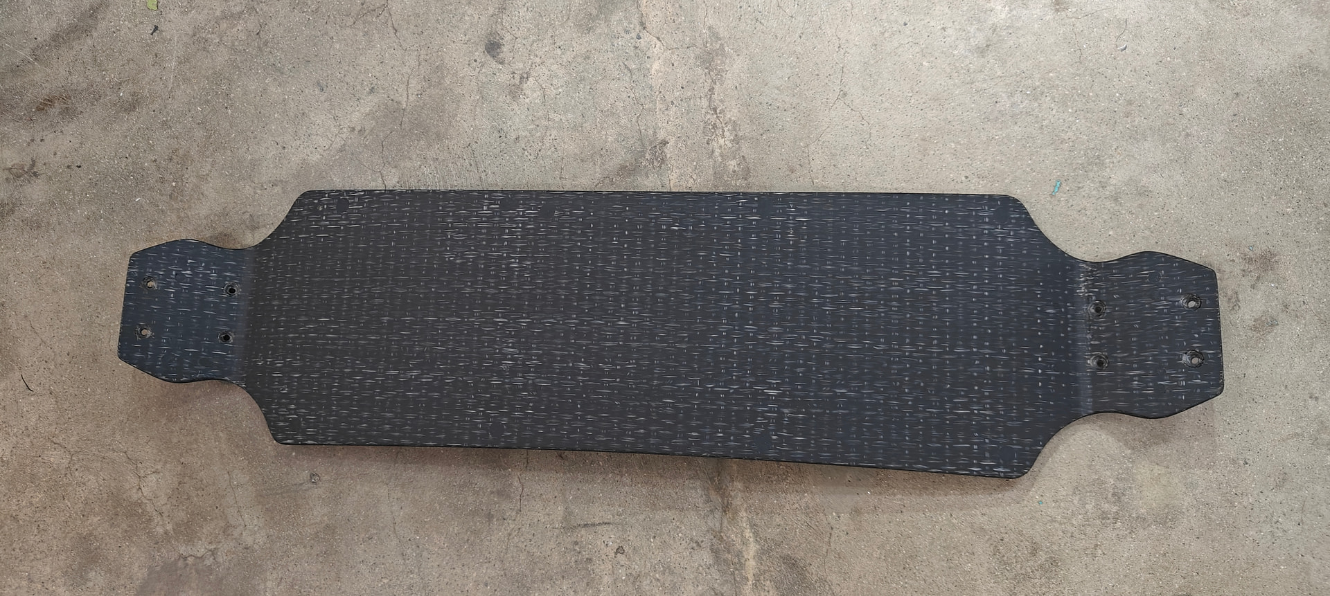

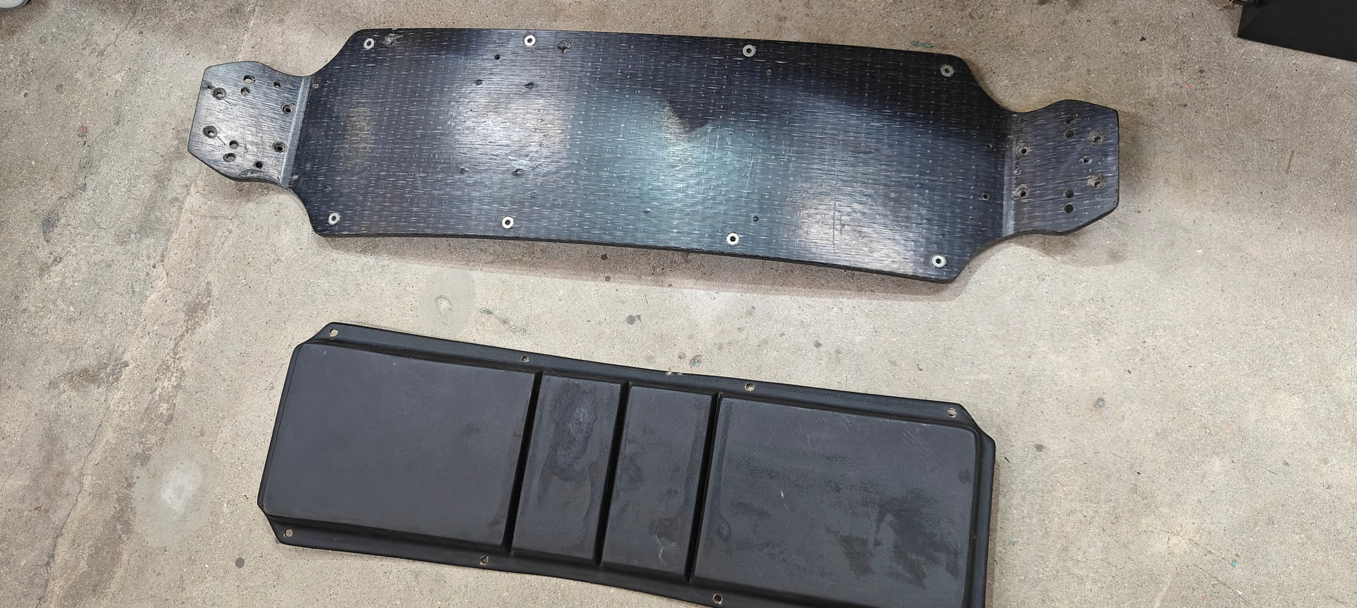

Got the deck and enclosure. This is the trampa Urban carver deck with the Eboardsperu enclosure if I remember right.
It’s not brand new, so there’s some work to be done.

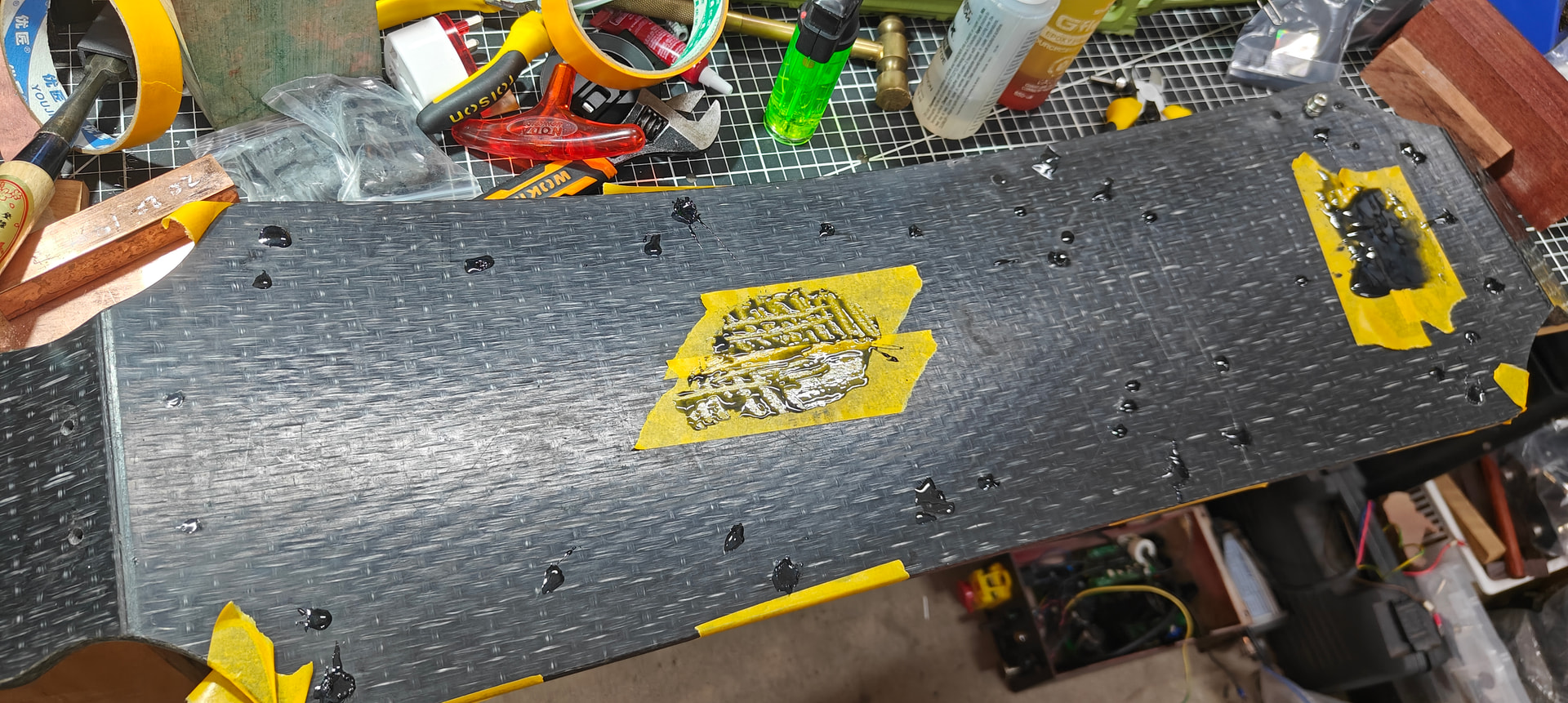

I removed the old inserts because a few were slanted. Luckily it wasn’t glued on so with a bolt and nut on one end I was able to careful untwist them out.
The deck has a lot of holes, so I cleaned all holes, sanded slightly and filled it with west systems G flex epoxy. It’s used for knife making and allows for a bit of flex, which I think will work well for a flex deck like this.

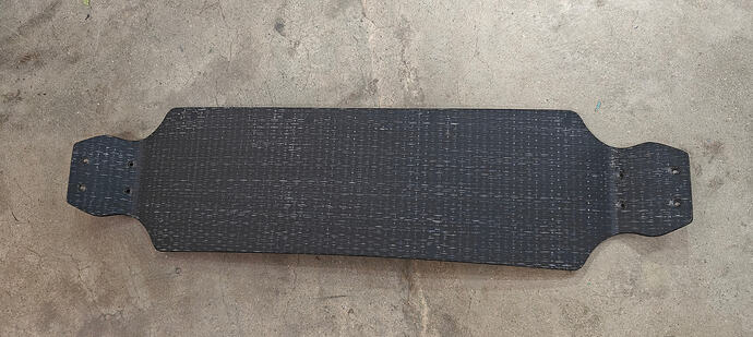

Deck is sanded smooth and sprayed with a coat of matte clear coat. Not sure if I’m doing green on the deck yet, we’ll see.
