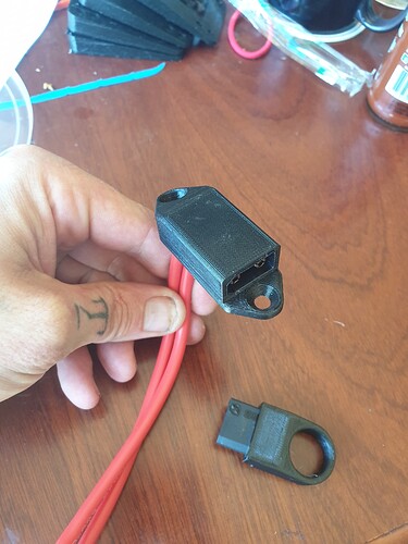

I like to mock everything up before I properly assemble so I can figure out how I want to run wiring and whether or not I need to modify or design any components to make assembly easier/neater.
For this one I decided that I definitely wanted a sturdy clip to route the motor wires through, a loop key, and a cable flange…
Designing and printing went well. The cable guide was originally going to be a little more elaborate, but it proved too hard. I won’t bother going into the successes and failures I had, but overall the initial idea was a failure that I learned good lessons from :sweat_smile:
The loop key was designed to be as slim line as possible. Everybody seems to hate loop keys sticking out, so I came up with this design to keep potential damage to a minimum and also to stop it looking like a weird thing just jutting out of the enclosure :rofl: it works well, i like it.
The cable flange worked pretty well, printed with TPU and everything is a nice snug fit.
