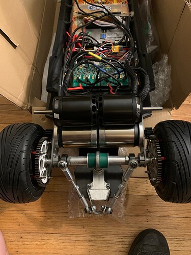

I visited the @Skyart workshop while driving back from Canada. @poastoast finished off the battery last week, and the man himself put the finishing touches on the electronics while I perused the shop for extra parts.
Welcome to my makeshift workshop
Lil foccers for a lot of voltage and amps.
Hand filing the enclosure for phase openings.
Fitting the gasket
3 link setup.
I polished some flipskys. These are going up for sale actually.
Meepo tubeless on newbee pentagrams. Fit is perfect.
Fit check on motor upgrades
a zoomy boi’
First ride. Zoom zoom
