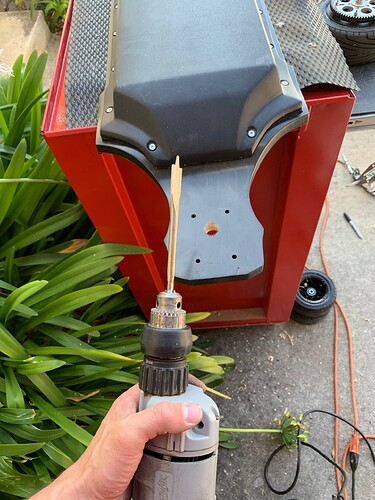

Another build update. I got everything put together and honestly was pretty disappointed with how high the ride height was. Luckily, with 3-links I can do something about that.
Look at the ride height here - ewwww
All the parts coming off the board that I just put together a day before…
3 link dissassembly
Drilling out the redember deck
Fit is good
Still has good clearance
Plenty of clearance at full lean
I also shaved some unneeded material off the motor mount plates, so that I can get them closer to the deck, giving me more ground clearance, and lean before things bump together.
