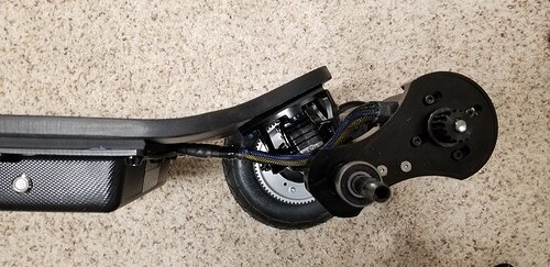

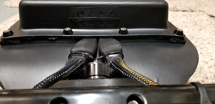

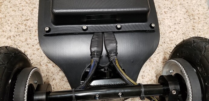

I was wondering if you could help me with running the phase wires through the enclosure. I had to drill out the holes for the 5.5mm bullet connectors and now the included wire grommets won’t stay in the enlarged holes. I was stumped as I can’t for the life of me find the same kind of rubber grommets that were included but a bit larger. Then I came across your thread. Could you please share more details/ pictures on how you ran the wires through the bottom gasket?
Hey man! Yeah, don’t worry about over sizing those holes. They aren’t useful anyway. I covered mine with electrical tape, then filled the backside of the holes with hot glue.
I can’t take any credit for how I routed the phase wires. @rafaelinmissouri’s technique was my inspiration. We both needed to use a thick gasket that doesn’t easily crush (unlike the one provided), so we cut a gap in the enclosure gasket and simply ran it through the gap. Make sure to insulate your phase wires at the transition.
Here are some pictures from when I was still on belts:
999e5462ea7738eca20beccfb7080690659c2ee5_2_690x335
eeccfff6dc048328eecde103903ffbf6d6aa4ded_2_690x335
0bf4380897d934d881c507362e39face2576e54a_2_243x500
Let me know if I can help with anything else.
