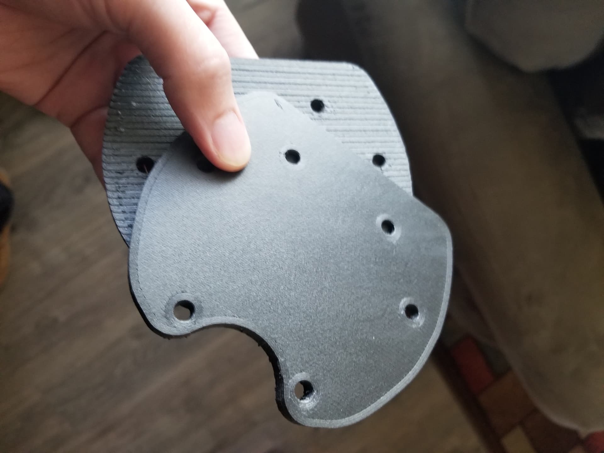

Thanks @dskate for the 3d printed angled risers!

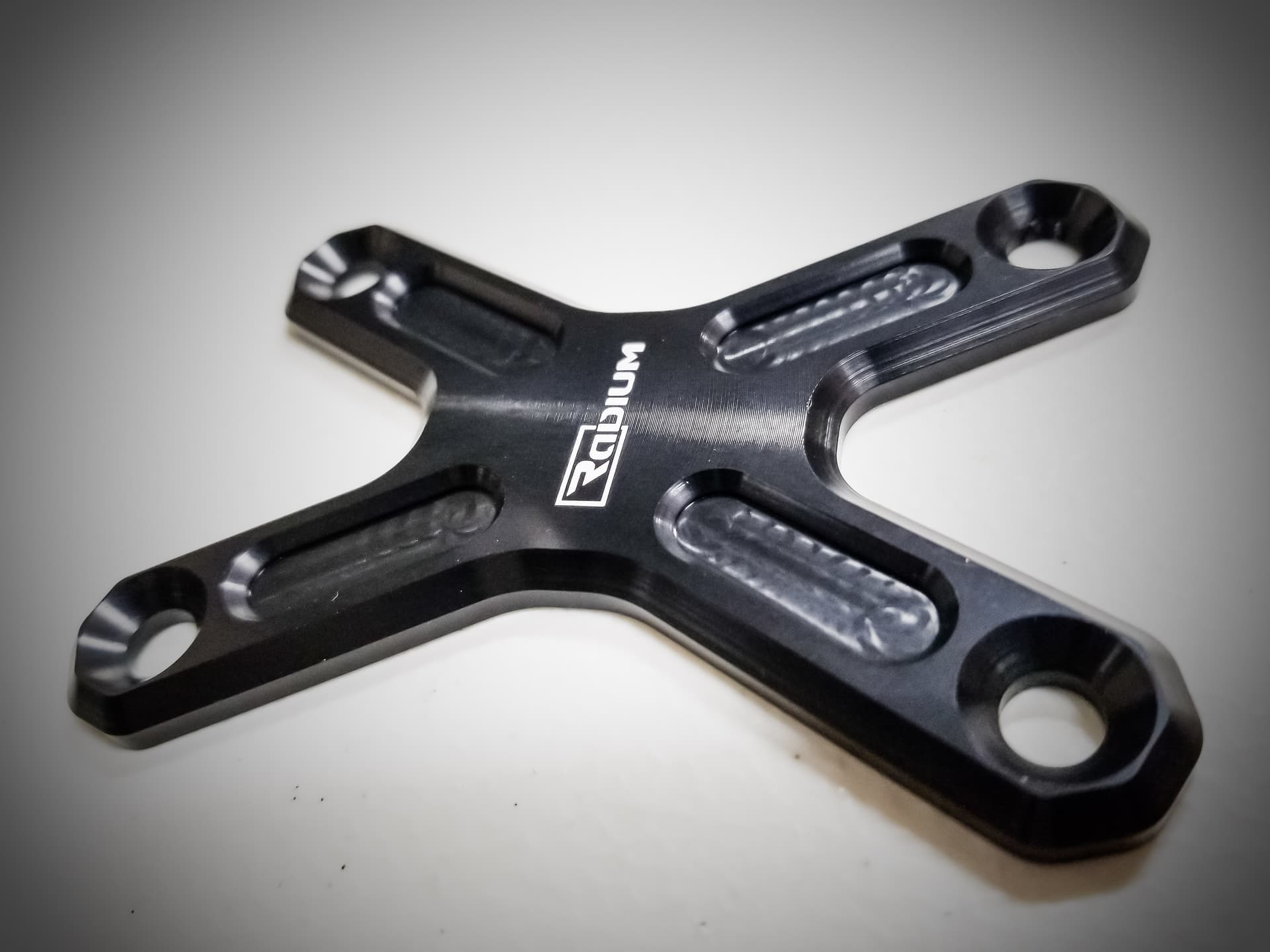

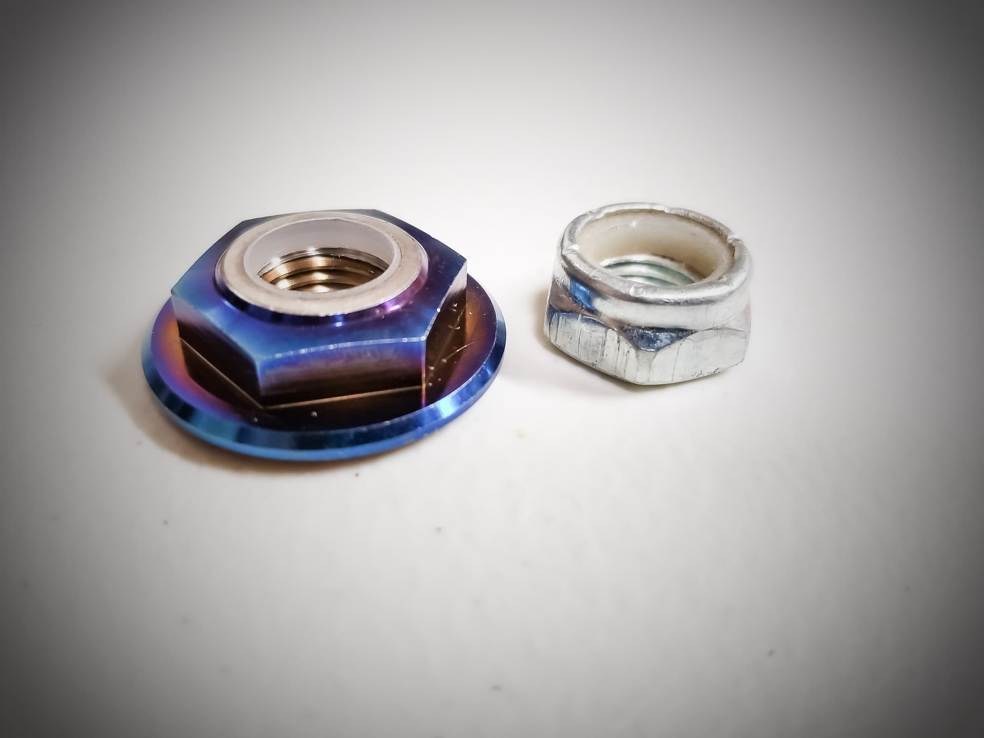

Gotta love some tasty bits from @Tony_Stark at Radium. This includes some Riptide adapter plates, antisink plates and some mega large axle locknuts.
One of these things is not like the other…

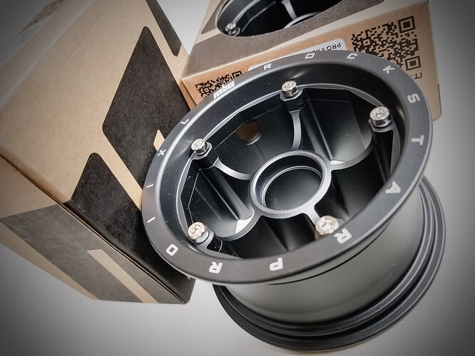

And WOW! So impressed with the workmanship on these new XL hubs from @MBS:

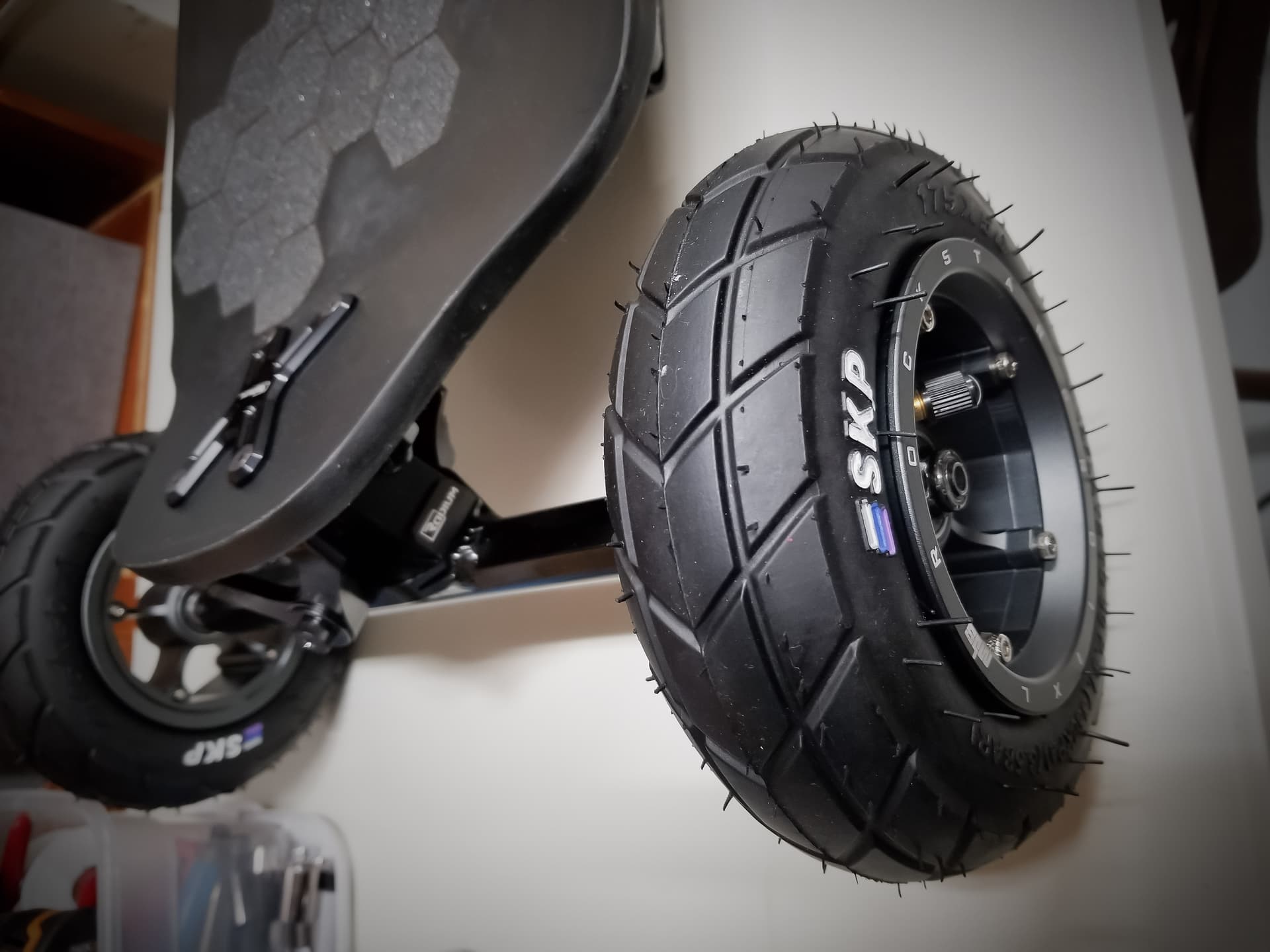

Really excited to try out these 175mm rubbers from @Skyart. I’ve heard really good things about how well they are balanced right out of the box. They should have comparable wear life to the Kenda 909s I’ve been running for 2 years, and I should get a little torque boost from downsizing the tires from 200mm.

Pretty sure you’ll love the SKP tires. After having bad luck with a set of Kenda K909s I switched to 7” tires and tried some from Evolve. They were actually really good, but I couldn’t resist trying the SKPs. They are even better. Easy to balance, smooth rolling, and grippy. Looking forward to seeing yours stretched on those new hubs.

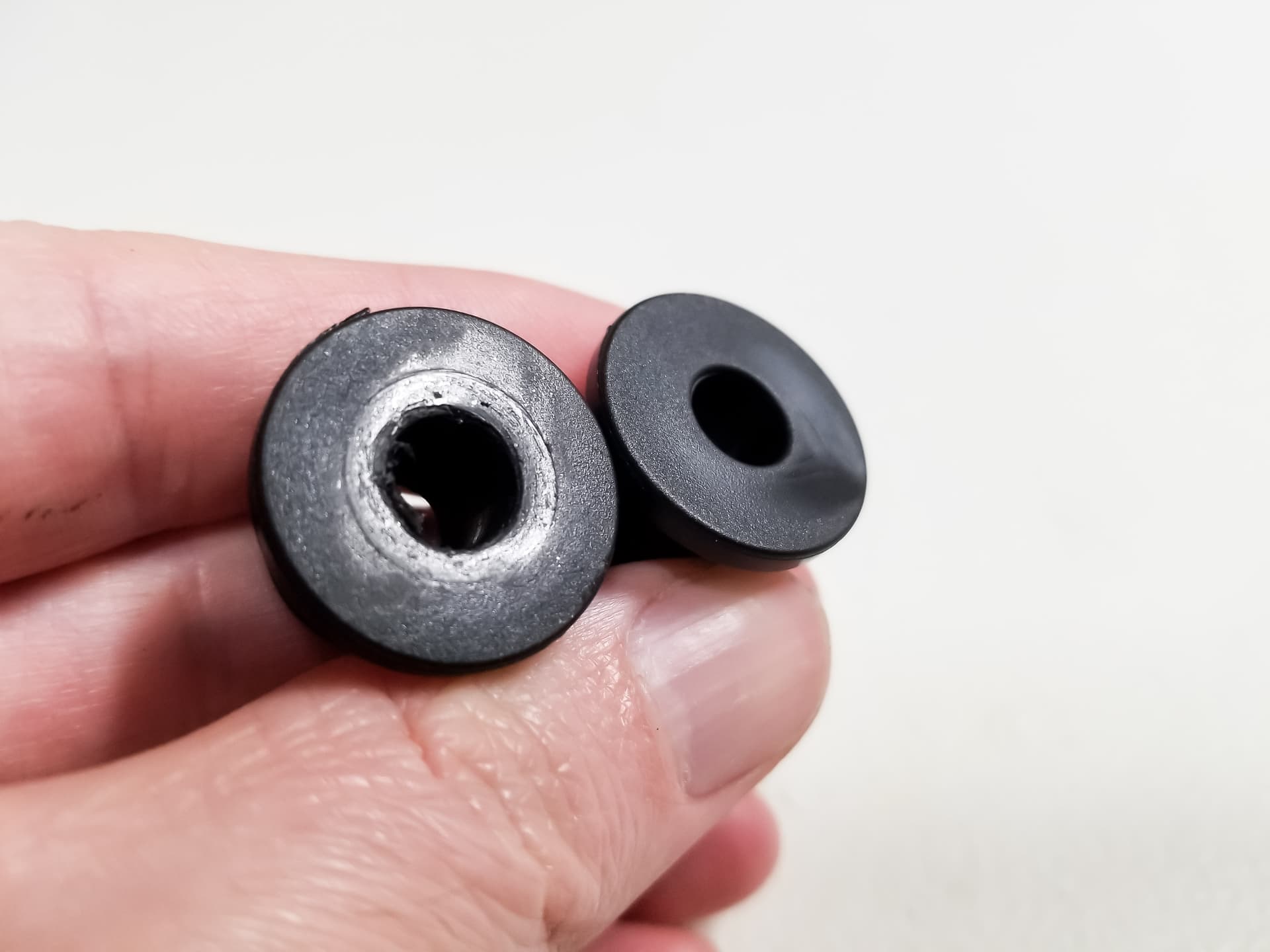

I also swapped out the MBS kingpin bushings. Old versus new:

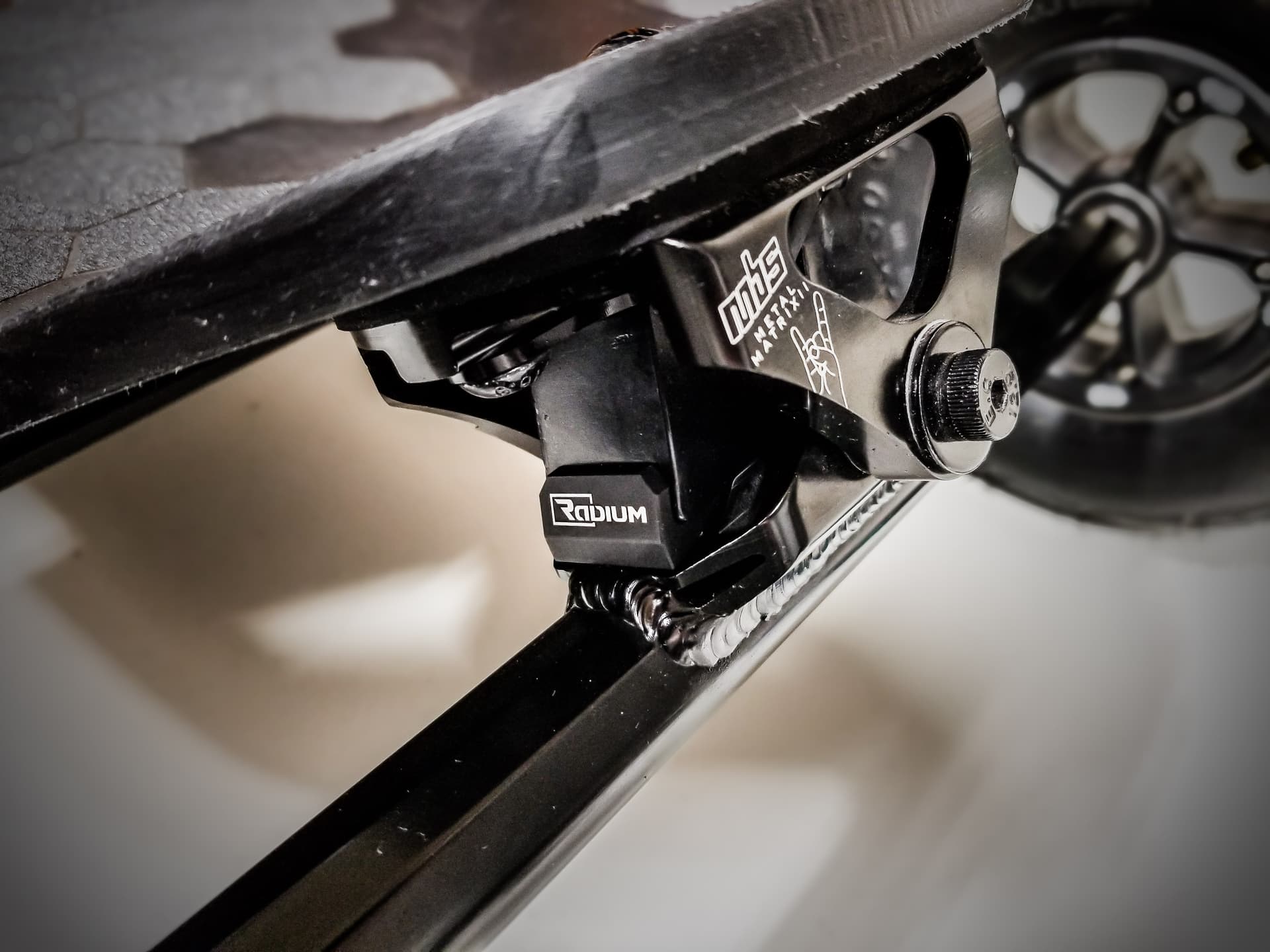

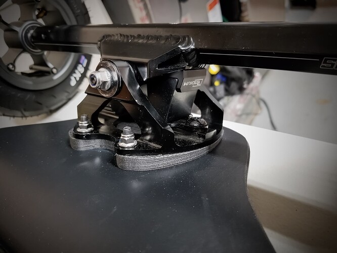

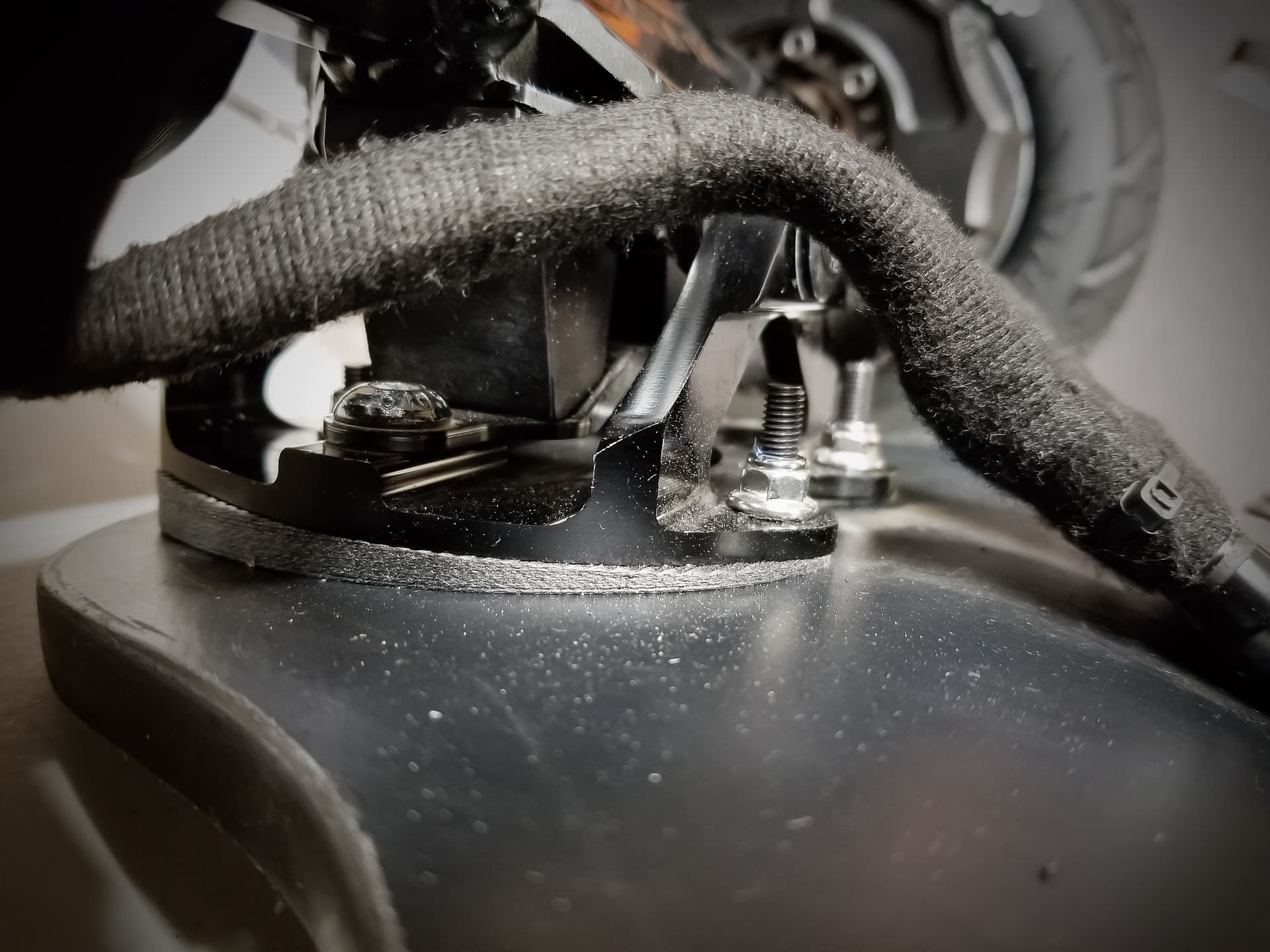

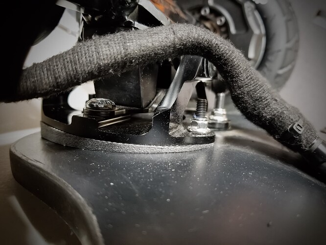

Next up… I swapped out the truck mounting hardware. This included new M5 bolts, M5 flanged lock nuts, 3d printed angled risers and some Radium antisink plates.
+5’ in the front:
-5’ in the rear:

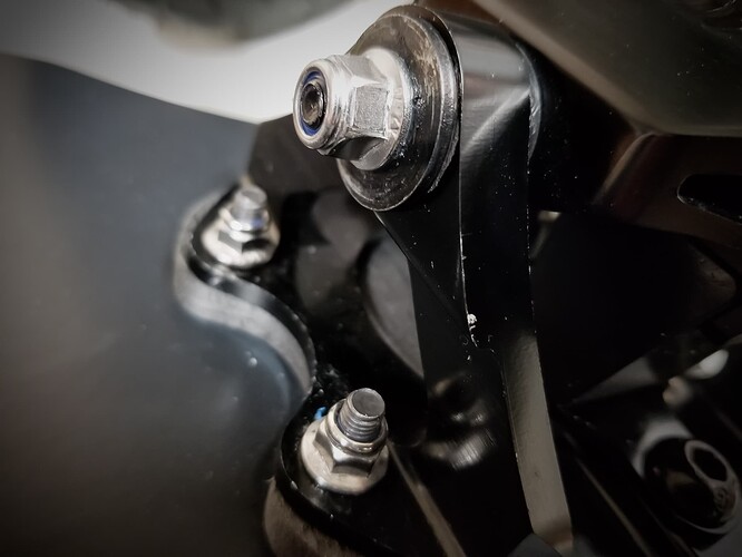

And swapped in some M6 flanged nuts on the kingpin bolt:
Okay, here is my logic on the angled risers. Seems like most channel truck users are swapping in a -10’ riser in the rear only. This creates a 10’ split angle (30’ front and 20’ rear) but has some downsides, like extra tension on the rear mounting hardware and a turn radius reduction. I decided to go with a 10’ split, but opted instead to do a 35’ front and 25’ rear. This puts almost no tension on the truck mounting hardware and should have a similar turning radius as before (30’/30’). I haven’t been able to take it for a test ride since installing the angled risers, so time will tell if my theory is correct.

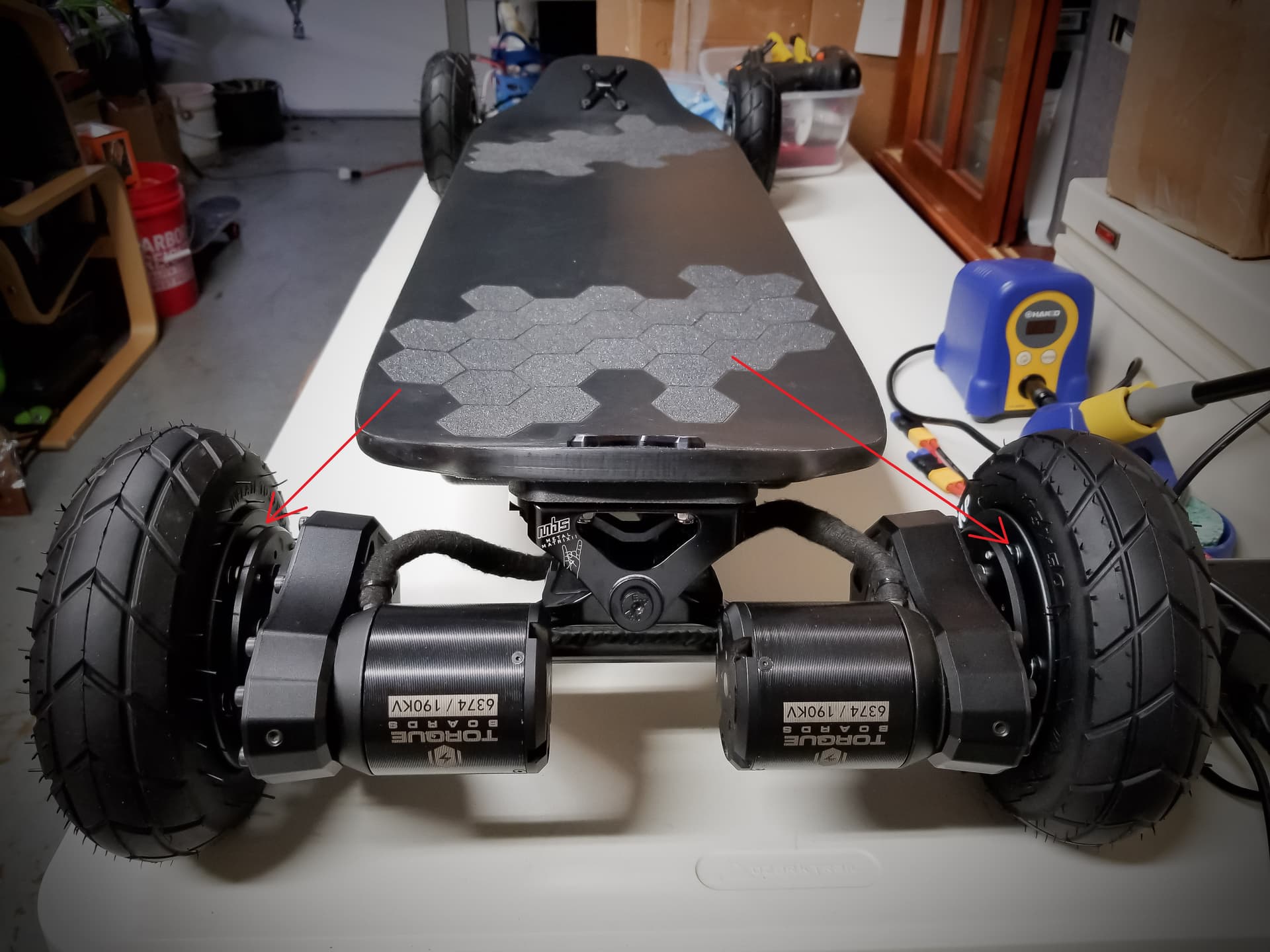

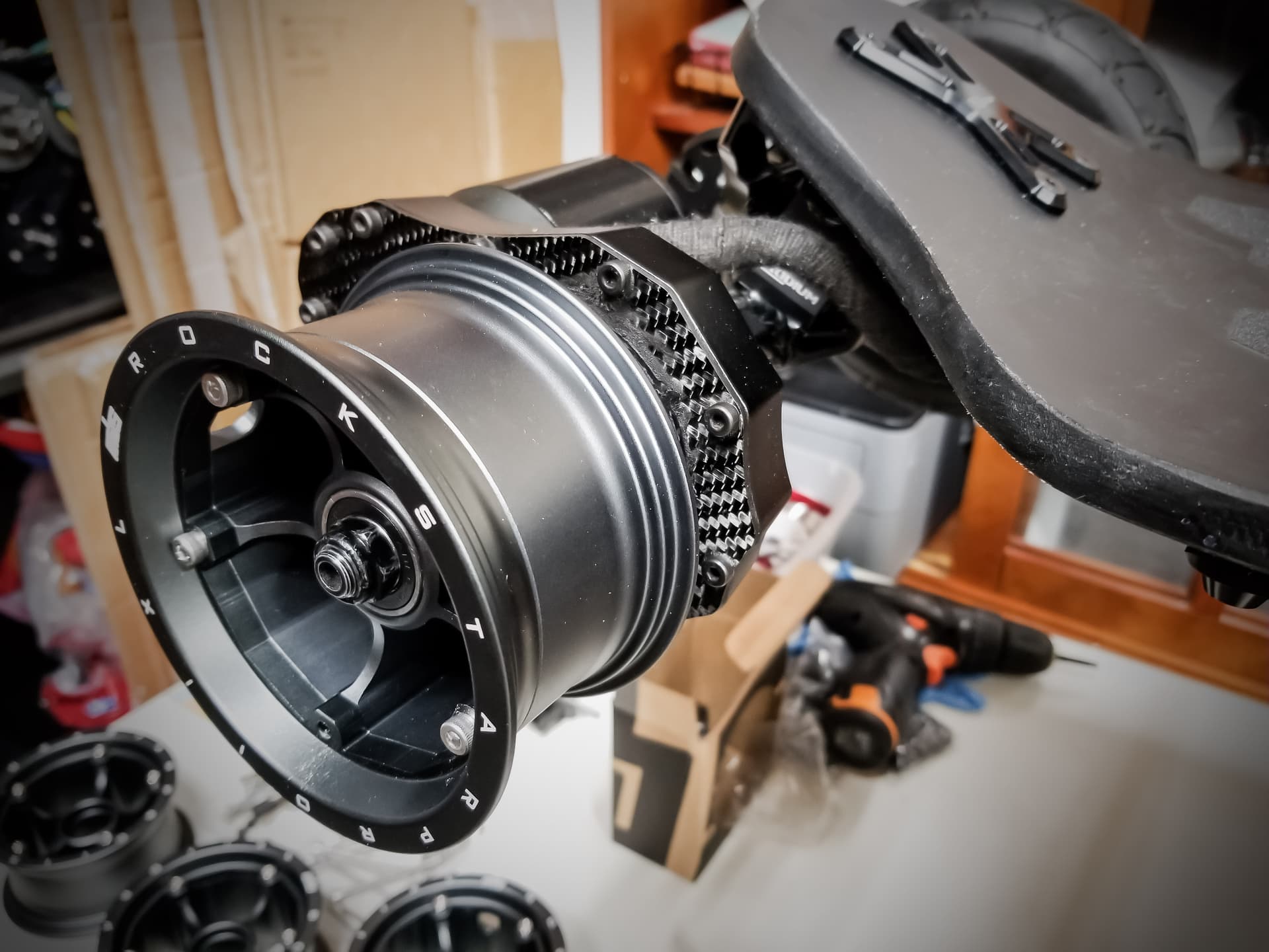

After that I started playing around with the new MBS Pro II XL hubs. The workmanship on these hubs is very nice. It was a bonus that they have the same bolt pattern as the OG Rockstar II hubs that I’ve been using for the last 2 years. I really like the faceted inside diameter of the hubs. Made it really convenient for placing balancing weights. The hub split line is offset towards the outside edge, which means that your balance weights won’t get displaced when you need to swap a tire.
Unfortunately the Moon drive position cannot be adjusted on the Matrix II trucks, simply because of the way they bolt into the hanger. This created a minor problem for the Pro II XL hub swap. Not only are the XLs wider, but the offset from the inside edge is different. I was really hoping that the inside edge of the Pro II XL hubs would be the same as the Rockstar IIs. Instead, the XL hubs sit further away from the Moon adapter plate.
This meant that I needed to buy longer M4 bolts and use additional spacers to get the hubs to bolt up to the adapter plate. Now I have spacers between the wheel pinion → adapter plate AND the adapter plate → hub. If I ever need to upgrade the Moon drives, I think I’m going to want some press fit adapters. Getting real tired of playing around with tiny spacers.

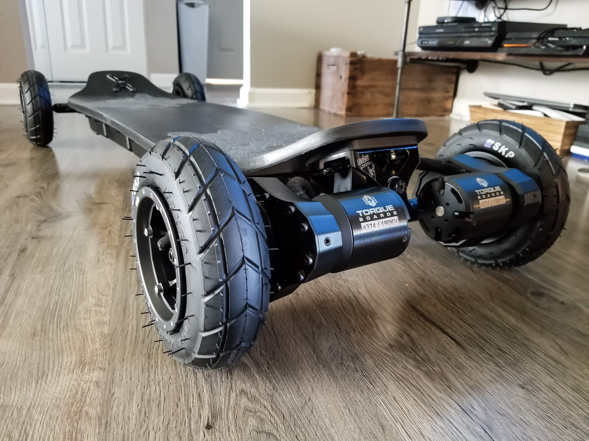

Anyway, here is a pic of getting the rear hub mounted up to the GDs:
Then installed the new rubber from SKP.
Back on all four!
Here is a picture showing where I had to install the hub spacers:
