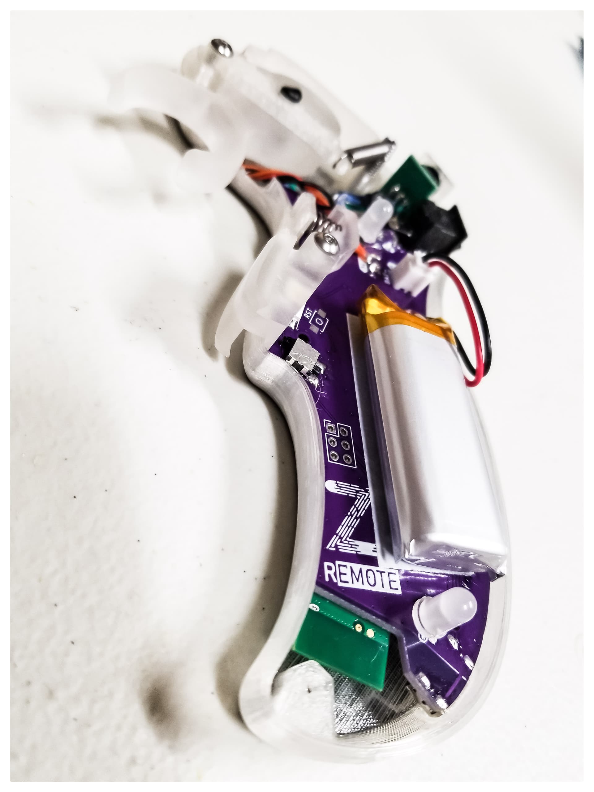

Update time! Got my Zmote in the mail. Only took about 3 weeks to get here from Bulgaria. I was impressed with the build quality and components used. The lighting function is pretty cool too. Should help boost my visibility when riding on the road.
Took it apart, installed the battery and reconfigured the throttle values in the VESC Tool. Will follow up with another update once I’ve had a chance to ride with it.

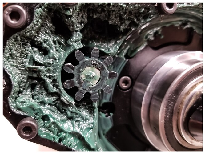

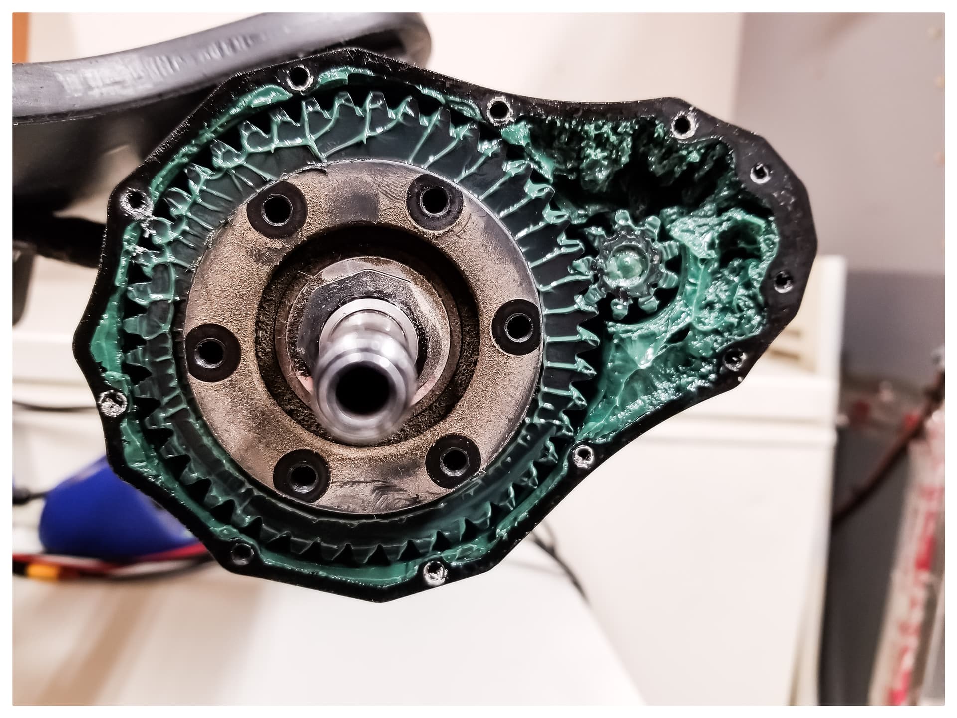

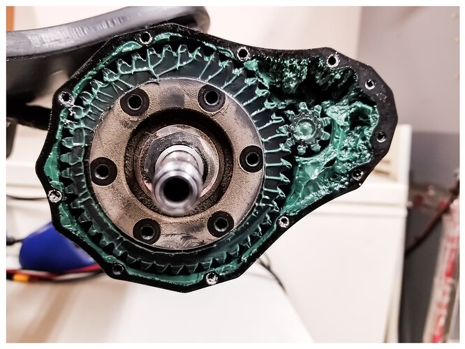

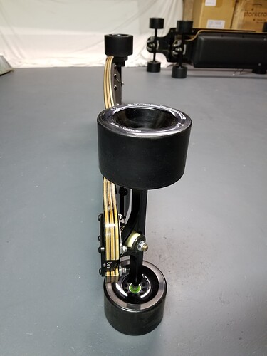

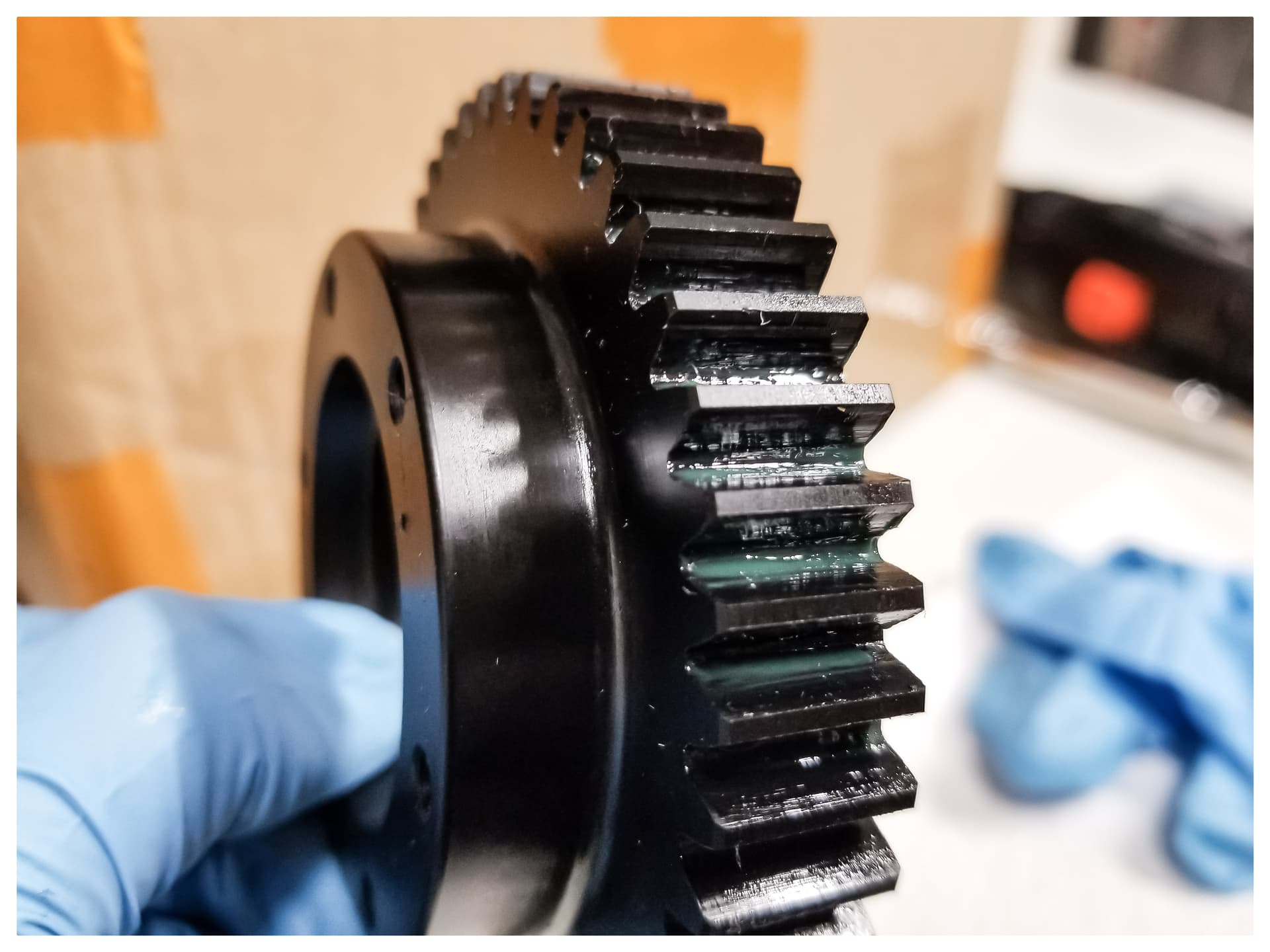

The next up was to clean and inspect my Moon drives. I’ve put ~1k miles on the drives since they were first installed on the Flux. The drives have never been open or accessed since the install, so I was super curious to see what the insides looked like.
Removed the CF cover:

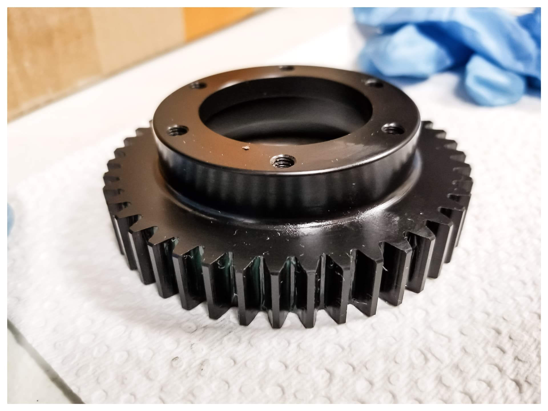

Then removed the wheel pinion. It was degreased and carefully inspected for wear or damage. Can’t believe how good the condition is! They still look brand new.

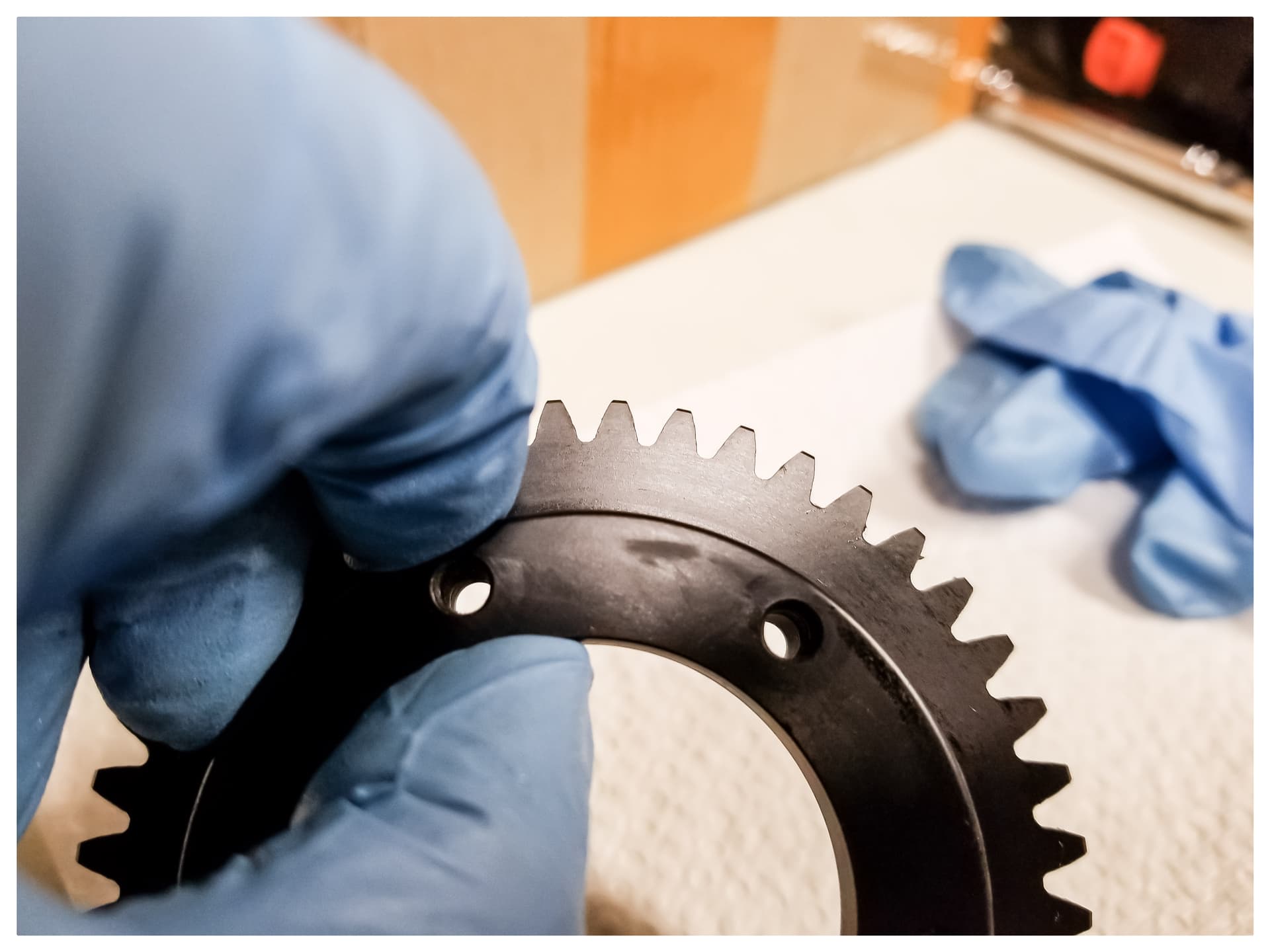

Then I inspected the motor pinion. Pretty interesting to look at the grease build up around the case. There doesn’t look like much wear on the motor pinion, but I could see some spots where the black anodization was starting to wear off.
It took about an entire roll of paper towels to remove all the old grease. Then I button the drives back together and added fresh grease. Not sure if it was my imagination or not, but the drives seemed more quiet and smooth with fresh grease.

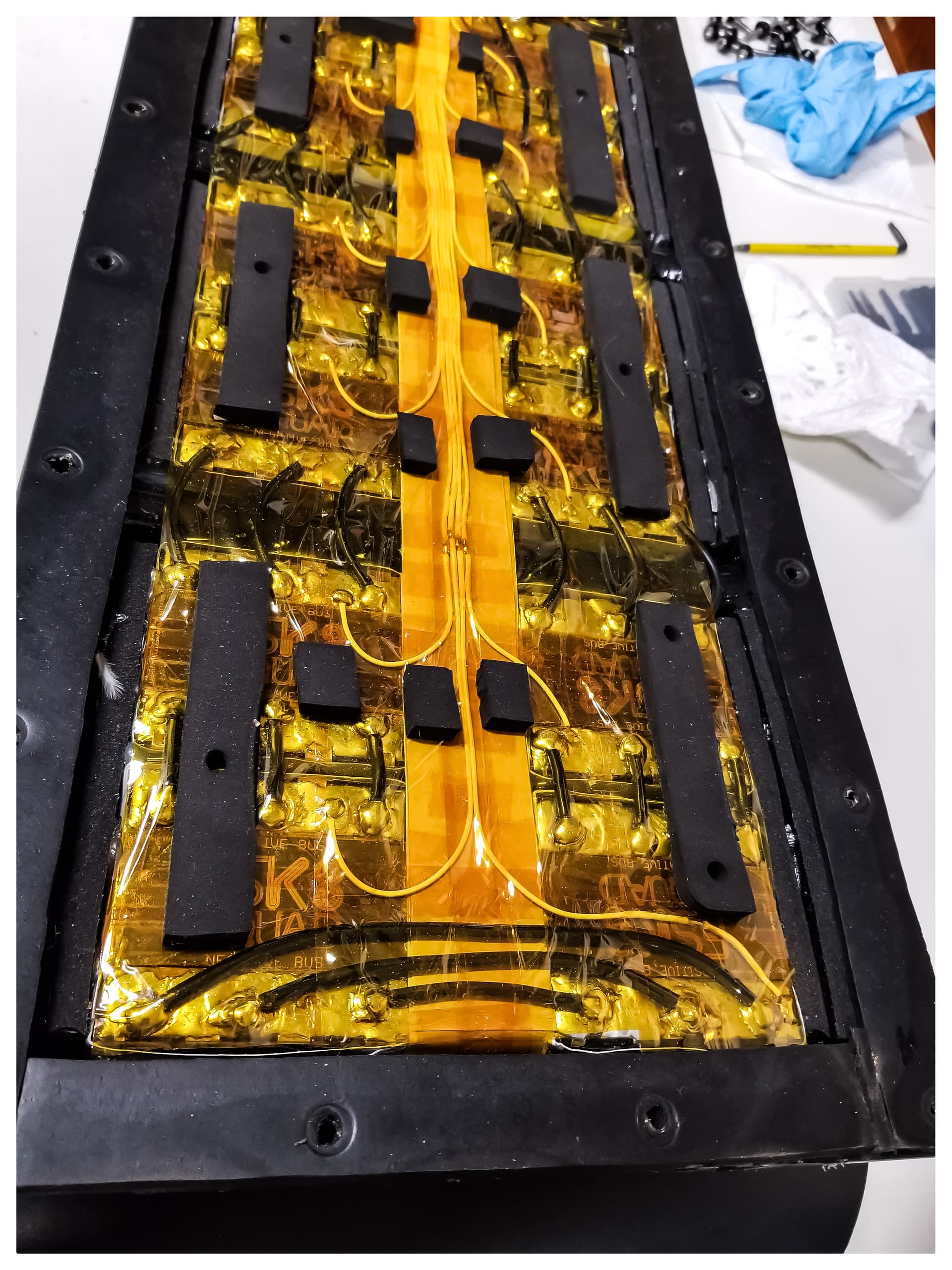

Then I removed the enclosure for the first time in 2 years. Wanted to give the battery a visual inspection for broken series connections or loose balance connections. Everything still looked solid. Was really impressed by how clean it is. Looks like my gasket is doing a good job keeping moisture and dust from getting inside.

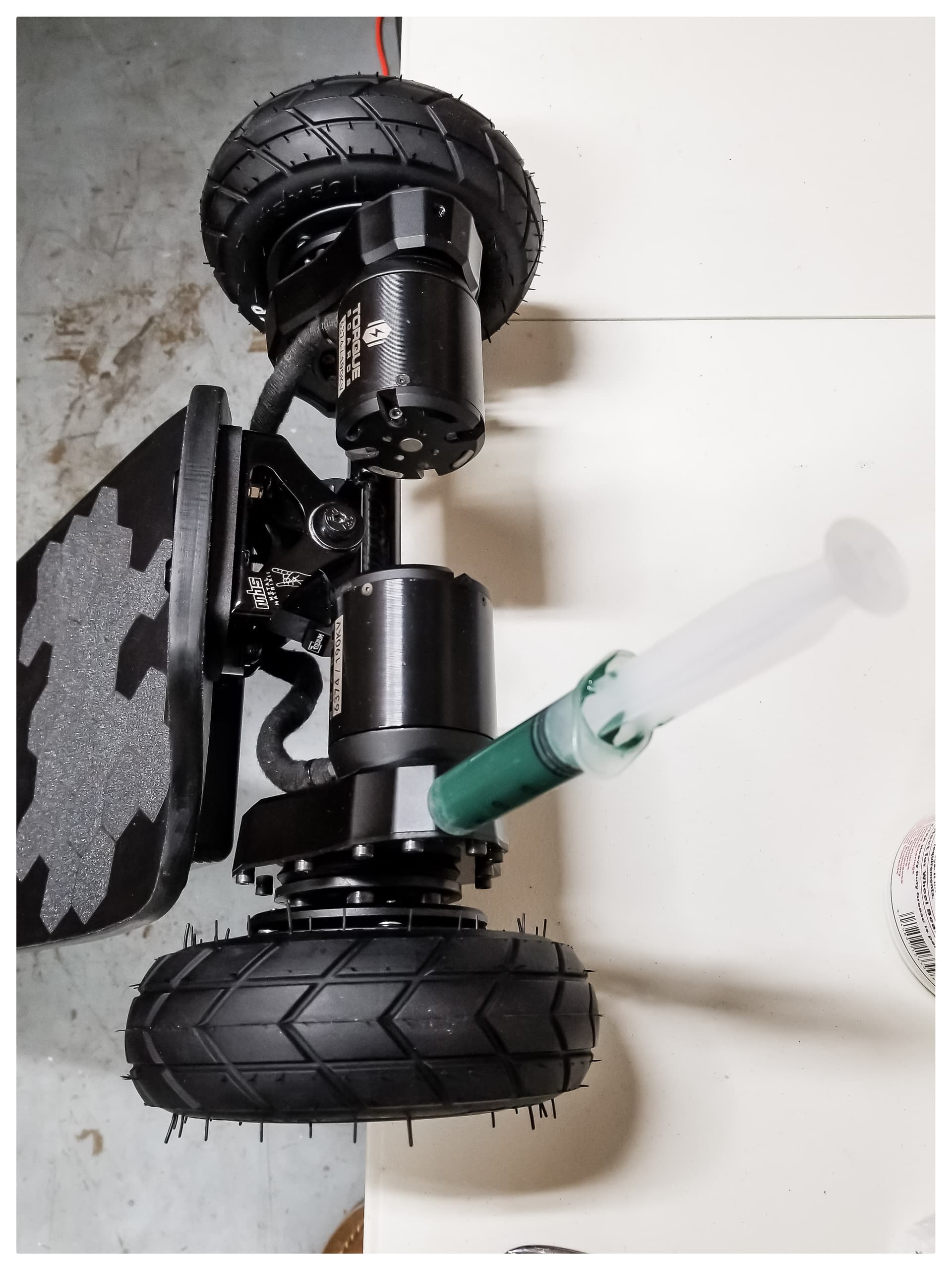

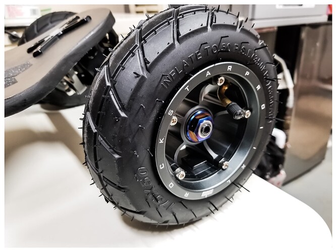

The last step was to add some slime to the wheel tubes and secure the hubs with some titanium bling. Sexy!

Snap… those wheel nuts are the shit!
Whats your take on the slime? Ive never really had it save me and have stopped using it, i find that i lose the tyre pressure too quickly for it to be very effective. I just carry a spare wheel with a pulley attached now.
Hard to say. I haven’t had a flat in two years of riding this board. Carrying a full size spare is a good idea.

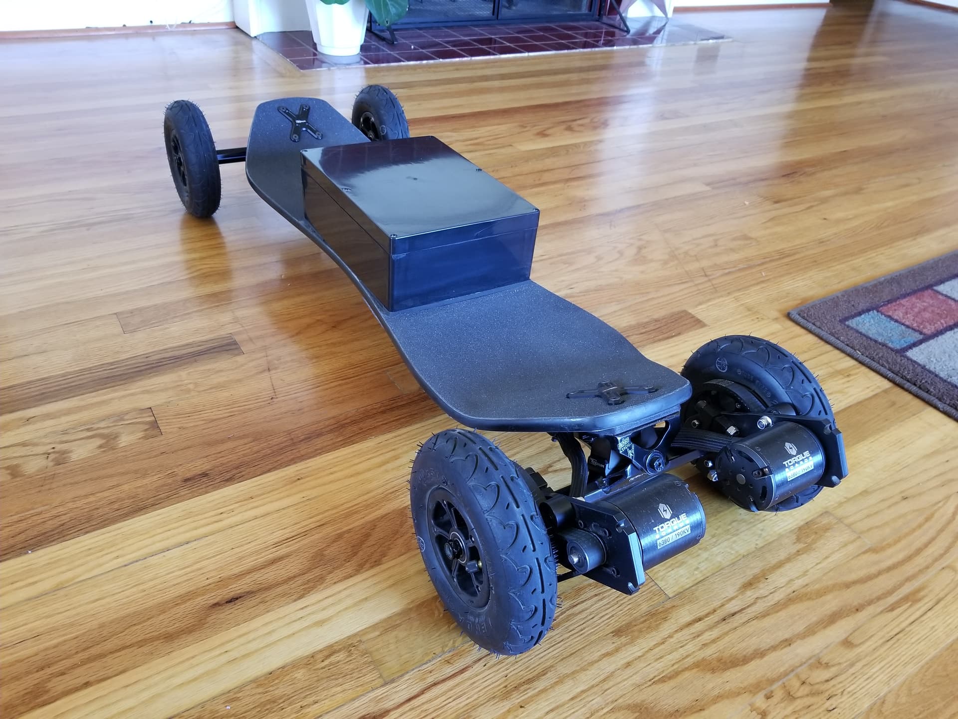

Okay, so onto the exciting stuff:
  • The DIY Flux: This board has become pretty dull with it’s almost 4 year old 30q pack. The battery remains perfectly balanced, but has really lost any amount of punch that it used to have. It’s time to give this thing a refresh. I’m planning to build an 18s6p P42A pack and will also sprinkle on some fresh components (MakerX D100s, SKP/Reacher 6485 151kv motors, NewBee 4GS GDs, etc.).
  • Titus’s MTB: I finally convinced my 15 year old son to give up his electric street luge, which wasn’t easy. He was pretty nervous to transition to something that requires standing, so we decided to build him something that was budget friendly and super capable.

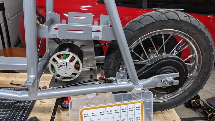

  • Eden’s Razor Pocket Mod: My 12 year old daughter wanted to get into the hobby, so I let her pick out the form factor that suited her best. She was immediately drawn to mopeds/motorcycles, so we found a used Razor Pocket Mod on craigslist for $50. The battery was dead and most of the components were rusted. We swapped out the 24v battery and coverted it to a large capacity 8s lipo.
    Pics of when we brought it home:
    The pink had to go, so she painted it blue. What an absolute heartbreaker:
    She’s been tearing it up for the last few years on this thing:
    giphy (1)
    Naturally, she’s been begging me to modify it to go faster. It currently tops out at about 15-17mph, but she wants MOAR speed. I stumbled upon @jack.luis build from a few years back. Pic from his thread which totally inspired me:
    So later this winter we will be tearing down her scooter and coverting it to a 12s lipo VESC based platform using a SKP modor and Solo VESC. Stay tuned for more info on that!

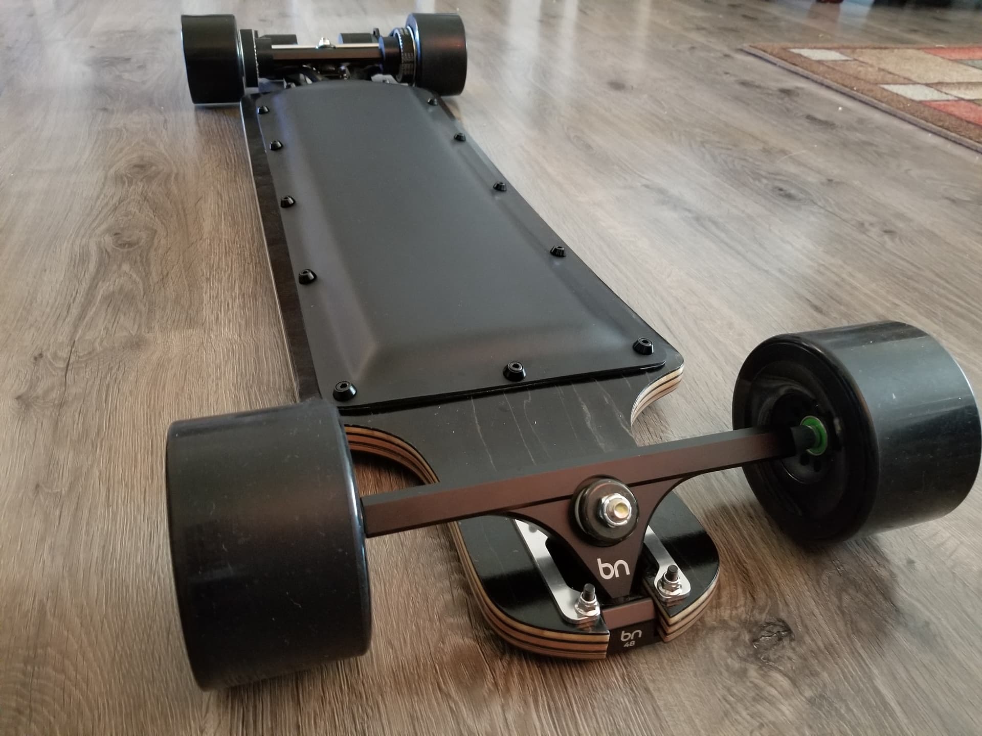

  • And last but not least, I’d like to present my new venture:
    This recent near-death experience pushed me to reconsider all the things that I’ve always wanted to do, but could never work up the courage. Well screw that, life is too short. I’m done letting fear and intimidation hold me back from things I want try.
    I’ve always wanted to try starting up a small business of some kind. And I love building esk8 stuff, so I figured why not. At the moment I’m building 6 boards with the intent to sell them in the Spring of 2024. It’s baby steps, so who knows what will come of it. Just secured an LLC, grabbed an IG, web domain and had a logo designed.
    This first batch is intended to be a boutique quality urethane build for those that are too intimidated to embark on all that is DIY. Here are the specifications:
    Hummie Carbon Fiber Deck
    BigBen Single Stack Fiberglass Enclosure
    12s4p Molicel P26A assembled w/ the Duck Battery Systems PCB (140A discharge potential,
    10,500mAh capacity, 7,000 watts)
    LLT SmartBMS w/ Bluetooth module (charge only)
    BKB Xenith/Focbox Unity
    Boardnamics Split Angle CNC’d Precision RKP Trucks
    BN 33’/48’ Split Angle Baseplates (designed to sit at identical heights)
    BN 220mm Hangers
    BN Press Fit 44t Wheel Pulley (w/ integrated support bearings)
    BN 16t Motor Pulley
    Riptide KranK Barrel Longboard Bushings (87A Front/93A Rear)
    Riptide Antisink Plate
    Custom Designed IDEA Precision Motor Mounts (anodized black)
    ATC Dual Crossbars
    Black Hoyt St Zoobomb 111mm wheels
    Classic Zealous Bearings (w/ integrated spacers and speedrings)
    Dual Flipsky Battle Hardened 6354 190kv Motors (sensored/FOC)

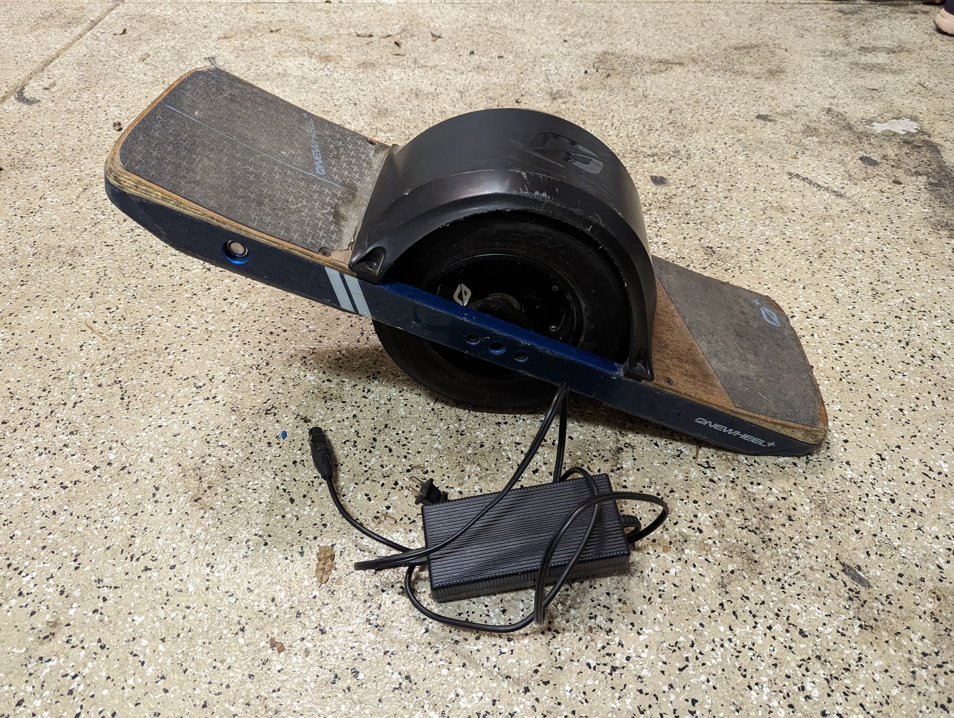

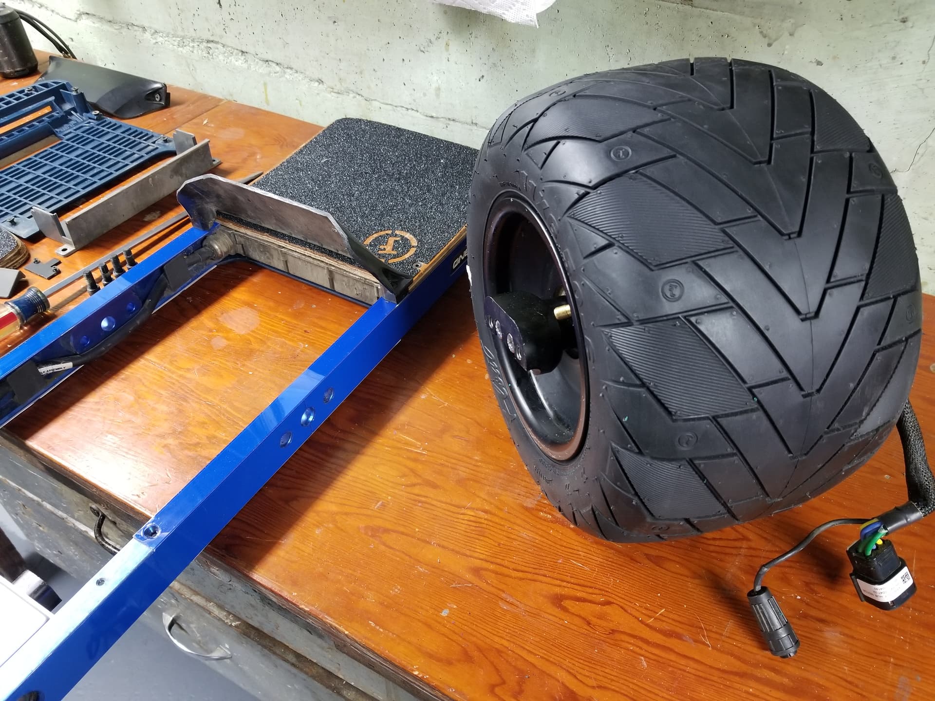

Dude, how could I forget? This year I bought a used OW from @ARCTIC as a bday present to myself. I had to swallow my pride a bit on this topic, because I’ve always been against the concept of a gyroscopically controlled vehicle. All it took was one experience on a friends OW and I was friggen hooked. It’s so fun. I’ve been so pleased with how well a OW fits into the daily routine. I ride it around the basement and toss it in the trunk when I’m running errands. This thing is all about the slow speed micro adventures.
The day it arrived. The internals were solid, but the outside was pretty crusty.
The kids love it too…
Chopped up the fenders, installed a new tire and gave it new shiny bits.
Someday I might convert it to something VESC based, and maybe toss in a battery upgrade… but for now I just enjoy it for what it is.
