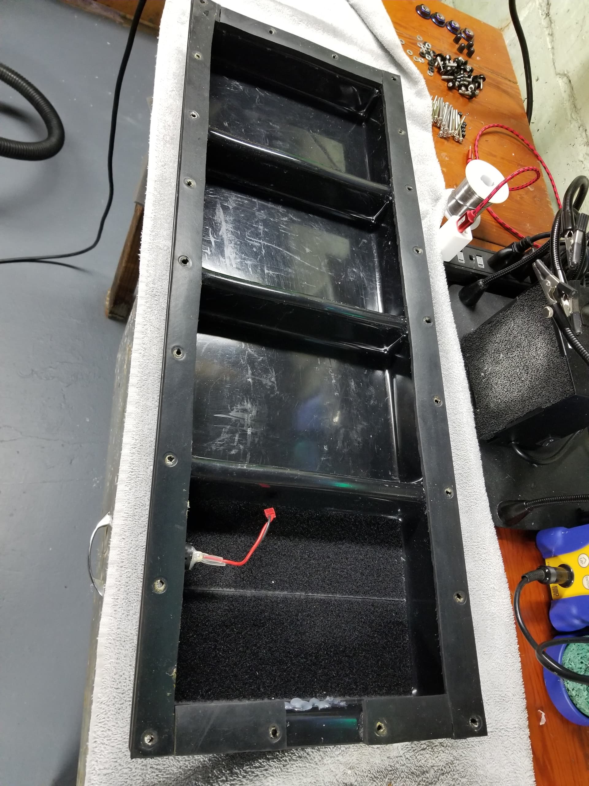

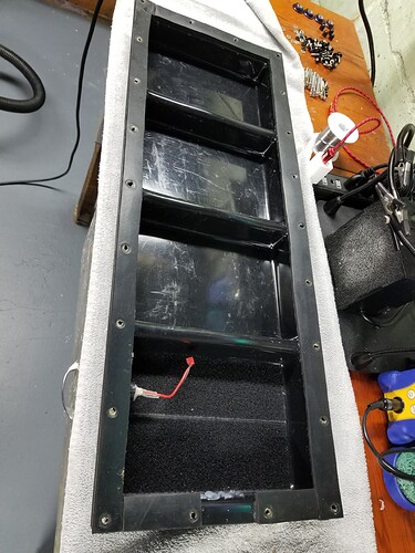

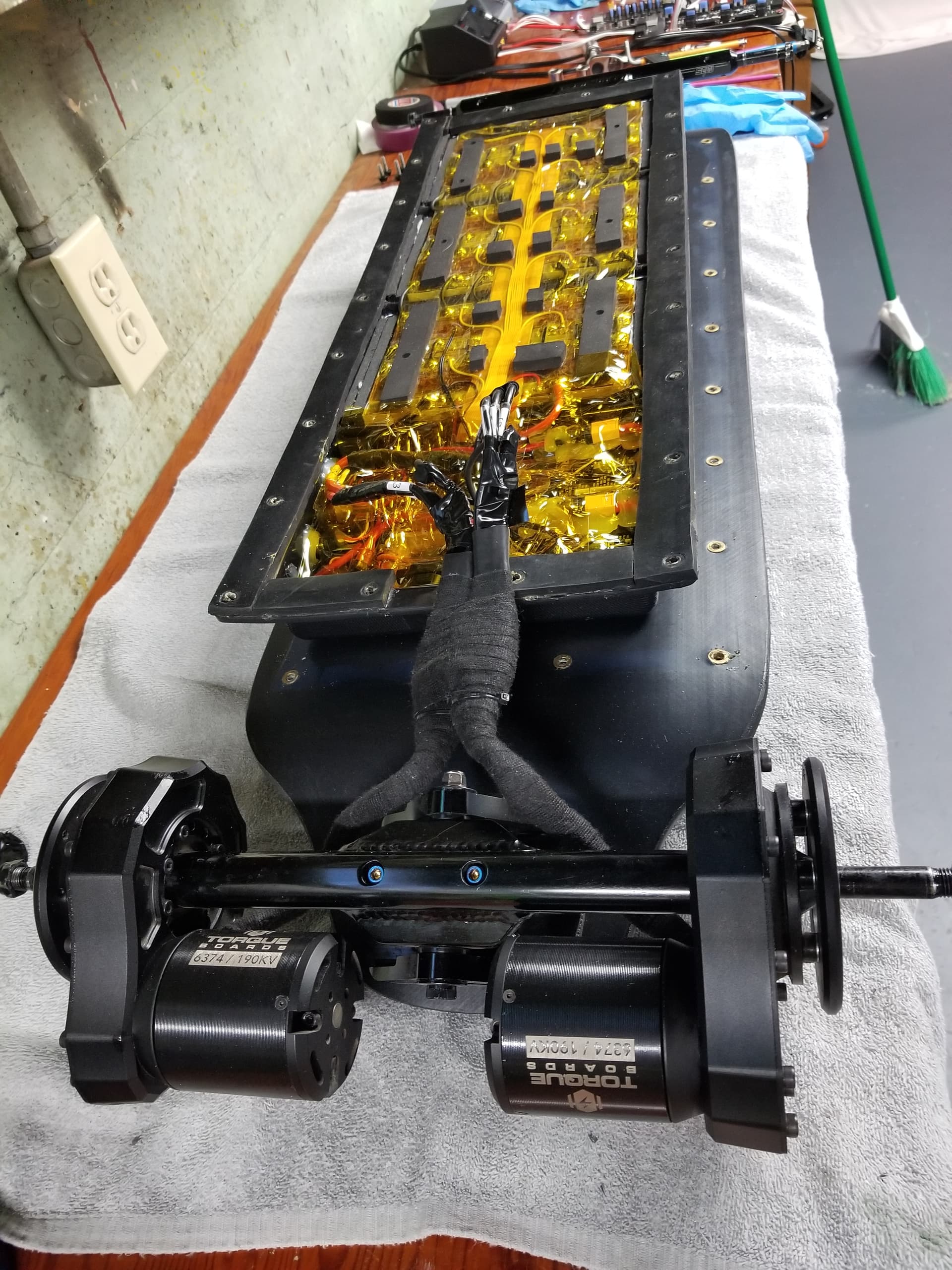

Minor update on the Flux. Pulled off the enclosure, which felt like opening up a time capsule. Everything looked clean and intact. My building skills have grown so much over the last 4 years. It’s kind of fun to see my old work and reflect on how I would have done things differently today.
Stripped out the enclosure and cleaned it really good.

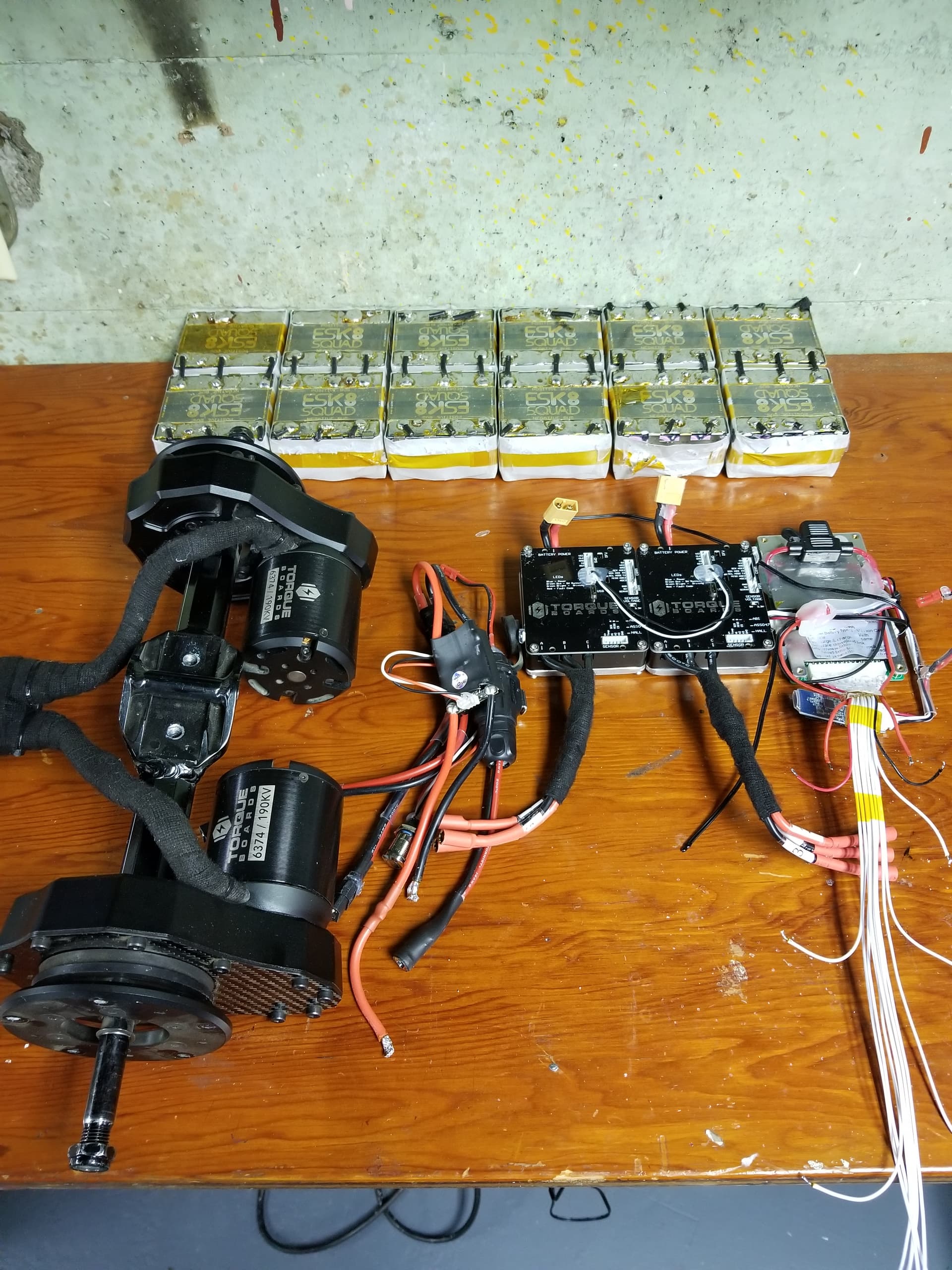

Here are some components that are going to be repurposed or sold:

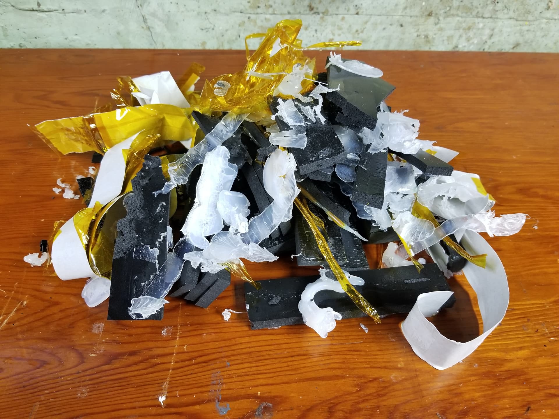

So much insulation, hot glue, foam and tape removed!
In 1 hour… I was able to tear down a board that took me nearly 6 months to build. Still feel kinda sad about that. Oh welll, it’s now ready for the next chapter in the build… high voltage!

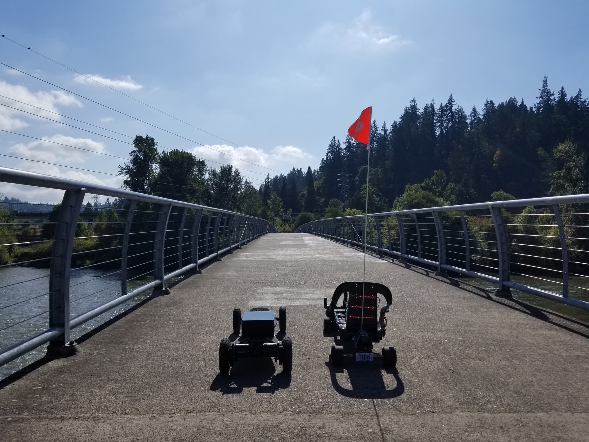

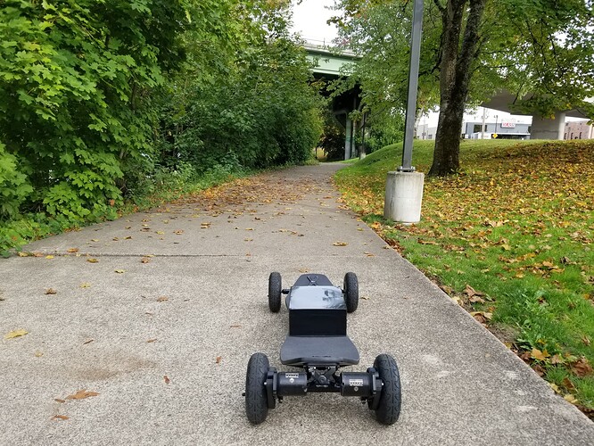

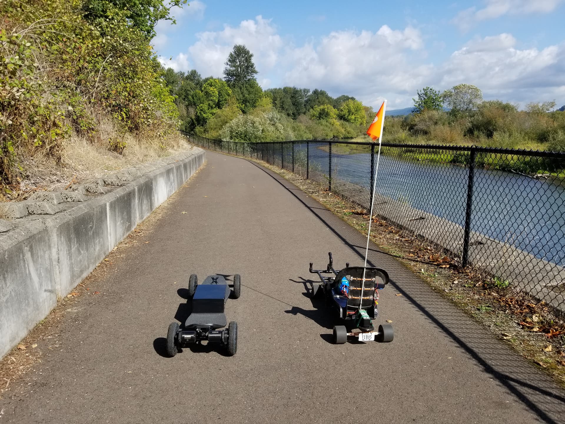

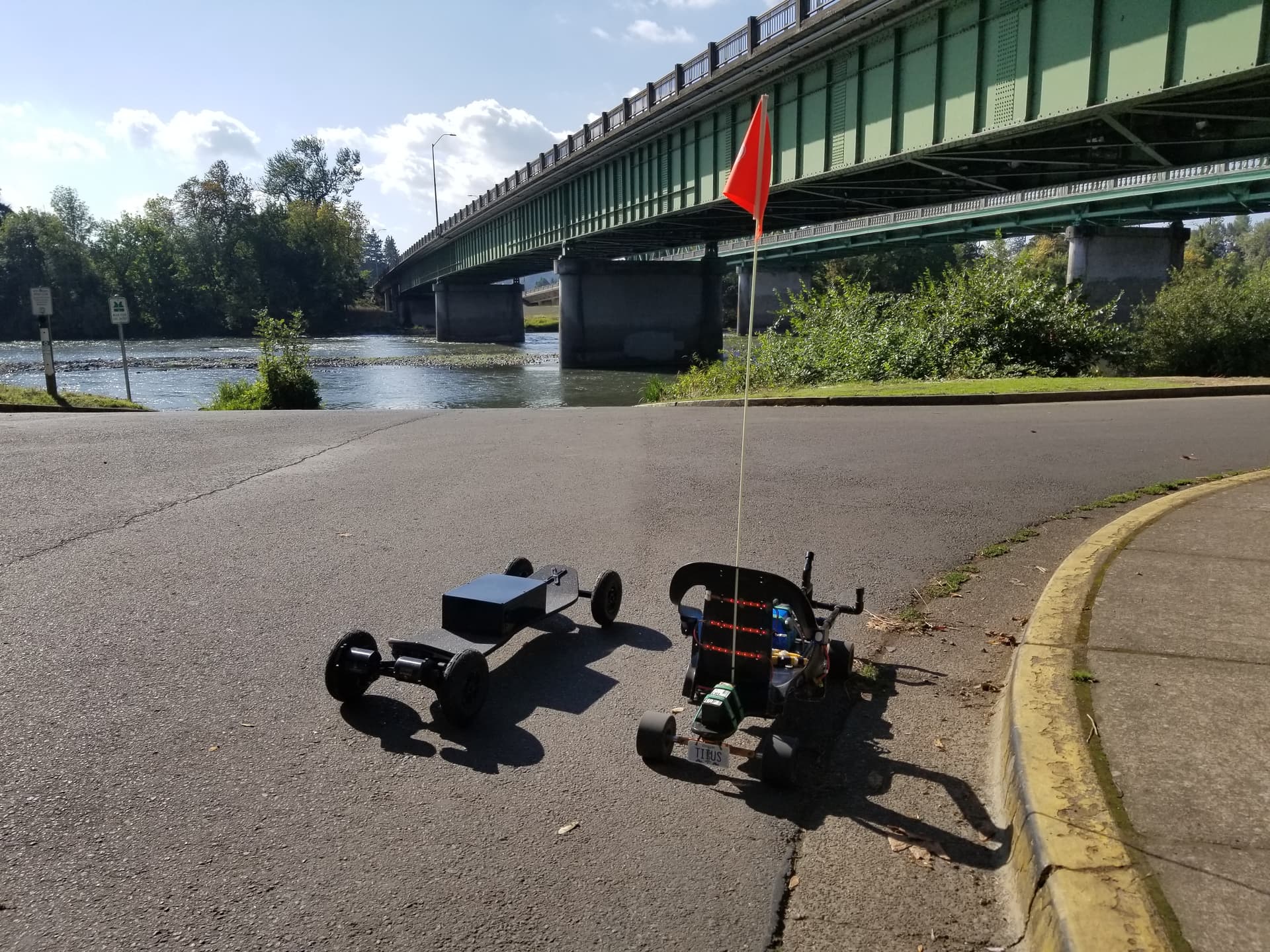

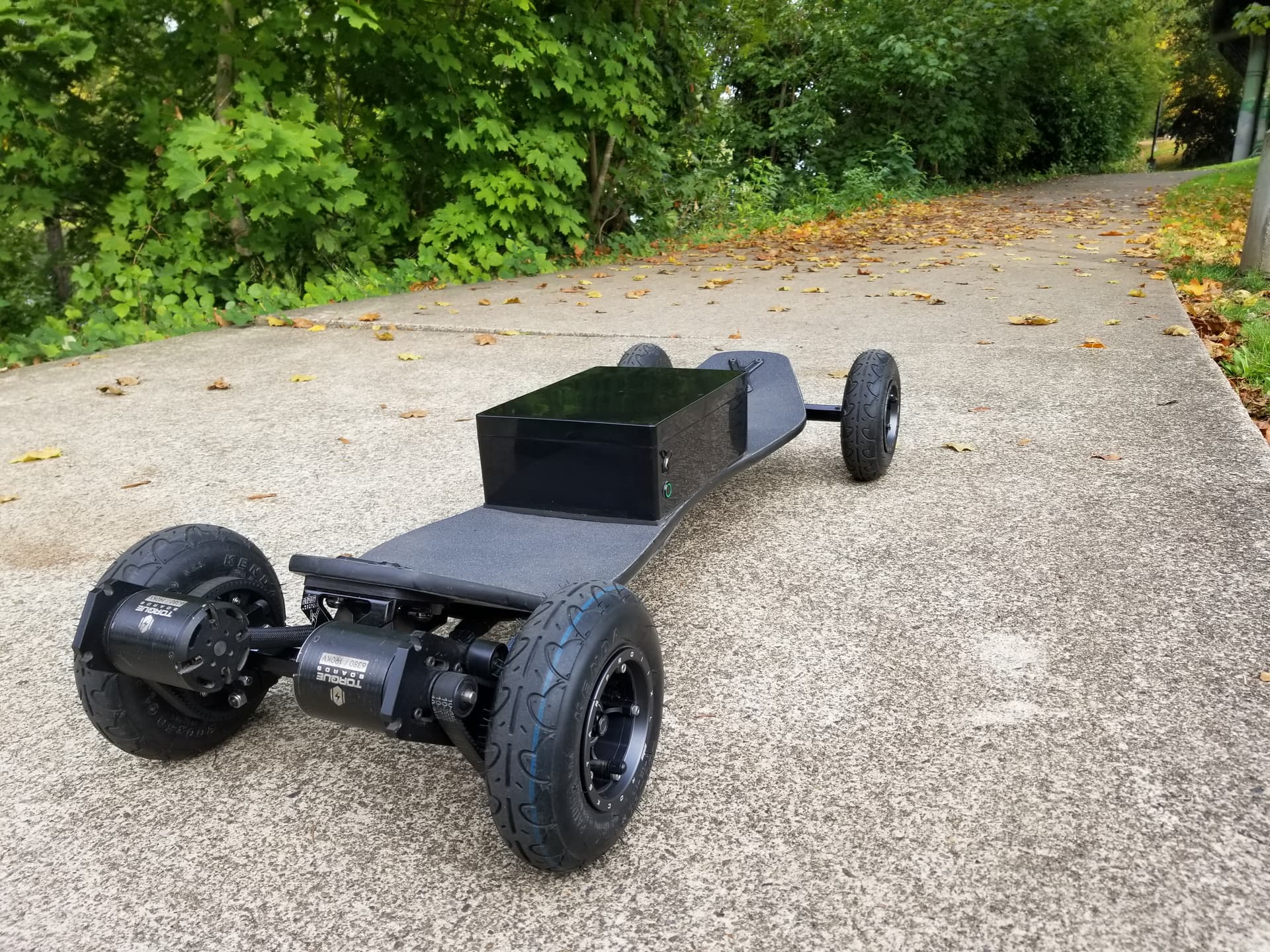

Last weekend the weather was unusually warm for Oregon in October. 80’ in the valley and 90’ at the coast. The typical weather pattern this time of year is a mixture of rain, wet and more dampness, so we decided get outside. Most of our riding this year has been around our small town, so my daughter and I decided to drive 45 minutes south to a larger town that has some fantastic bike paths.
I used to live in this town so I’m familiar with how to map out a good ride. There was a new section of bike path recently installed at Dorris Ranch, so we incorporated that into our 24 mile plan.
Bike path along the Willamette River.

My brain was so confused with this strange combination of leaves on the ground and warm air.

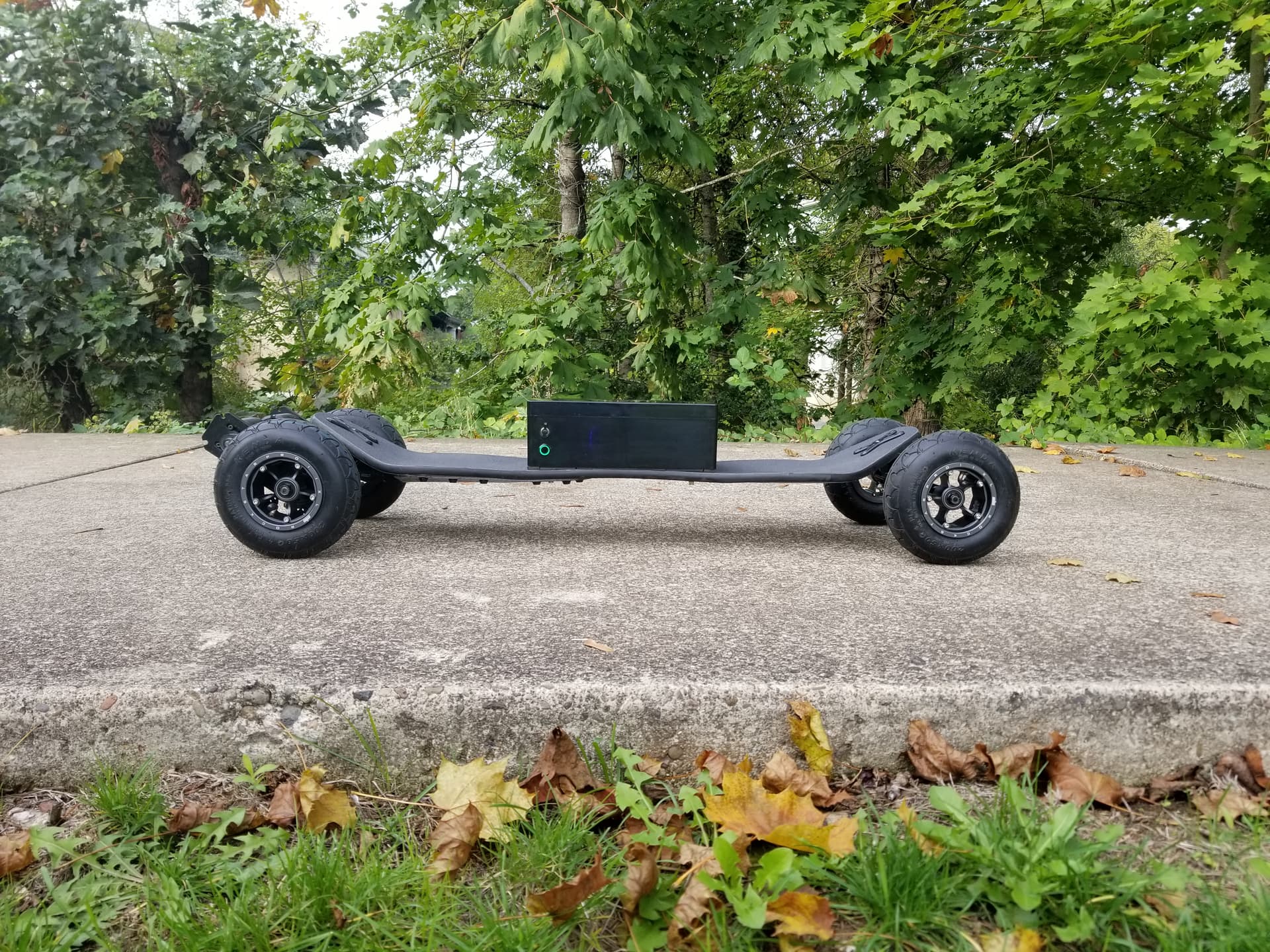

This was the first real world test with the new Haero Bro build. This deck is very comfortable for long rides. It has more flex than the Flux deck which helps with foot fatigue and general comfort. The flat profile with the integrated “gas pedals” provided a strong sense of confidence.
My only complaint is really just the drive train. I’m convinced that plastic hubs with an unsupported wheel pulley is a bad combination. The plastic MBS Rockstar hubs have a little too much flex and the Lacroix 72t wheel pulley have integrated stand-offs that place too much leverage during acceleration & braking. This results in some wheel pulley play as well as some squeaking & groaning, which absolutely drives me nuts.
The next chapter in the Haero Bro build will be some MBS Rockstar Pro II XL aluminum hubs combined with some wheel pulleys with no stand-offs. The goal is to align the unsupported wheel pulley as close to the wheel bearings as possible, for less cantilever. More to come on that later.

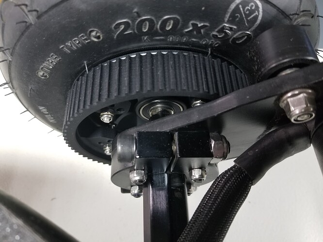

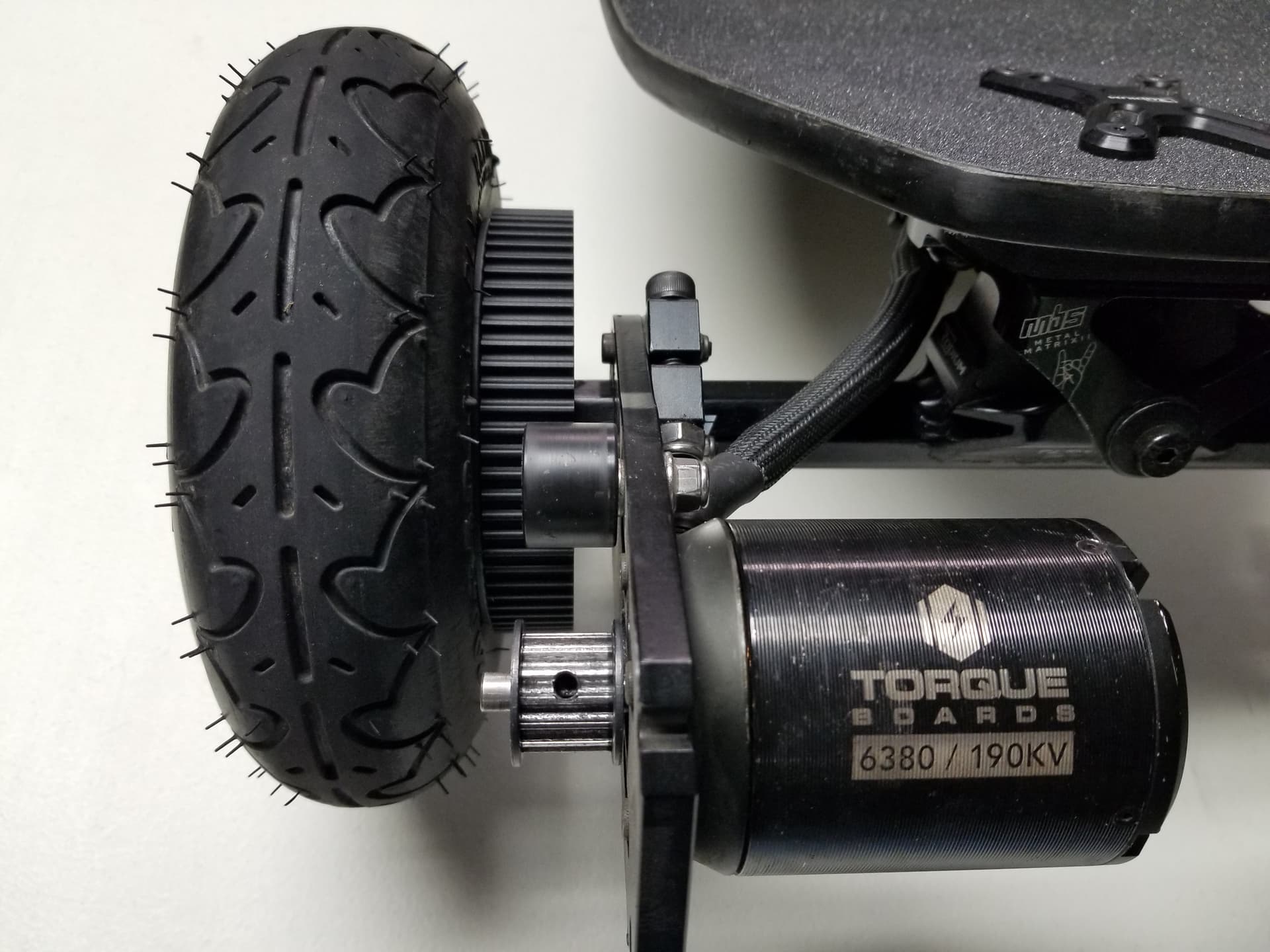

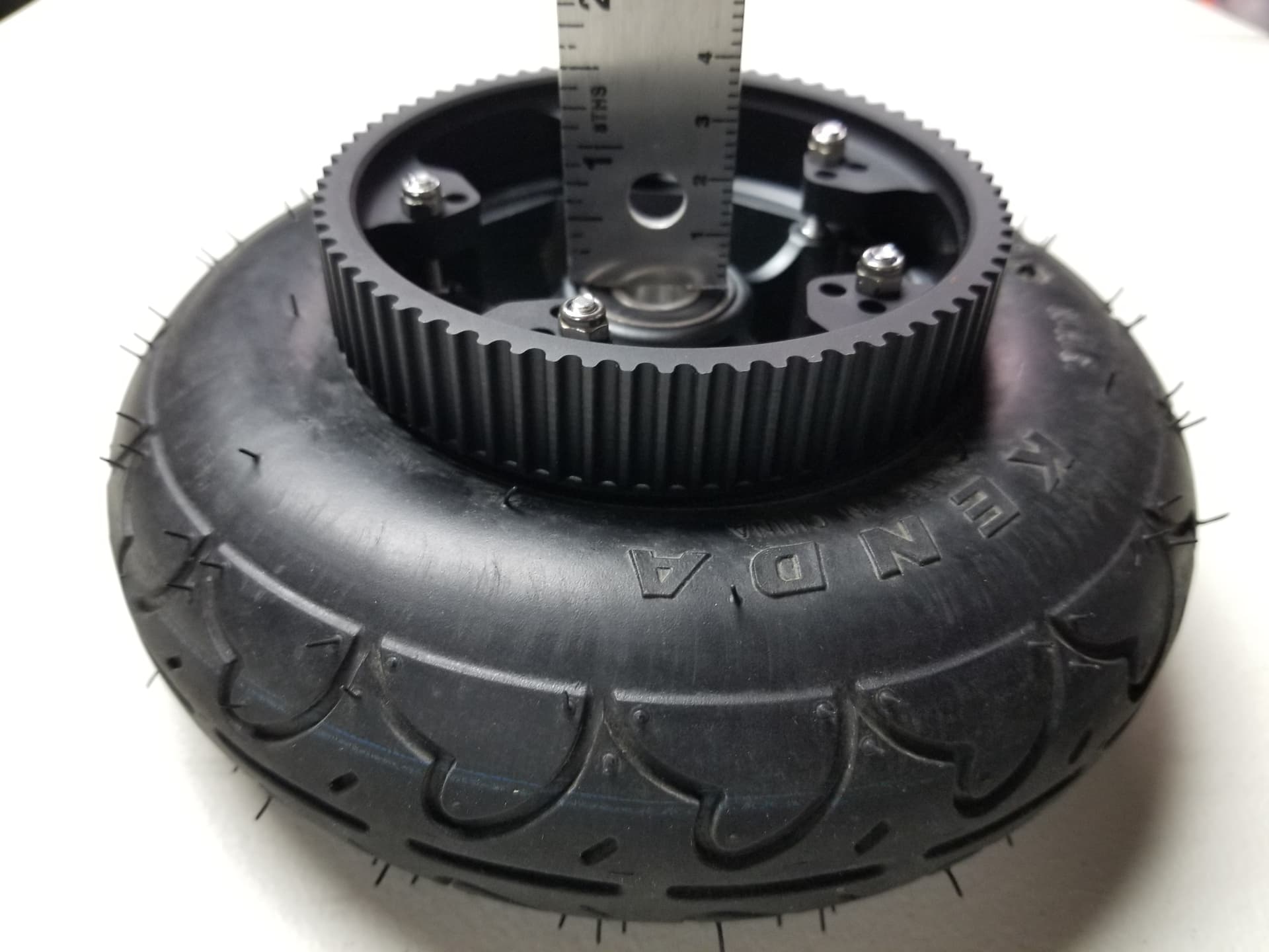

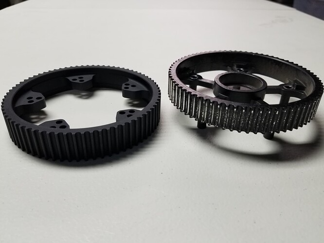

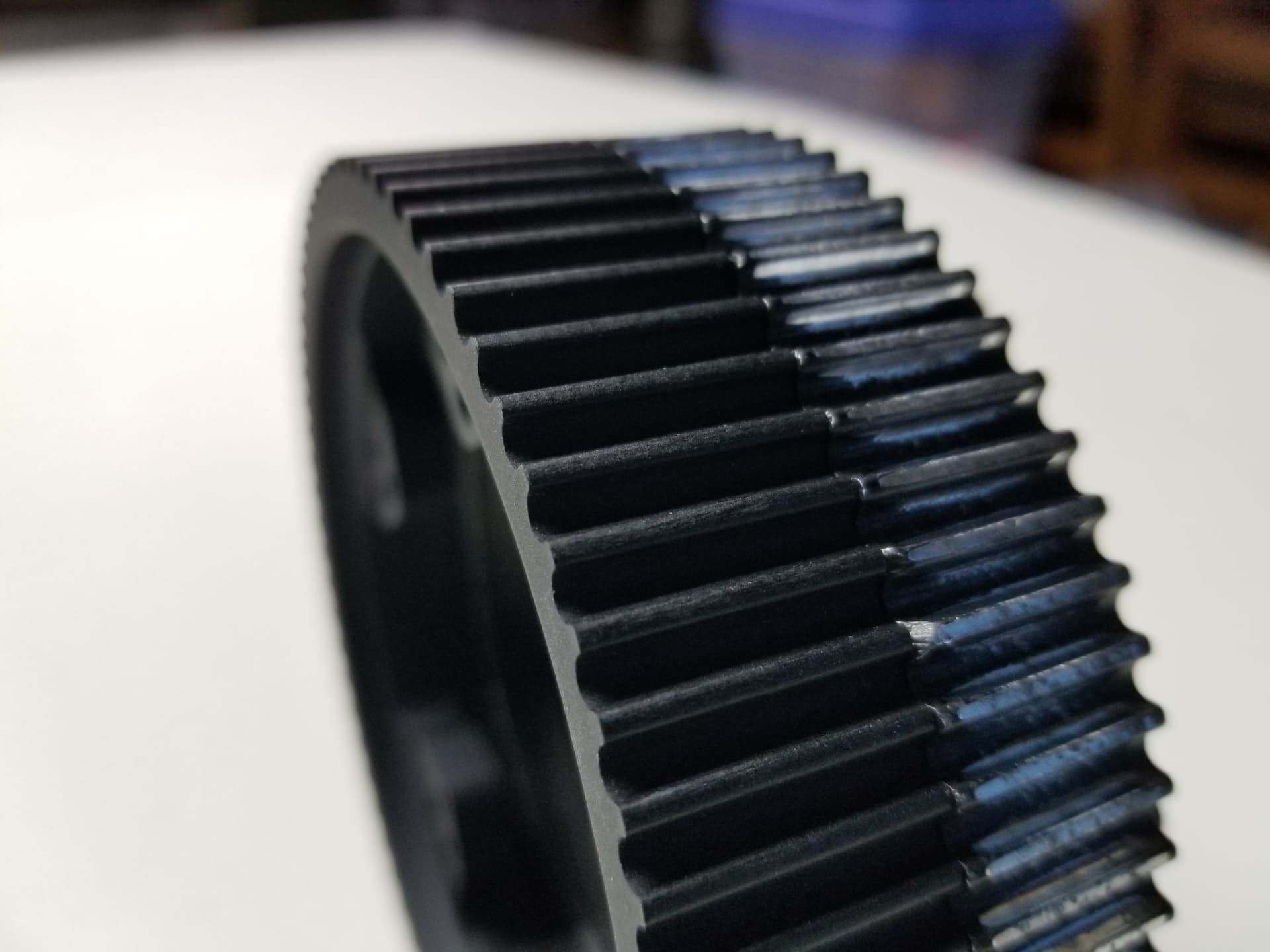

I mentioned previously that I wasn’t happy with the combination of the plastic hubs and the unsupported wheel pulley on the Haero Bro build. The MBS Rockstar hubs tolerances aren’t the best around the bearing seat, and the offset on the Lacroix pulleys created a bigger cantilever than I was comfortable with. This caused excessive creaking and groaning when rolling around, which drives me nuts.

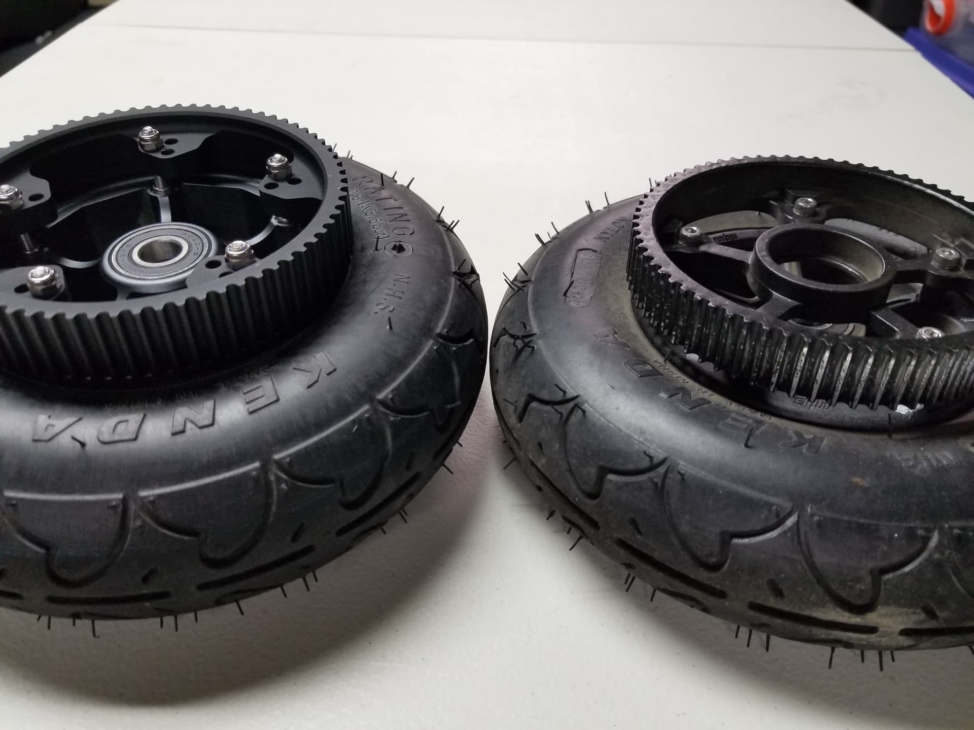

The Flux is currently in pieces and will probably stay that way for awhile, so I decided to experiment with the MBS Pro XL hubs that I used on that build. I messaged my homeboy @IDEA to see if he had any 72t wheel pulleys and sure enough he had exactly what I was looking for. These beautiful pieces arrived 4 days after I sent a payment. Pretty impressive considering these pulleys traveled 5,523 miles from Krakow, Poland to Oregon.
Comparison between the pulleys:
Then I mounted the Idea pulleys onto the Pro XL hubs. Notice the difference in offset between the edge of the pulley and the wheel bearing. I’m convinced that minimizing this offset will result in less stress on the bearing seat.

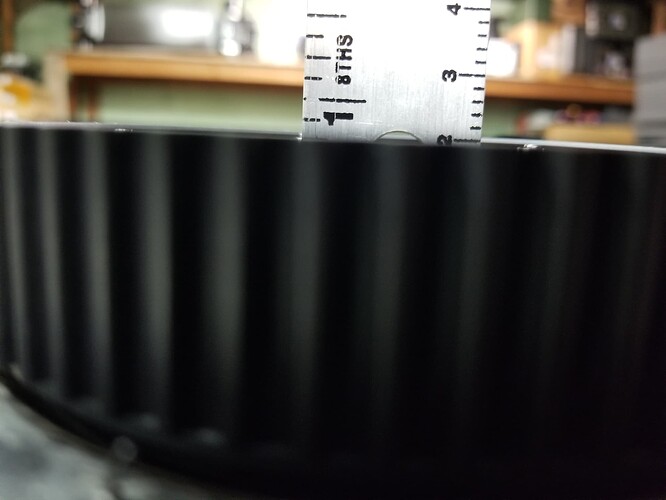

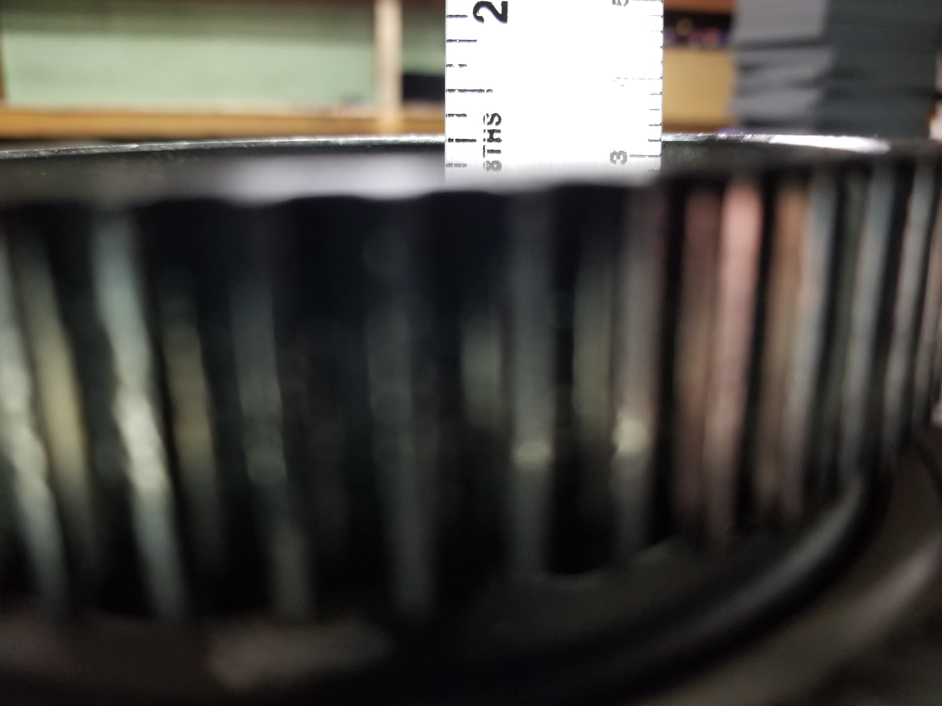

Let’s measure the offset just for the heck of it. I measured from the face of the bearing to the outside edge of the pulley, like this:
The Idea pulleys have an offset of 20mm:
The Lacroix pulleys have an offset of 32-ish mm:
That’s a difference of 12mm, which is quite a bit! You can see what that difference looks like when I moved the XL Pro/Idea setup back onto the Haero Bro. Here are the wheels pushed all the way onto the axle:
Then I move the motor mounts 12mm closer to the edge of the hanger:
The tolerances already seemed way better when I tried rocking the wheels around, so I decided to take it for spin. And wow, happiness has been achieved.

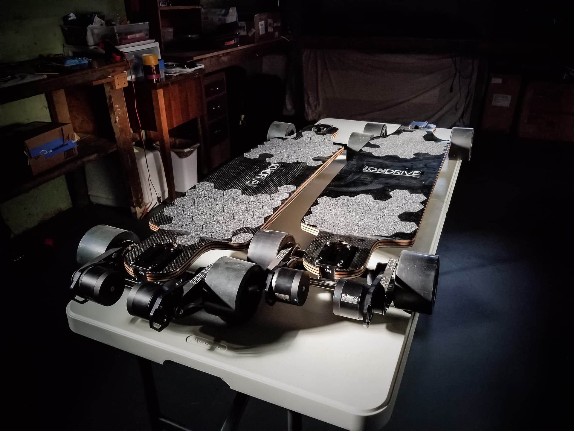

I now have two complete boards finished. One of them is getting ready to be packaged up for a trip south to @dskate for a video review some time this winter. There are four more rollers right behind these two. I’ll take some assembly photos of the last four when I make some more progress.

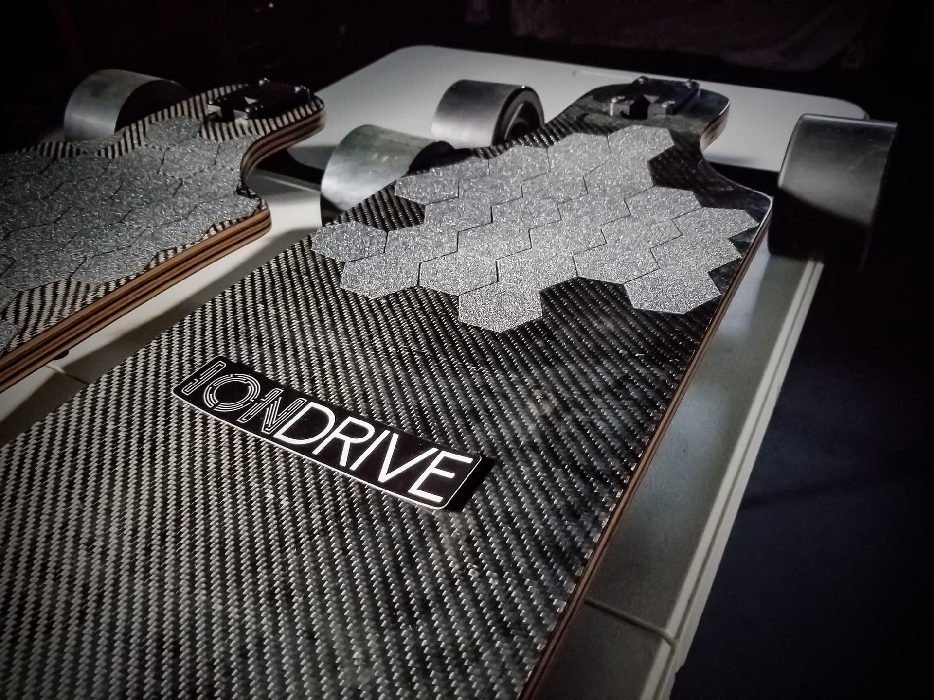

My wife helped me get some stickers made. Really happy with how the logo turned out.
Here are the two completed boards. Trying to decide if I should place the logo in a vertical or horizontal orientation.
Kinda leaning towards the horizontal orientation at the moment… Either way, I think the aesthetics are working out nicely.
Stickers look great! Go with horizontal for sure.
