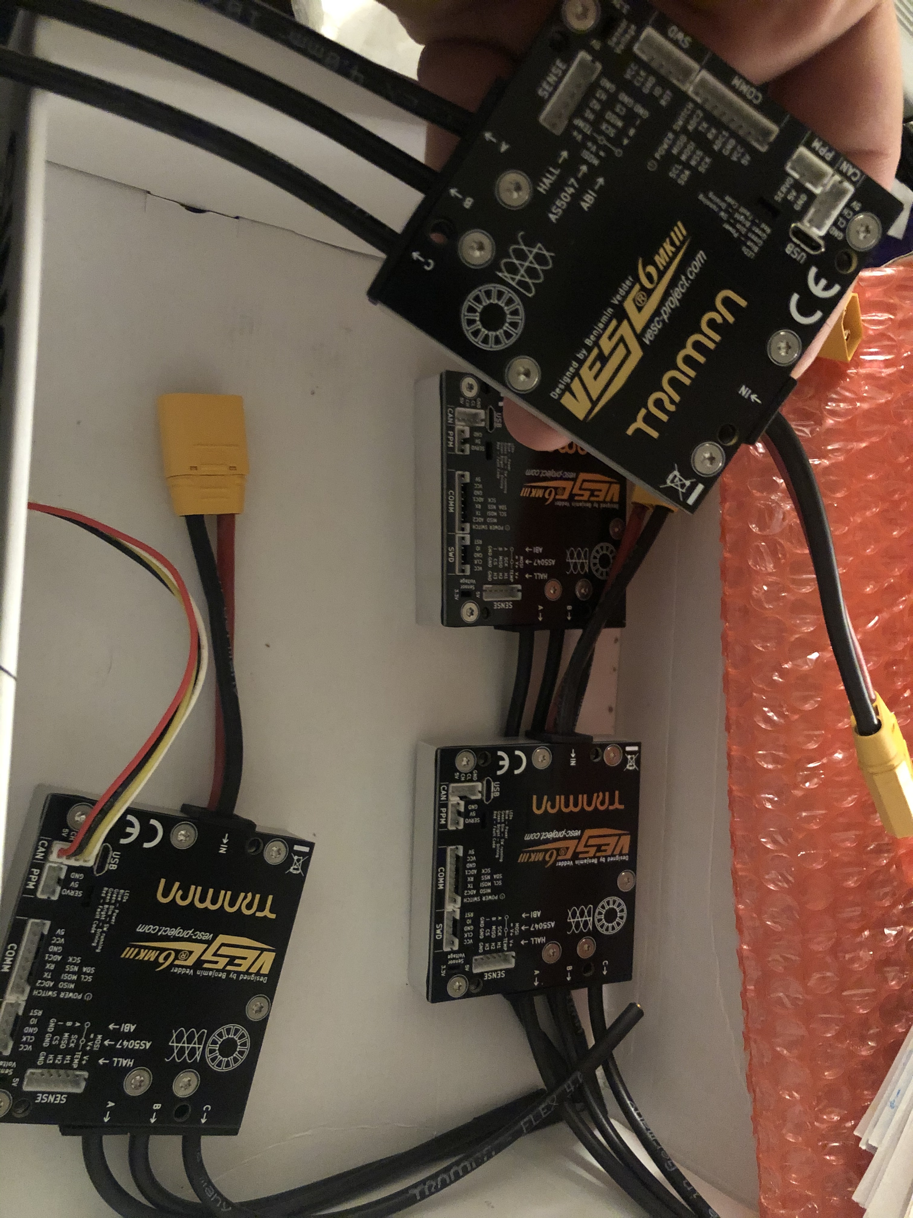

Vesc’s are in!

Distilled question :
Can I wire all four Vesc’s with CAN while still having a loop key for the front pair of vescs and a separate loop key for the rear pair of vescs? Or would a parallel loop key be the best option? My concerns are if there would be a problem because one pair of vescs would power on before the other pair (As I would need to insert the 2 keys and there is no way I can power the two sets on at the same instance.
This is the whole “this is why lowside switching is trash” thing. Put the loopkey on the positive wire and it will be fine.
Not sure if CAN will still work properly considering the termination resistance is going to be all wonky on a 4WD setup.
power wise, as long as loop key is on +vbat, there is no problem.
software wise, i dont know if the vesc fw will detect esc’s coming online afterwards.
most likely it will be fine as long as the master esc is powered up last. the slave esc’s will just chill until they get a signal.
this is somewhere where experimentation is probably your freind.
Slave VESC’s periodically ping the CANbus with their device ID, the master then forwards the control command to them. (Honestly, this is poor message structuring, but whatever.)
You could also use four receivers. :smile: Then switching on won’t be a problem and you don’t fry other VESCs if one dies (that can happen with CAN).
Okay thank you. I appreciate both of your input @Gamer43 and @Teslafly
So I think to just be safe, I will go with parallel loop keys. I don’t think it would be wise to run just RWD if the board was tuned to run in 4WD anyway.
