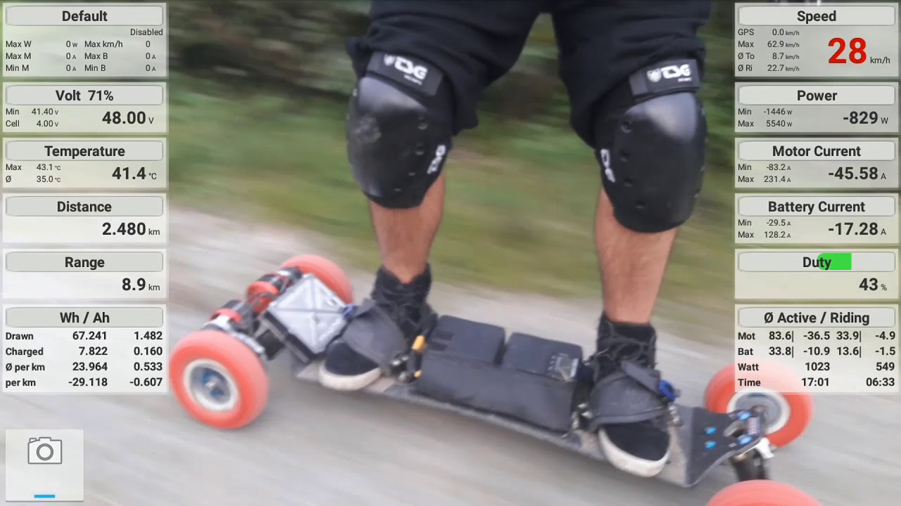

In this video you see numbers of power, from ackmaniac app, 8072 on VESC6 noLIMIT FW
never done some math on gears, in generell the M2 gear is not a oversized ISO-06 Chain, that means that failures from loose screws or wrong adjustmend will end with stripped gears, thats the price for very compact design, but as i said in beginning it holds up very well if very well adjusted … customers running setups with 80100 or 8085 or MAX6 high torque ESC for years, yeh thats my NUMBERS

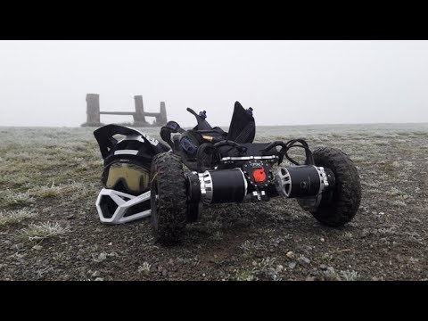

Well i´m also interrested in @Chibatterysystems pictures … i think its pretty possible because a 8085 can be fitted with APS 80MM Geardrive without problems, bara uses Truckextensions wich give you around 50mm more width, so enough for 80100 … by myself i used a extendet Trampa Truck(100MM plus) to fit my 80100 even with a FX Steering Damper between the Motors, documented here in this VID :
If that in the video is +10cm and @Chibatterysystems has +5cm with a visible gap in between the motors, it looks like the 80100 will fit without any extension?
Nope 80100 will NOT fit on a regular Trampa 16Inch MTB Truck with our Geardrives.
