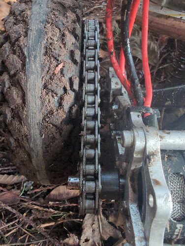

Like this?
Theyre still flapping in the breeze. For this method to be effective, the wires need to travel along the hanger from the mount to the baseplate and then ideally up behind the baseplate to the deck.
There should be no ‘wire in mid air’ action
The wires should be behind the hanger and behind the baseplate so that it becomes almost impossible for them to be struck by debris from the front
Keeping them as close as possible to the baseplate also greatly reduces any movement/flex/fatigue in the wire/joints
Not really enough length for that, and not really any to spare inside the ESC case.
Unless I have the wires from the solo come straight out the glands and connect them externally…

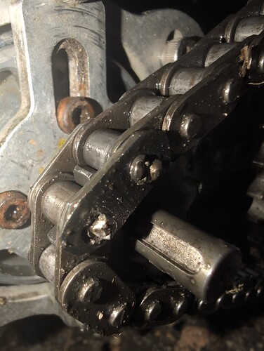

So I uhh… Lost the circlip and plate for one of my master links.
@Facko is there a wai I can move one of the other links over from the other chain? Or do I have to wait on new master links before I ride?
@tech.shit i would move big sprocket min.2mm more out of tire. It is very close. And Iam afraid,You need have new master link for 06B chain. Or if You have some 06B chain and riveting tool , You should be able fix it. But I would not risk to use some short time solution.
