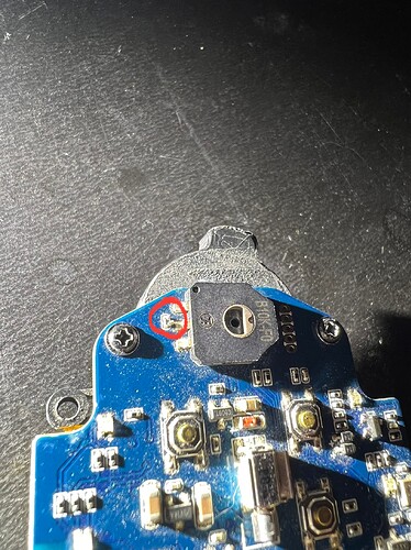

@jack.luis thoughts on what this may be? Looks blown, but not entirely from an electrical perspective. No noticeable problems stemming from it, just noticed during a tear down for other reasons.
Send that back to us, we will fix it for free

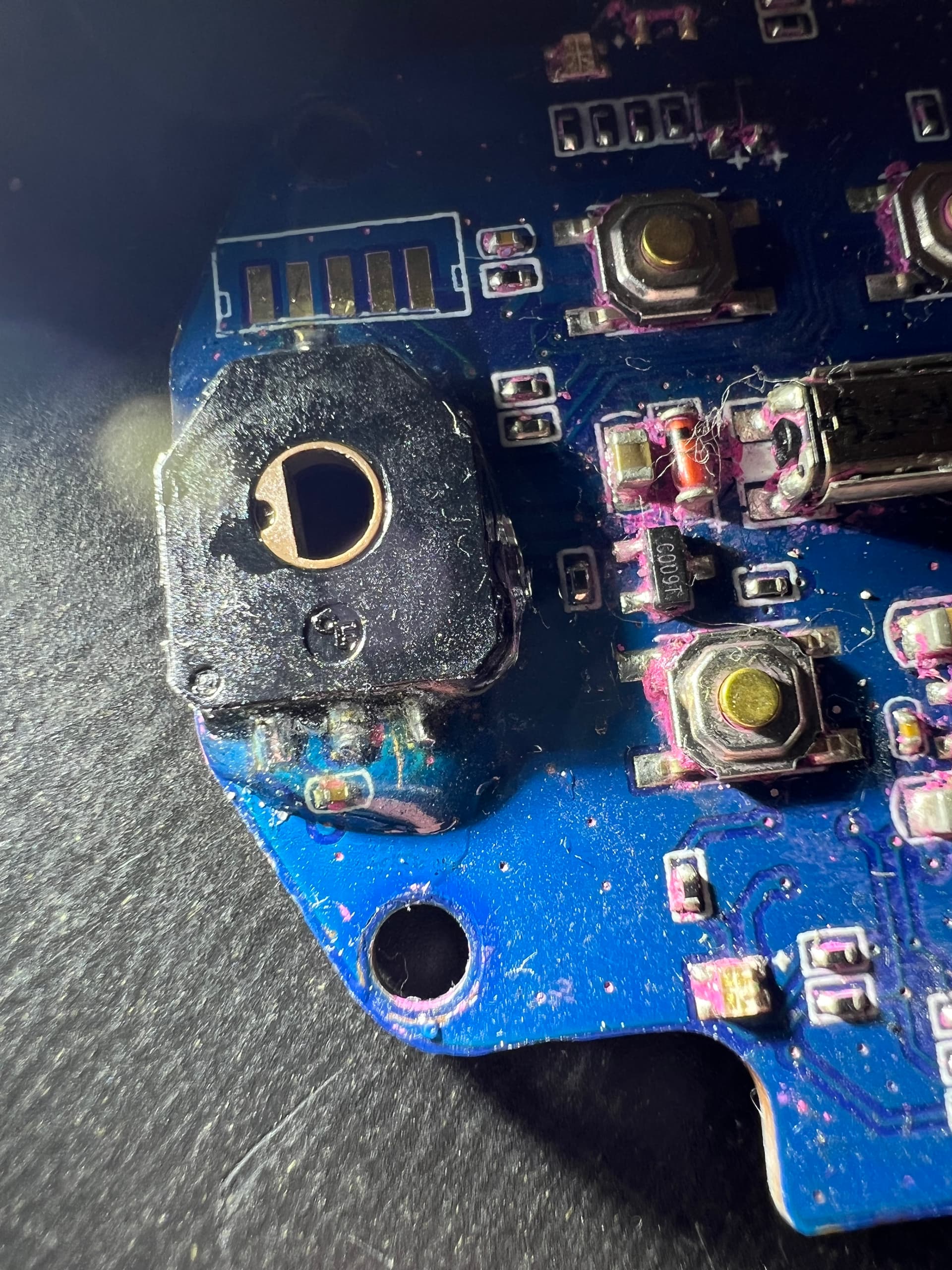

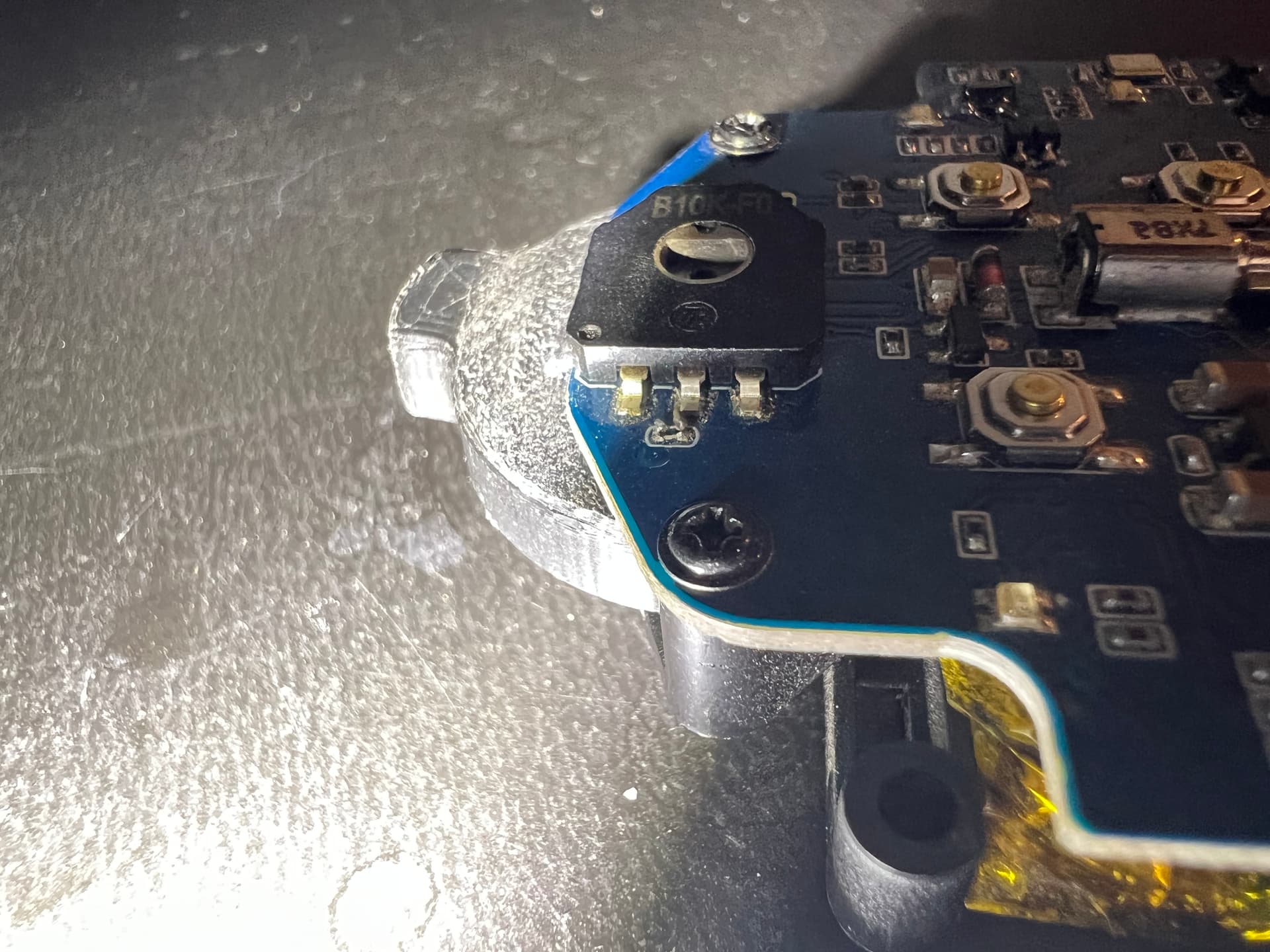

So, it’s not the potentiometer leads. I’ve already reinforced all of those long ago (edit - have reinforced pot leads on other remotes, just realized this is one that hasn’t been yet & I snapped the pic of the diode in question before topping off the pot leads w/a hefty dose of solder. I assure you they are well solder blobbed & reinforced at this point). This is the very small diode(?) that happens to be placed closely to the pot leads.
@jack.luis given the fact it’s not the potentiometer leads, but the tiny diode next to it - & that the remote is otherwise working completely fine, I’m not too worried but do appreciate the offer.

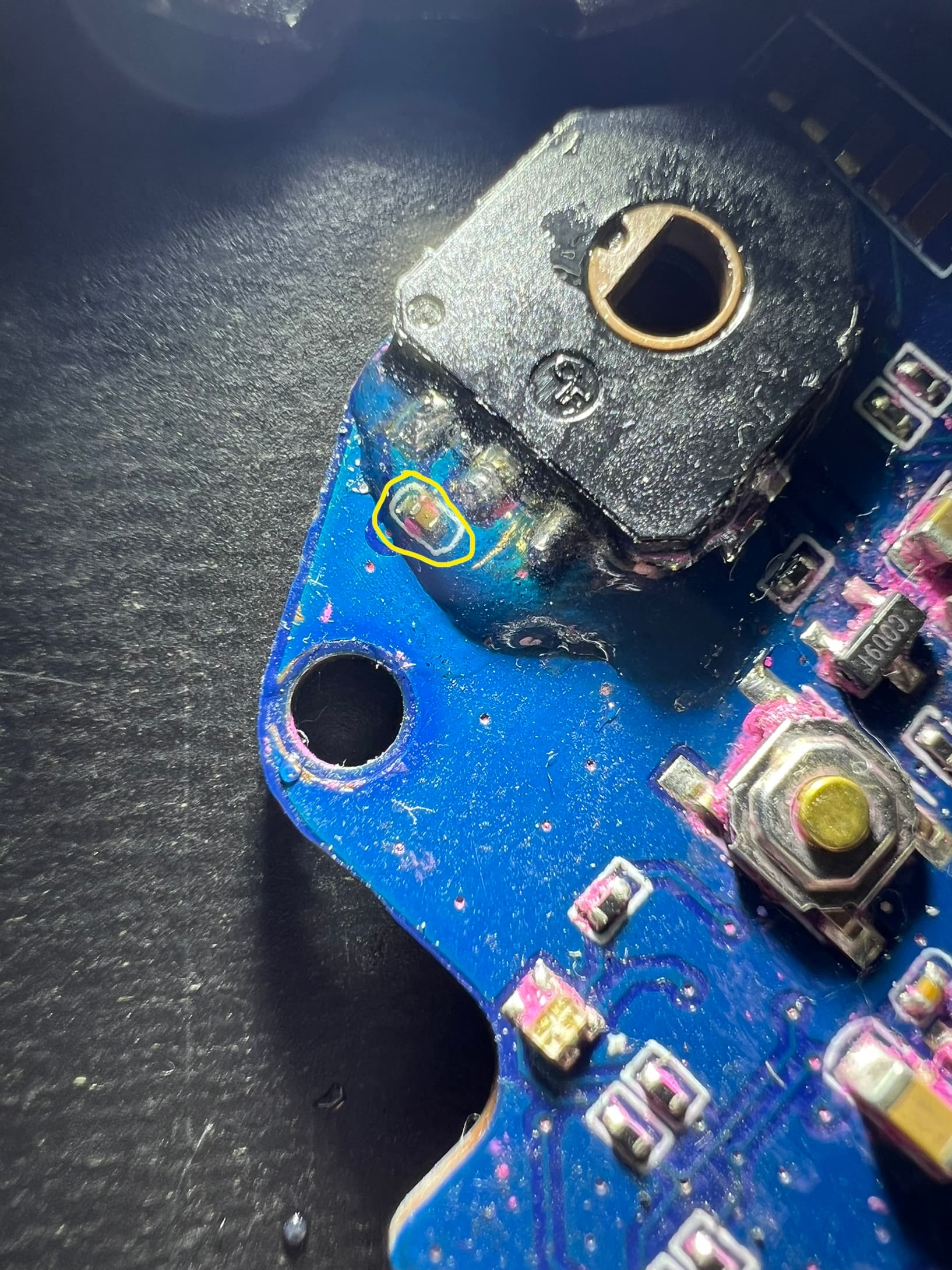

I’m just curious as to what the diode does (& possibly its part number for digikey/mouser) in the circuit & what may have made it blow.

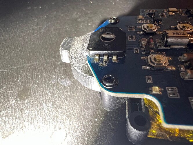

Waaay the fuck back I opened up my shell for other reasons & happened to find 3 of the larger black pcb diodes floating around, from being mechanically displaced from their solder pads for whoever knows why/how long. Everything was working fine without them too :stuck_out_tongue:
Edit: or wait, am I being dumb & its not a diode, but just a pad that needs solder bridging it for whatever reasons? Didn’t look at it under a magnifying glass.
Oh no. Looks like drunk somebody let pot reinforcing epoxy (after solder, ofc) spill over onto whatever the thingy I’m referring to is. Probably nbd at this point.
