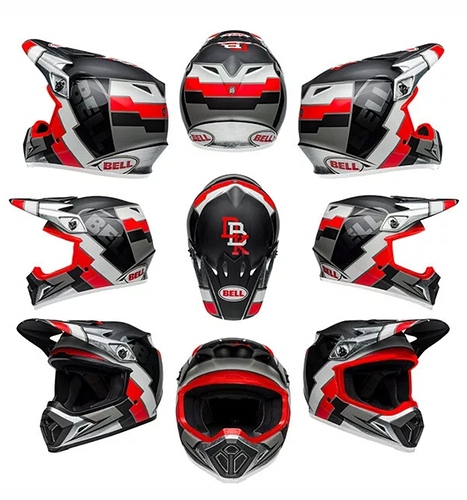

And recently scored two new “Bell MX-9 MIPS Twitch Replica” helmets on eBay for me and my son for $70 and $35 respectively (MSRP $190), so I’m quite stoked on that! This is the only motorcycle helmet in my collection and the helmet foam is literally twice as thick as my other helmets, so this will probably be my new choice for speed runs.
