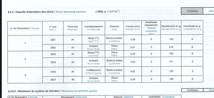

Its rated to 5kmh chrashes with the NF EN 1078+A1:02 you can check the certification specs pdf
Amd yes it has the astm f1952 rating but I couldnt find any info on how they tested it and the numbers on it…
I didnt say any false info, i just said what I could find on the internet
If it passes one cerfitication thats up to 5kmh, the other one cant be some thats 100kmh…

That’s the thing with the ASTM F1952 certification, it’s either certified or not, you won’t find any info on how because it’s not documented.
EN 1078 tests at 5-5.5m/s which is approximately 18km/h
Most motorcycle standards test at approximately 7.5m/s.
Its documented, how would testing agents even know know to test the helmets if it was not…
It just that you need to pay to see it…
Unless knowing the numbers its useless unless you fully trust it
But since there are a gazzilion of certifications out there id like to see numbers…
It’s 5m/s, not km/h. That’s just the certification, that says nothing about the speed the manufacturer used in it’s own test. For the ASTM F1952 certification only the chin bar of a full face helmet is tested. It’s either a pass or a fail, hence there is nothing else to document.
Wow! 126g deceleration against a curb after artificial aging. Burly test.
