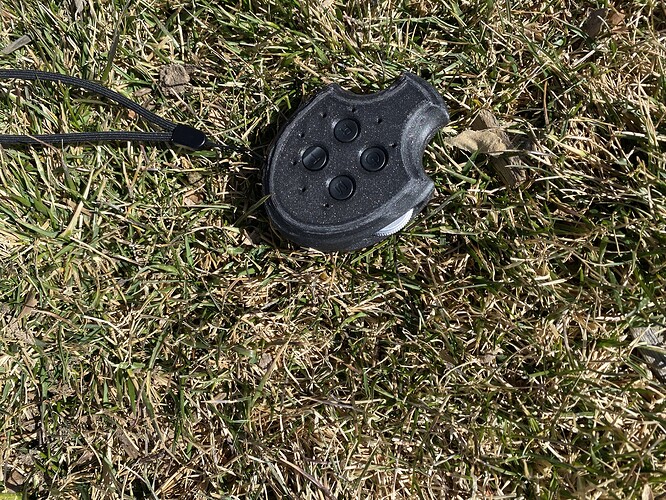

After further testing the duty cycle did not fix the issue. What’s good, is that it helped me recreate it with no load. Before, only if I slammed throttle in grass would this happen. After changing duty cycle start limit to 85/95 max, it now happens on payment, and I believe with no load as well.
From what I gather maybe this is intended function, but here’s a video. Maxing throttle and the board will cut out.
Normal?
Video aint loading, its audio only. Try uploading it to youtube and sharing a link.
You changed the setting called “Duty Cycle Current Limit Start” right? Not the actual duty cycle setting?
Isn’t much from video, just shows me holding down the throttle and the board ramping down while it’s still full throttle on the puck.
Yes!
Further, when looking at RT data in VESC tool the duty cycle hits 90% for 3-5 secs and then the Unity kills power.
Ahghfhskfe!
Now I’m confused. I flashed the unity to FW 23.46 and now I don’t have any of the above issues. In grass, slam throttle, all good. On bench, hold throttle, all good.
Even some of my Davega issues have been fixed. I can’t control the screen with my remote anymore. Only sporadic screen changes when at a complete stop and some memory issues. Sad the 4.0 update to resolve that won’t work on 23.46…
Any ideas? It’s got to be something I had set incorrect in the VESC tool? Or this unity just don’t like v5.1.

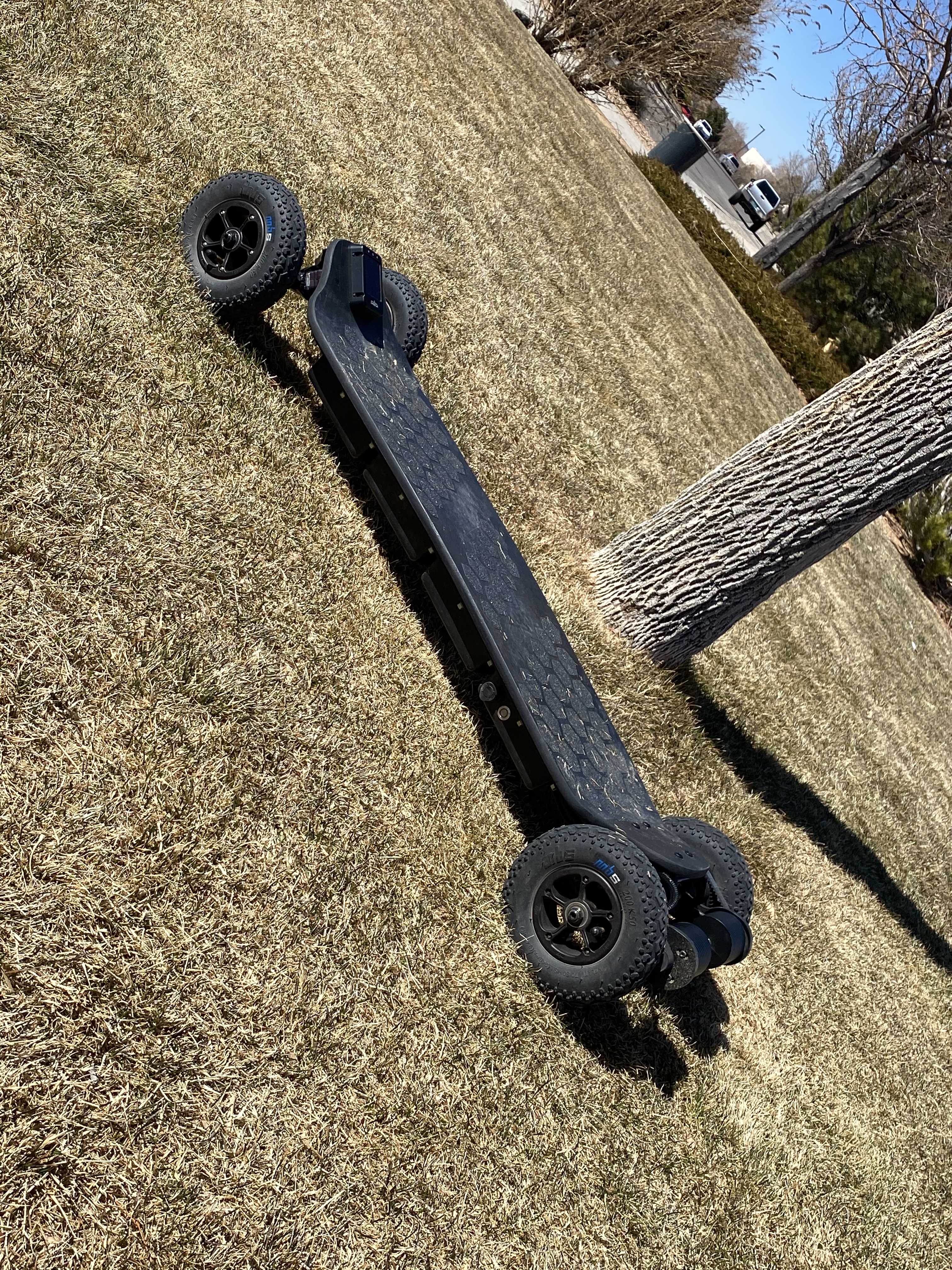

Update: Just hit 150 miles today on this guy! Yellow/Yellow blocks.
Decided to dip the shocks and hubs in black Rit to murder it out.
Board and Shocks are starting to break in and I can really start getting it on the carves!
Oh I also printed a Puck Puck Bruce! Not the prettiest print as it is quite difficult, but man is it comfortable!
Getting about 30 miles a charge on a 25.1wh/mile average.
