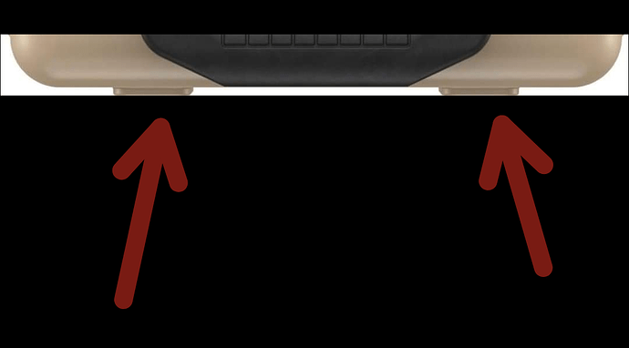

The dw2 is the only mbs deck that has asymmetrical concave. My top mount enclosure fit @flasher’s colt 90 deck well and the markone deck with no issue but definitely has more gap on the dw2.
@Venom121212 I should have been a bit precise. My case isn’t flush but thats the case’s fault. It has 2 long pads on the bottom and they’re where most of the contact is made
Ahh gotcha. Can you get a photo?
I wonder if you could just get a rubber sheet of equal thickness or slightly thicker and cut it to fit
That’s the plan :joy:
Now the problem lies in the velcro I put there…it’s kinda stuck :stuck_out_tongue_closed_eyes:
Hmm maybe a 3d printed piece that slips on there and bolts to the box? Then keep the velcro haha
I’m thinking possibly the opposite. A print that I place on the board to fill the gap and help lock the case’s position more precisely.

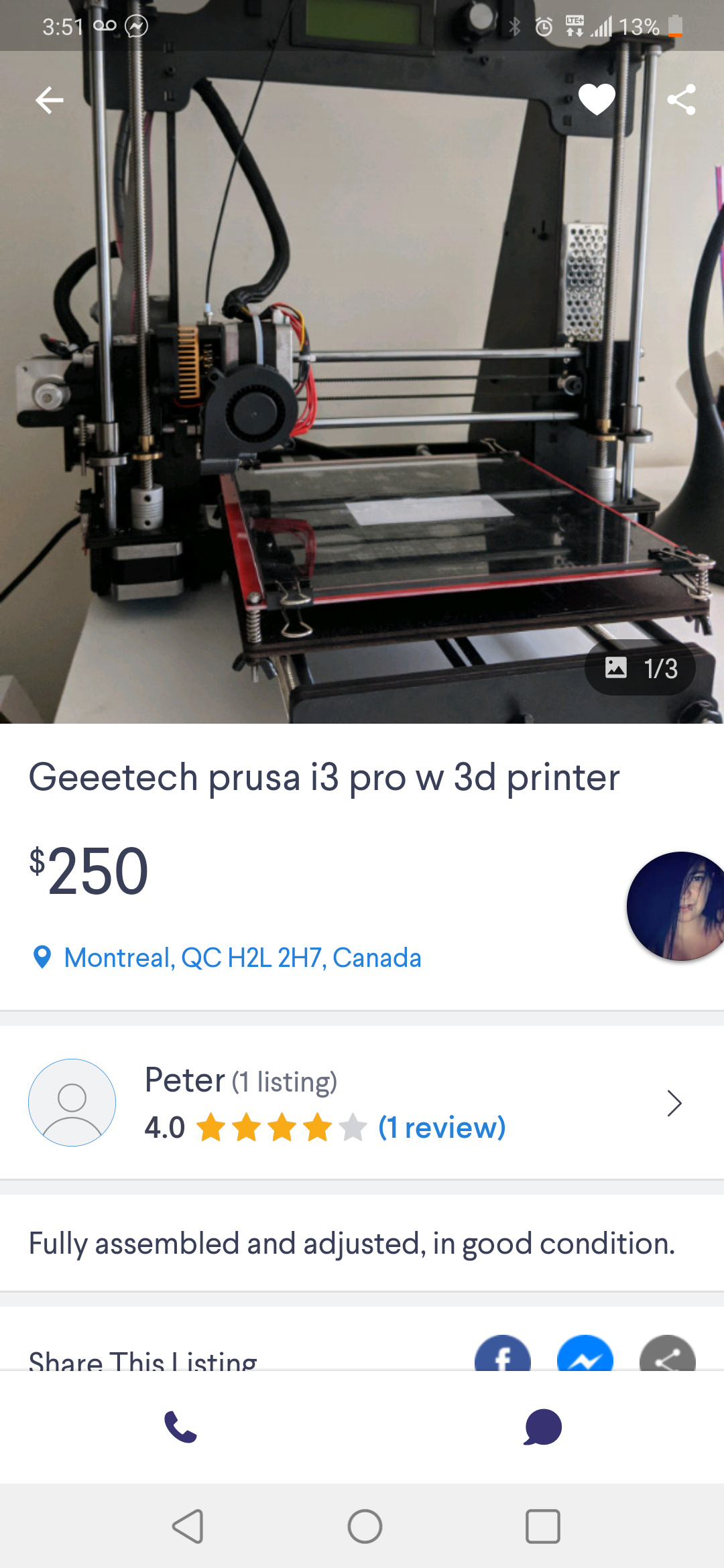

Oh and btw in about 25 minutes this is mine

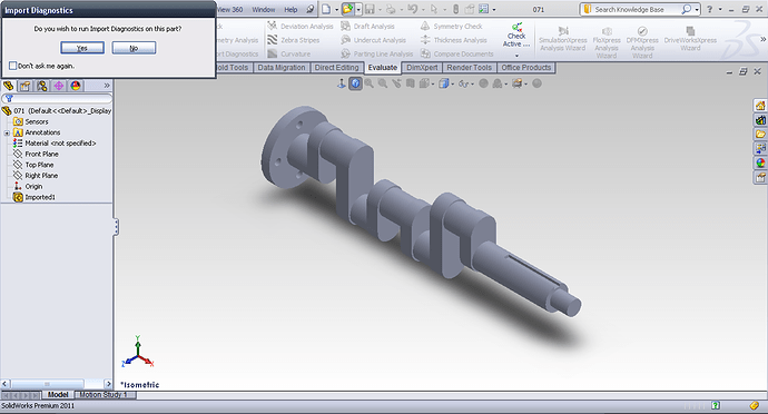

Step files are the next most common. They give more dimensional characteristics to a file but not all the steps the creator took. Think ikea instructions with text and parts labeled.
(see how it just has it as one big part, “imported” on the left)

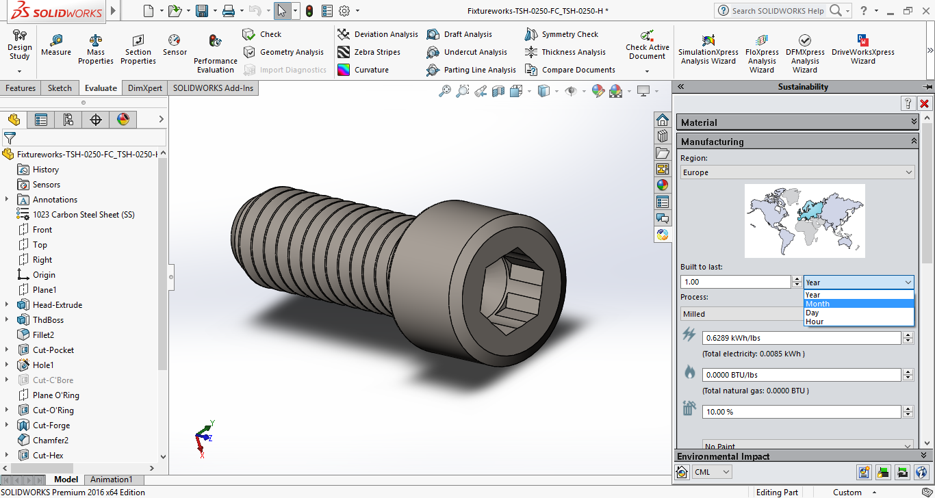

Finally there are the files made natively by the cad software. Solidworks software makes solid part (sldprt) files for example. This will tell the user exactly how the part was designed step by step.
(see how it has the head, the threads, the hole, all separated)

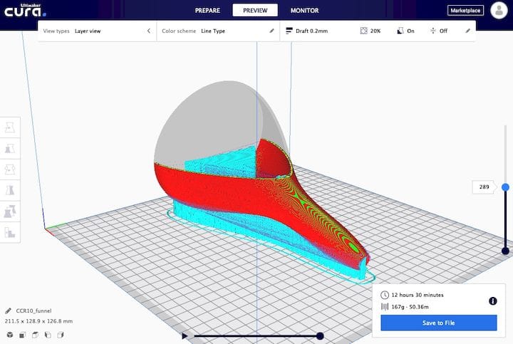

Your slicer generally wants stl files. So when I go to make something to print, I make the sldprt file in solidworks, save it as an stl, open it in cura (my slicer), load one of my printing profiles (35% infill, no support, layer height, blah blah blah), and hit slice. It generates the gcode file and allows you to preview the exact path the printer will take layer by layer. You save it to wherever you want and copy it over to your SD card and it’s ready to go.
