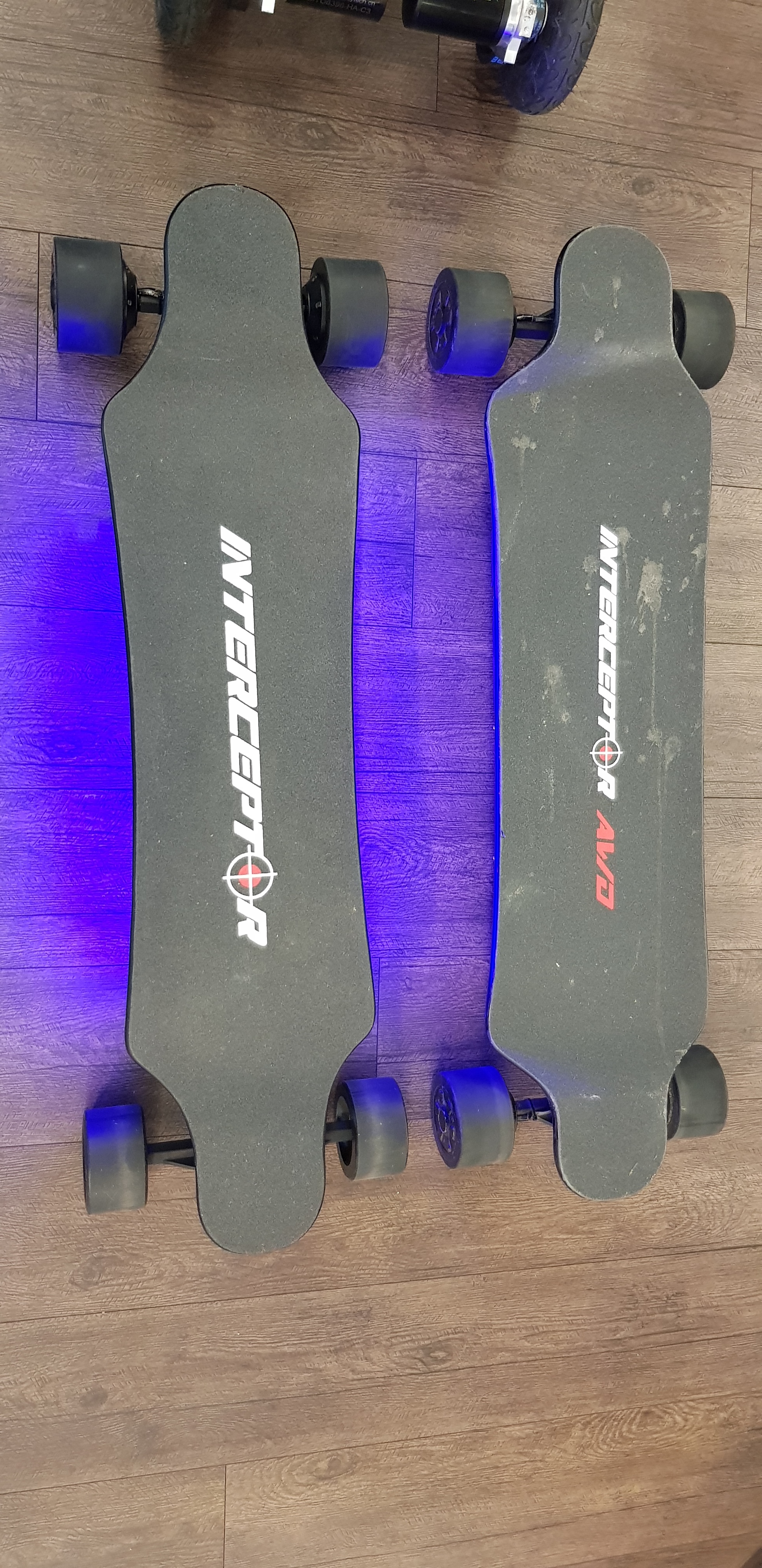

As an new ESK8 manufacturer we did our research on the market last year and we came to the conclusion, that range is the most important factor for a successful e-board. Due to boosteds lack of range they are not suitable for extended group rides, which for most is the single most important criteria. If the board doesn’t have the range und you can’t keep up with your friends, you won’t buy that board. This is why we decided to use big batteries in our Intercepors and offer 60km of range with our small and 120km with our big battery. Nothing is more convenient than accomplishing the whole group ride without charging or swapping your battery. Careless riding without experiencing range anxiety is what everyone wants, because this hobby is all about freedom and community.
Boosted didn’t get this. They just used the hype and the attention they got through Casey Neistat and sold a lot of boards, until boosted board became a synonym for electric skateboards. Now, most people know, that there are other brands out there and they start to compare specs and see, that they can get way more for less money. Nowadays it’s a nobrainer to not buy boosted and go for another brand with more range, more power and a smaller price tag instead.

There are multiple reason speaking against swappable batteries.
  1. You need to carry the battery around in your pack back instead of it carries by itself.
  2. to get the same amount of capacity form 2 batteries instead of 1, you need more volume and more weight.
  3. the swap mechanism can cause fails.
  4. to designe and engineer this system is more complicated and more expensive than just a bigger battery.
  5. It’s more expensive for the customer to order an additional spare battery afterwards and maybe pay additional shipping than get it in the first place.
The charging time is not a point. we deliver our boards with fast chargers which charge the batteries in similar times than small batteries.
The extra weight is a point indeed. But we think it’s worth it. You get for each additional kg 15km-20km more range.
Light and small boards to pop against curbs is not the average group riders choice. For that purpose you can choose mini boards.
For regular group riders are range and power more important. we figured out, that 50km of range and about 50km/h of top speed is what 60%-70% of riders want. About 20% wants more of both and just about 10%-20% would be satisfied with less.
So to get back to topic, if you take boosted, they satisfy just 10%-20% of the riders. Back in the days it was more like 80%-90%.
But riders and pretensions evolved, but boosted didn’t.

We are taking pre orders for the Jetforce Interceptor this month.

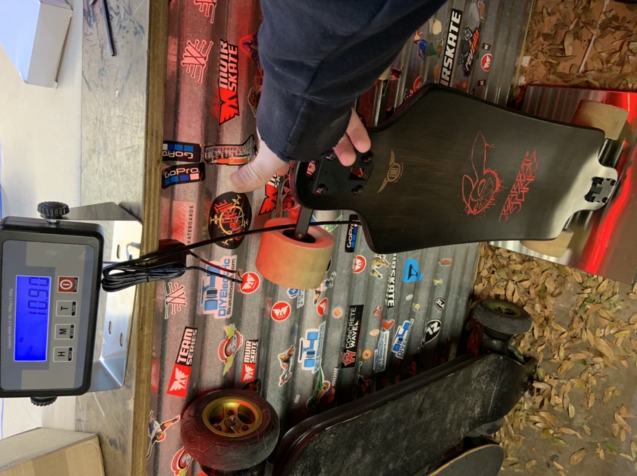

For weight to power/range reference: 12S4P 30Q, unity, and 75KV TB DDs on boas.
Murder a boosted all day long.
