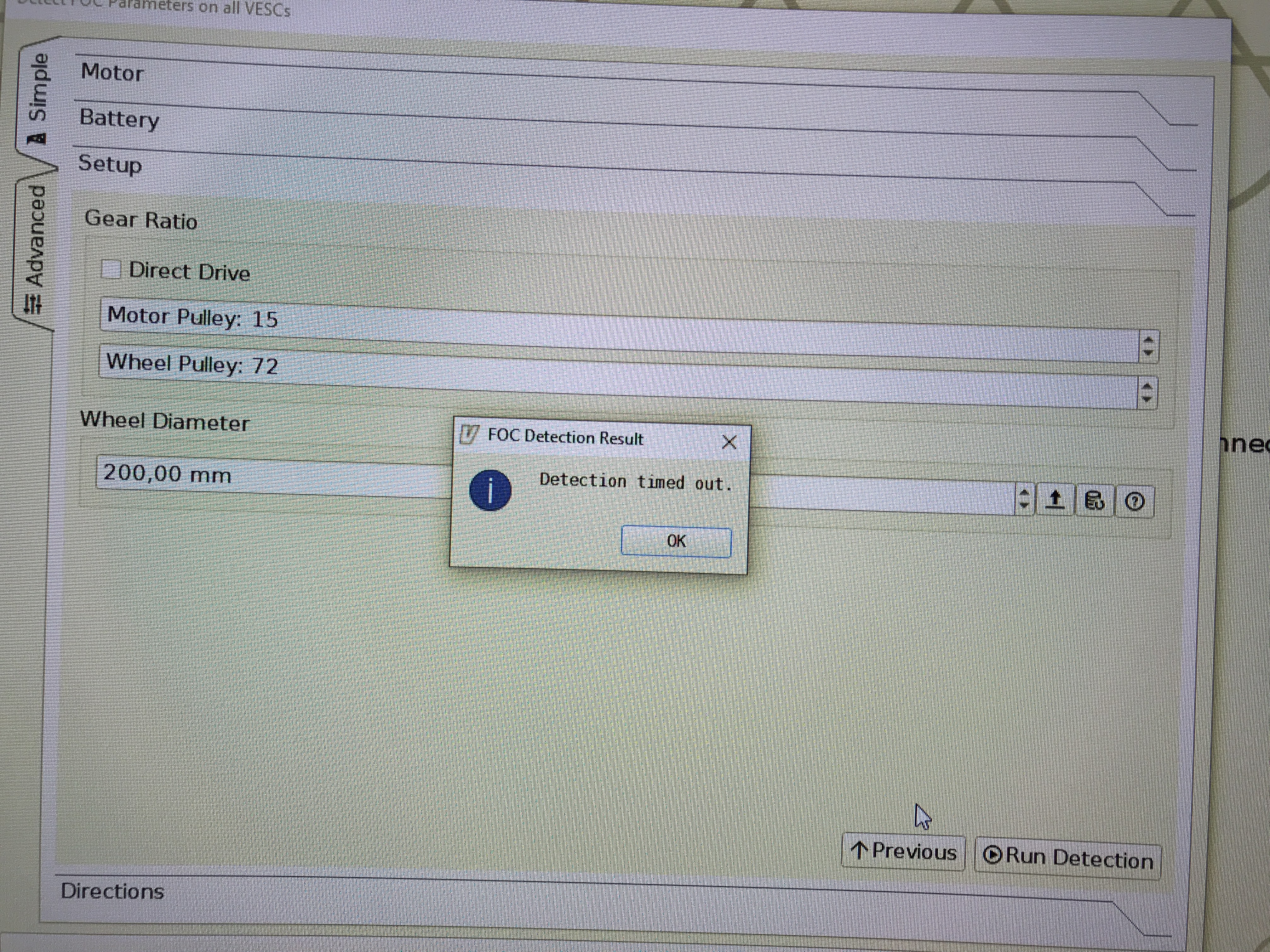

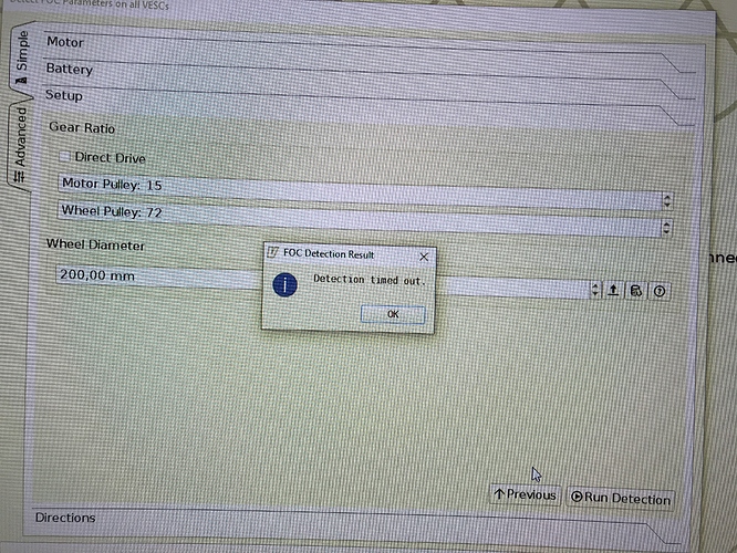

Hey, I was wondering why would this happen?
I was trying to do a motor detection using the metr pro using tpc bridge.
I am using focboxes on version 3.62 with vesc tool 1.25
Motor detection goes fine and everything? But at the end it loads indefinitely and doesn’t bring back any data on the screen.

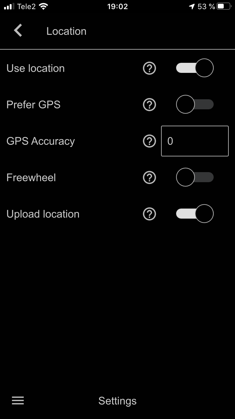

Another issue, @rpasichnyk I get this bug, when I use the board it wouldn’t record a first bit of the trip, and jump straight to a random point, and then it decides to record the GPS.
Set GPS accuracy to 50
