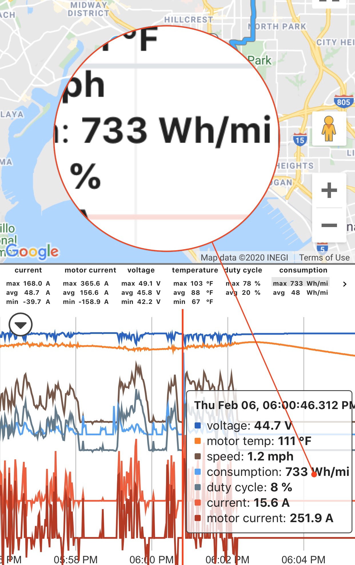

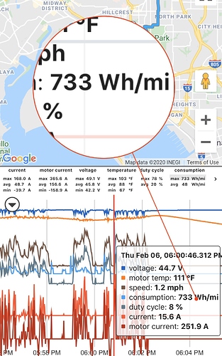

Are these wh/mi spikes artifact or suggestive of underlying actual badness? Is there a metr setting I adjust to minimize this?
