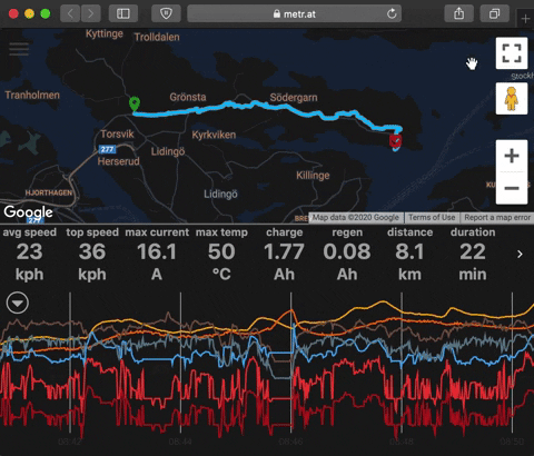

Is there any way to view uploads with the Map in full screen? Perhaps another ?format=map URL option in the future? :upside_down_face:
Just a map? Maybe leave stats bar and map? Only map sounds too boring.
That would be perfect… it would be a lot cleaner for sharing a single image.
I added maximize map button

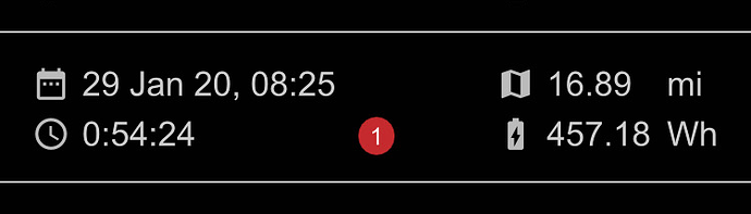

what does this red circle with a 1 mean in records? Does it mean a vesc vault was recorded? I did experience a vesc vault on this trip and another where this red 1 shows up.
The faults do not show up in my metr app faults page. The fault happened on an alternate VESC connected via CAN. and I have “Dual Data” enabled under “magic” Should I expect faults on the other VESC to be recorded by metr?

I used “can fwd” for a moment. and the faults on the other VESC got sucked into the metr app faults page. they have a timestamp of when the app connected to the other vesc. rather than when they actually happened. which makes sense. vesc doesn’t have a clock to timestamp faults.
so I conclude from that that even with “dual vesc” the faults are only recorded from the actively connected one and not the vesc over can bus.

Oh, thanks, I will fix that to query all VESCs when FAULT happens.
