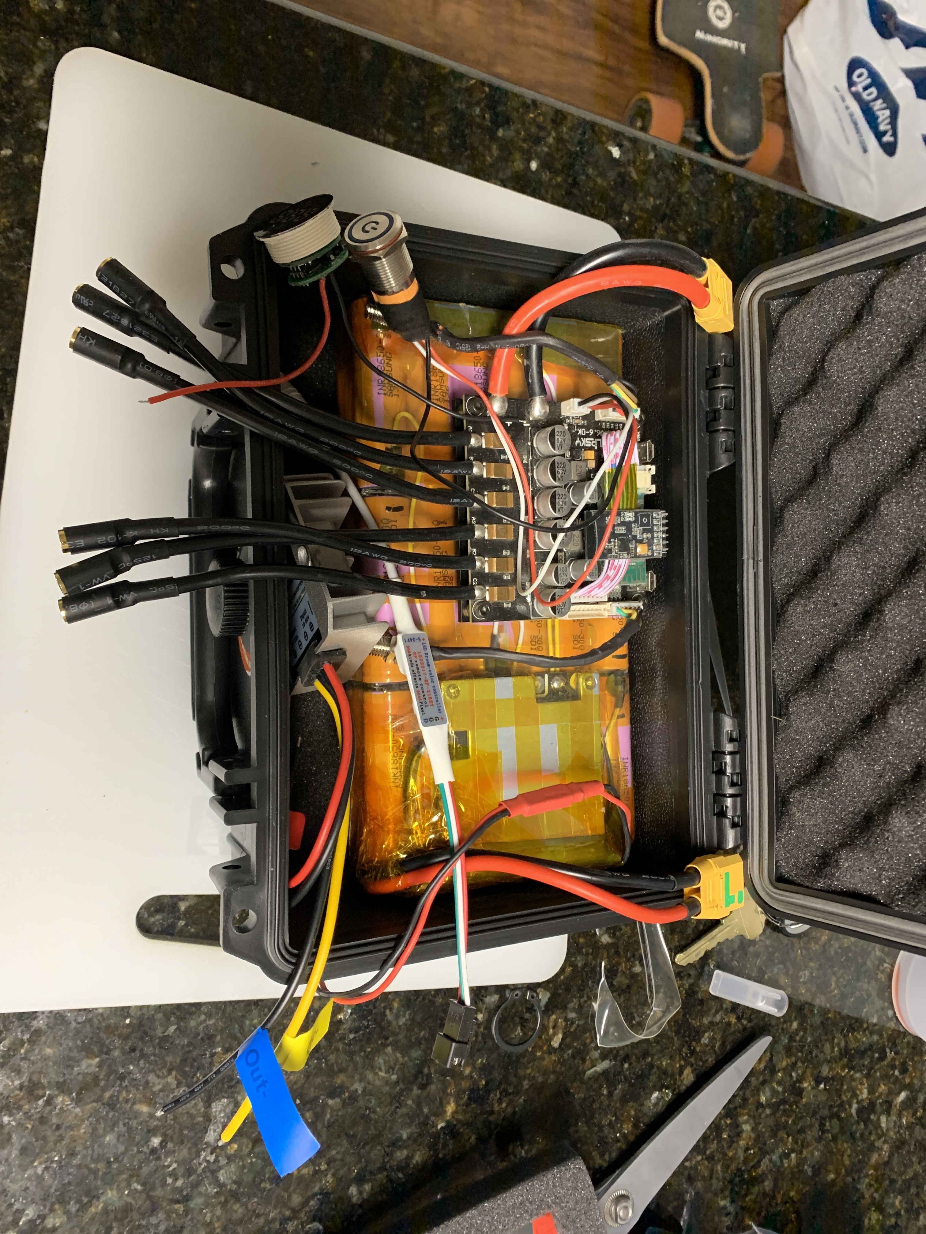

I’ve had some issues with my METR dropping connection all the time. What can I do about it? I went a known 12.8 miles and only recorded 7.5 miles…less than 60% tracking rate
My phone is an iPhone XR and it’s in my jeans pocket so that side of the connection is probably stable, and the METR is sitting ontop of my ESC in a top mounted plastic box so it’s not like there’s anything blocking the signal
Since the VX1 remote keeps a steady signal I’m assuming the ESC is staying powered the whole time too, it always a Bluetooth disconnect and never a low voltage alert
I trimmed the wires but I’ve always had these connection issues before cutting them short. The module is taped under the VX1 receiver, it’s gonna nice nested space between the headers and caps
Maybe I can connect a wire as an antenna to boost the signal?
Pic of the setup.
It’s on top of the vesc under a RF receiver. I’m not you could create more interference if if you tried.
Move the RX to in side if the vesc and the METR to the other, at least an inche between vesc and both modules.
Is there a way to attach an antenna to the METR? Once all the electronic components placed in the enclosed I’m planning to shrink wrap them all
Nope, you have to order it with the antenna. It has to be a very specific length, resistance, etc.
Ugh… What’s the chance I can get it kinda cheap if I as nicely in Parts Wanted?
Unlikely. Very few METR’s see the used market. Ask in the METR thread.
