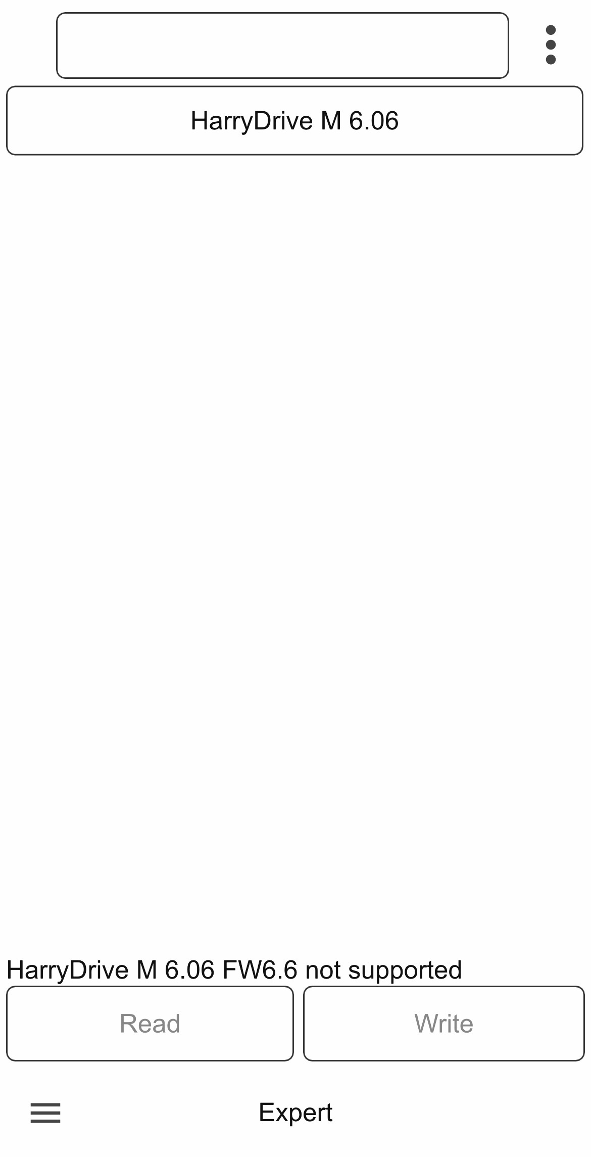

Ist there a way to get support for fw 6.06 in an old metr pro uart. I know it is old and has been supported for a long time. It still works and I like the small form factor. It does work for RT data and logging to my phone, but I can’t use “modes” as it says it does not support fw 6.06. I can also use vesc tool connected over BT to metr pro uart to set params. Would just be convenient to use modes for different setups.
