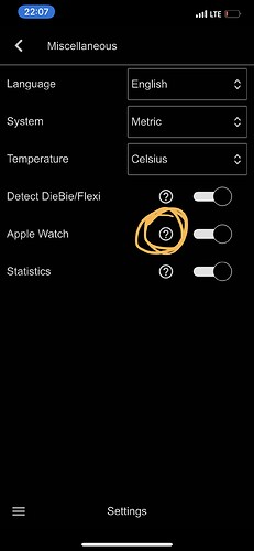

I have trouble connecting apple watch 7 with metr app from iPhone.
In the app I’ve turned on option to sync real-time data with the apple watch. But all values at the watch are 0. Iphone app is working as it should.
Am i missing something?
  1. Connect to your board
  2. On the Realtime tab, long press anywhere and click on small watch icons to select which data to send
Thanks. It would be great if that info were to be shown here.

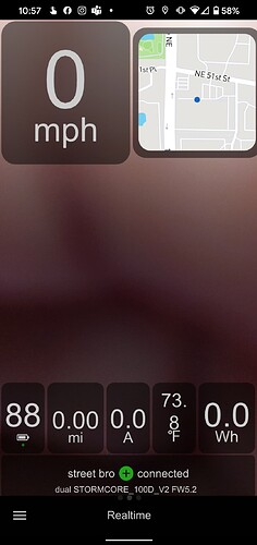

Question I’m a little bit stuck on here, I have a smart BMS, and metr is able to connect on Bluetooth and see the cell voltages and everything! Super stoked! However, the total says 3% what do I have wrong?
