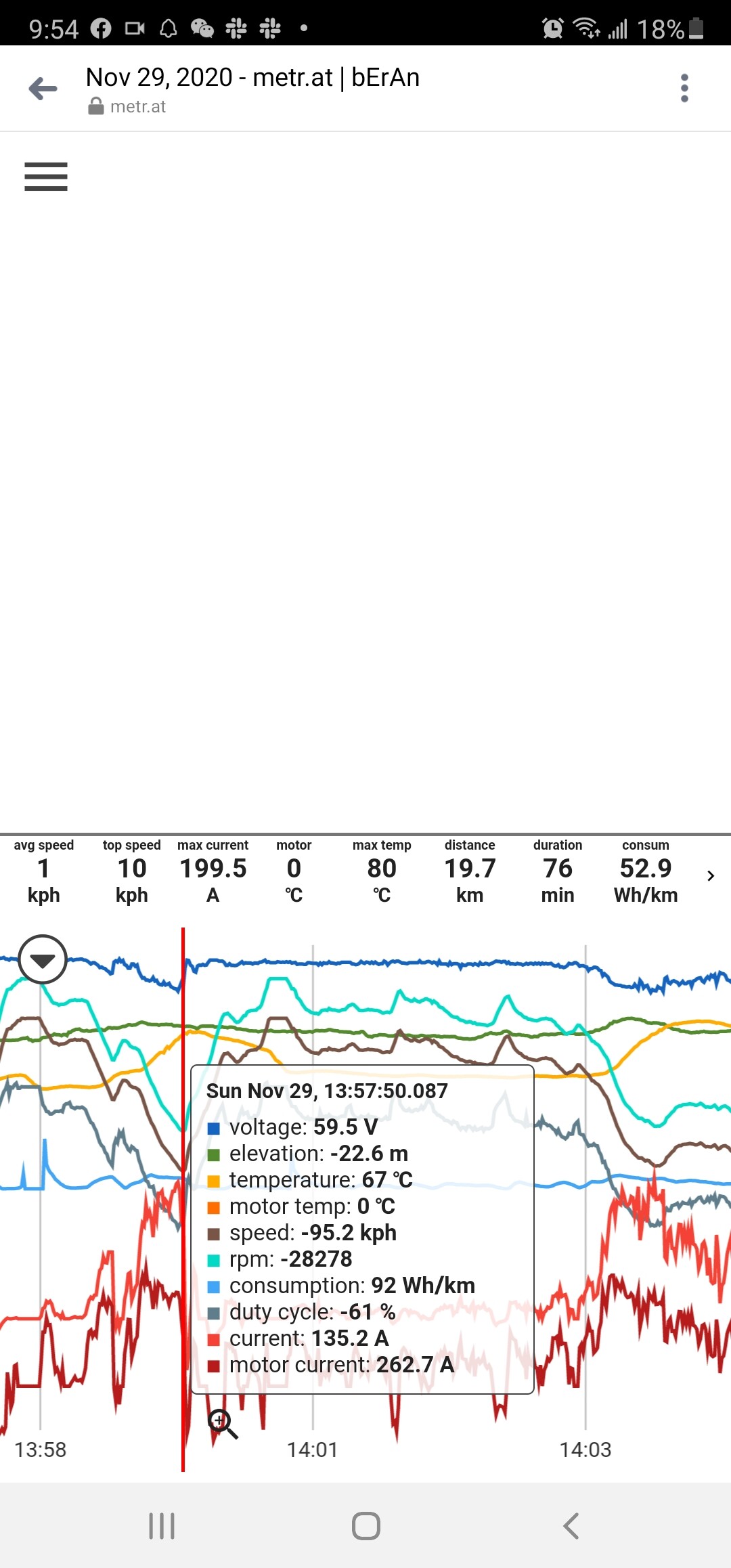

Question. What speed plots on the web link. Gps or uart speed .
Do you always get negative speed and duty cycle? Or do you switch between positive / negative?
By default it shows RPM calculated speed (not GPS).
Depends on how much interest there is for this feature. 99% of the users have PPM.

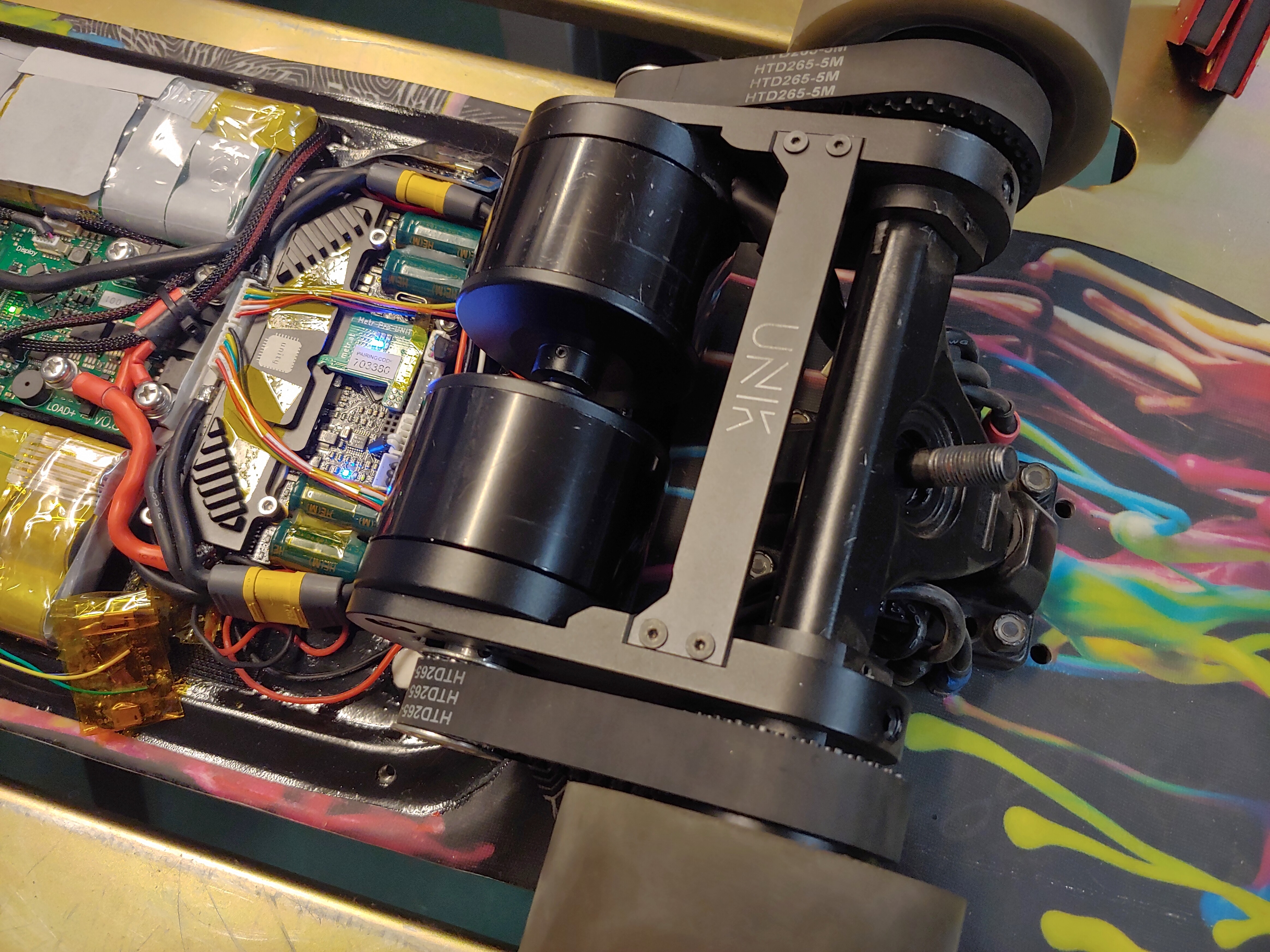

I’m having this weird behavior on my Metr Pro Unity where it maintains connection until I hit the throttle or brake on my Hoyt puck.
Is it possible its EMF related? My BLE module sits close to my motors.
What is your UNITY firmware? Might be this issue:
Well that sure was simple. Guess my Unity was on old firmware. I downloaded it direct through the android app to 23.44 and am now up and running. thank you
