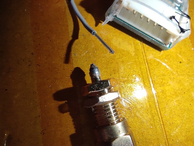

This happened. I just solder it back on, yes?
Guess it’s not an easy fix. Because it is a coax cable it has to be soldered on two spots, one the signal in the core and the shielding outside.

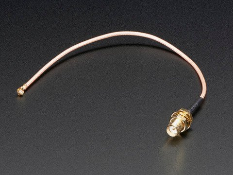

Probably easier to buy a new u.FL to SMA adapter
i assume this is good? they are all the same yeah?
where do you buy yours?

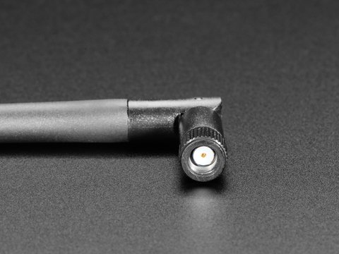

And as for the antenna, i’d love a right-angle one. What should i look for?
Yes, that adapter looks good.
For the antenna it is important that it is 2.4Ghz. You probably want a matching RP-SMA connector. For example this one should work.

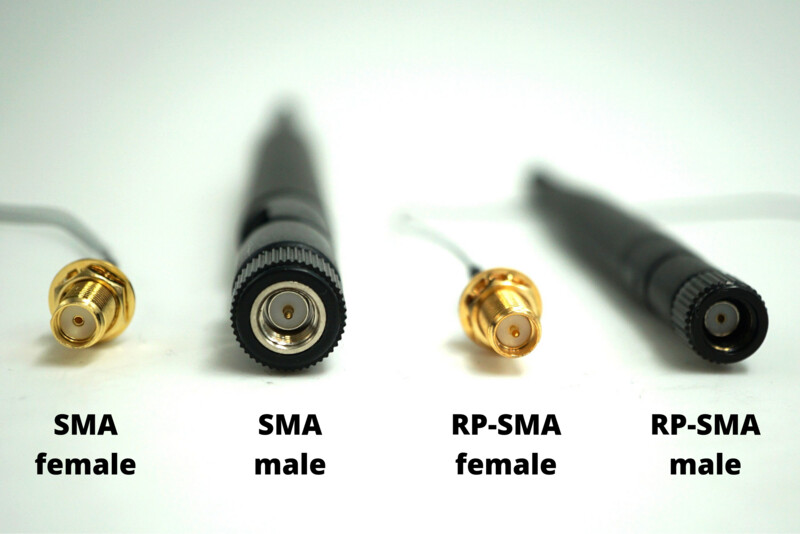

I need an RP-SMA or SMA?
What’s the difference?
Adafruit says they are not compatible, if I use for example, an RP-SMA antenna and a SMA cable.
The antenna you linked is RP-SMA and the cable I linked is SMA.
Sorry !:sweat_smile:
Please have a look at that picture. You need them from the same type.
We are using SMA for our external antennas, so the pin on the antenna part.
