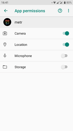

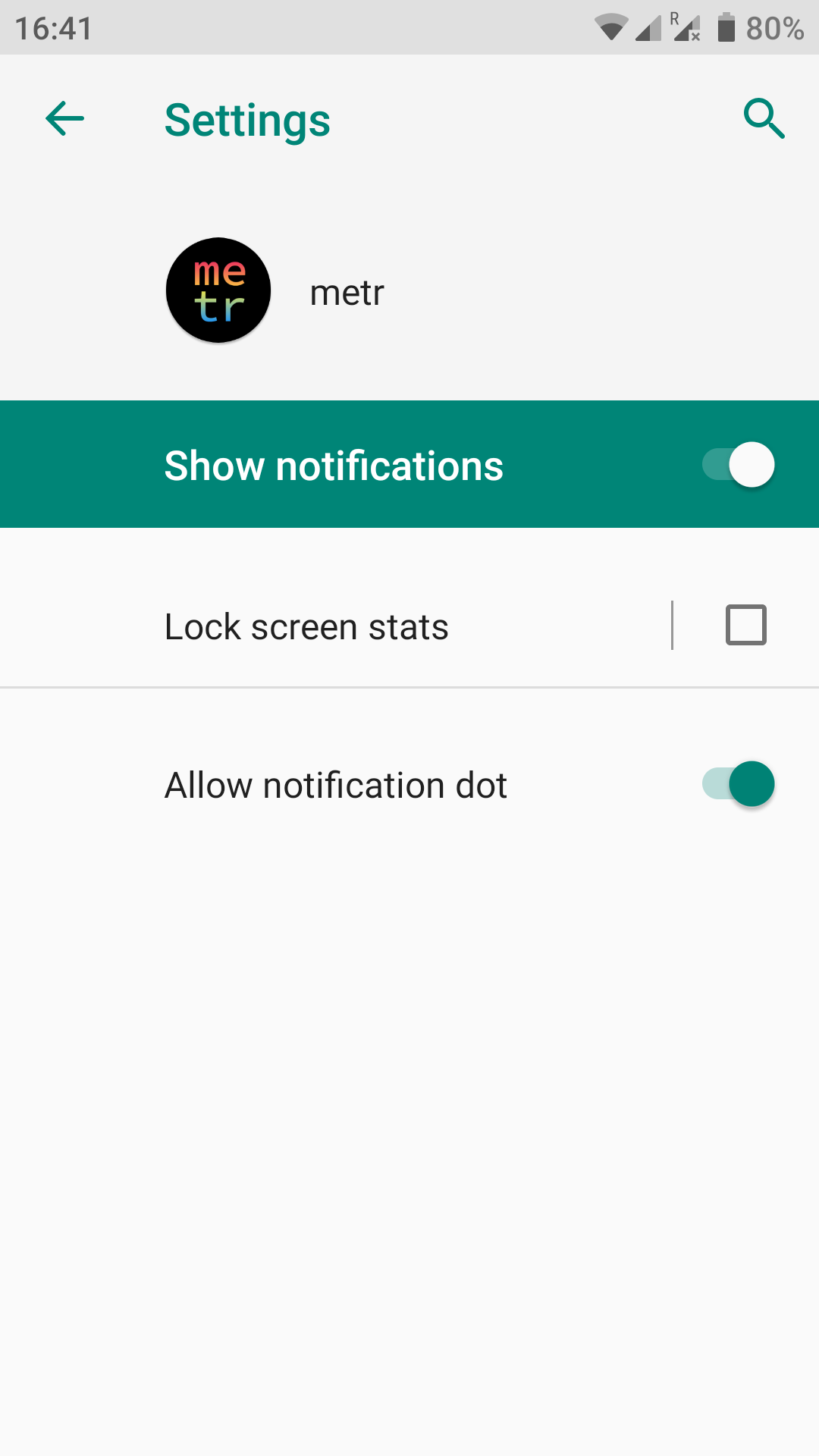

Looks good. Check “Location” and “Notification” permissions in Android settings for metr app, did you grant them?
↑ I Think permissions are granted.

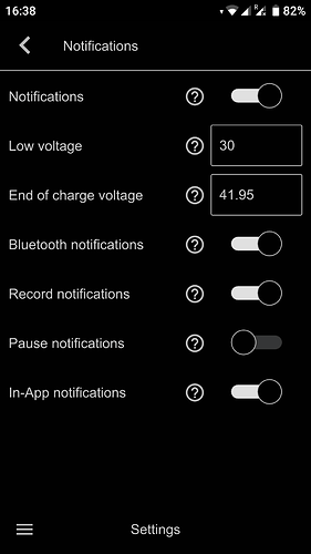

Does anyone know how to get my metr to read my battery voltage correctly? I have a 10s8p 36v battery my metr reads 42 v at full charge . I have changed the battery setting to custom ( 3.6 v per cell @100 percent charge)and voltage reading stays the same at 42v . The percentage reading changes to 100 percent.
that is correct.
why tho? 100% is 4.2
that is correct.
If you change the reading (%) you might have to restart the app.
Other than that, your battery is at 100% with 42v
3.6v is the nominal voltage.
Ah . I understand now . I was confused and thought the nominal voltage was full capacity.:+1: Thank you for clearing this up

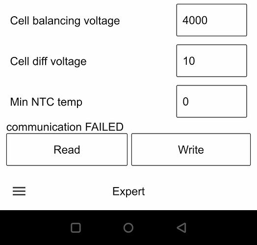

I am trying to set FlexiBMS cell balancing voltage with Metr. FlexiBMS is at FW 0.9, Metr Pro Unity module at 5.22 and the Andoid app is v 4.6.11.
I can read the config but when saving new parameter, it gives an error. Suggestions on what to try next?
Make sure you save while not charging. If you try to save new flexi parameters during charging it will not work. Disconnect charger, change parameters, connect charger.
Oh, right, I was charging. However, the FlexiBMS disappears from CAN bus if I am not charging so that’s a challenge… Just tried it and I cannot even read params if I have charger connected, then disconnect charger, then try to read. It gives the same error.
I was not aware of that. Maybe a bug in FlexiBMS firmware? Or is it intended behaviour?
There is a setting in FlexiBMS firmware to keep it on even after charging - “Always 5V”
I guess it’s intended, or maybe not. Gotta ask @SimosMCmuffin. :man_shrugging:

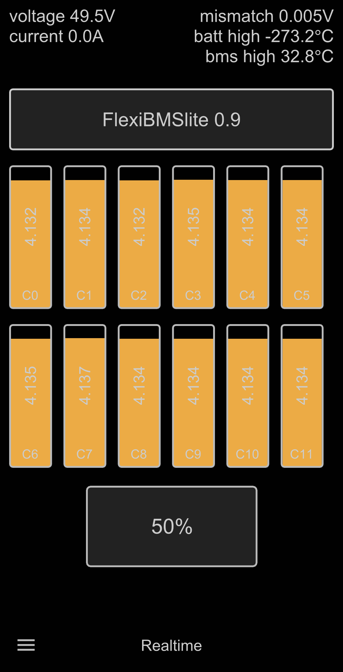

After rewriting the data a little from the expert mode, it looks like this. Is this bug FlexiBMS or metr?
The only rewritten item is Team cell voltage.
It was fixed when I turned the power off and then on again after 1 hour without doing anything. It seems that it was a temporary phenomenon.
