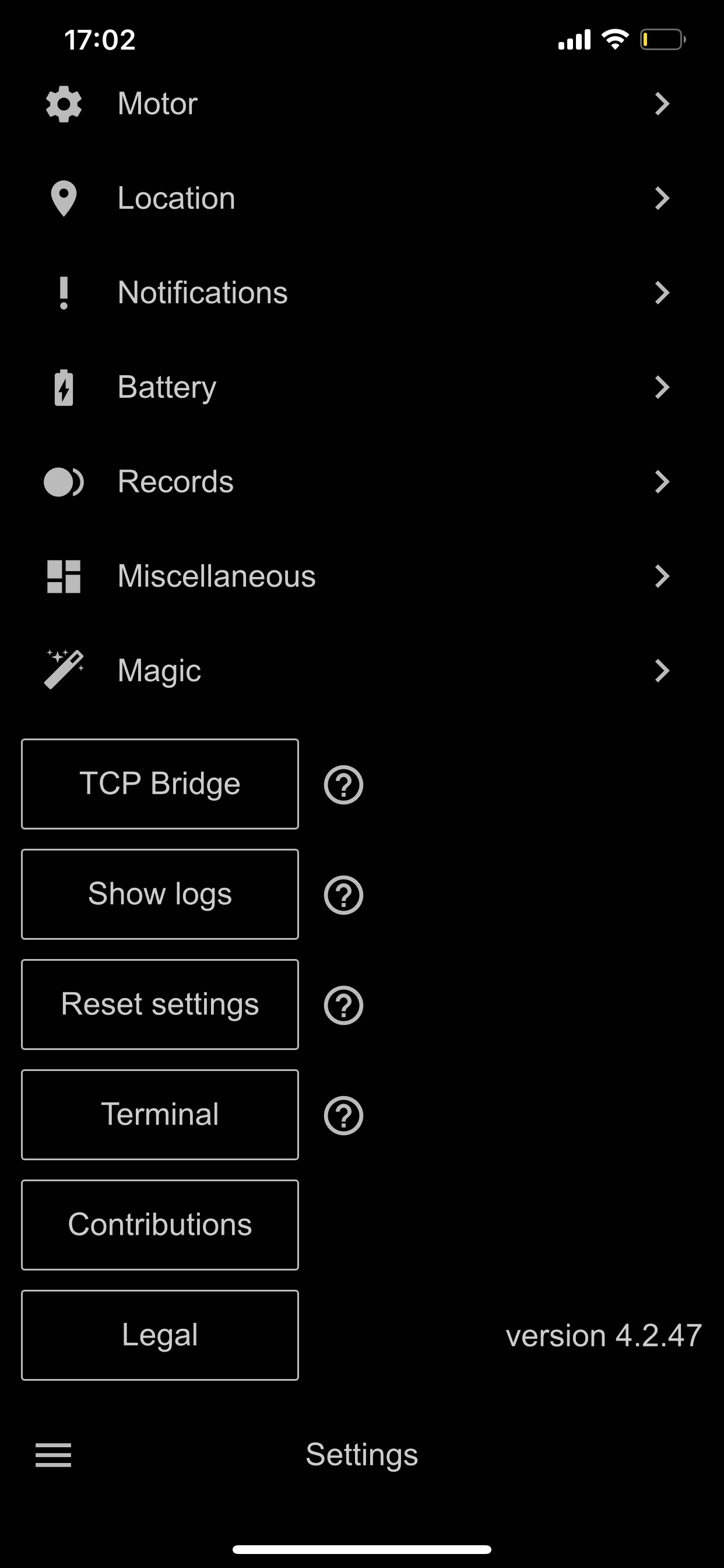

could you explain in rookie language how i use TCP to connect to my PC - and am i able to use the Focbox (windows) application (on the last version) or do i need to use the VESC tool (the official one)

You can use this version https://github.com/rpasichnyk/vesc_tool/releases and connect directly if your PC has BLE

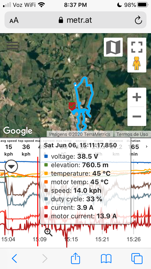

Hey Roman, since the last updates on the web viewer on my phone the slider stats cover the information of the bar
I think it’s due to my phone being lower resolution / screen size than what most people have these days
Is there something that can be done to improve it? Maybe move zoom button to the side?
