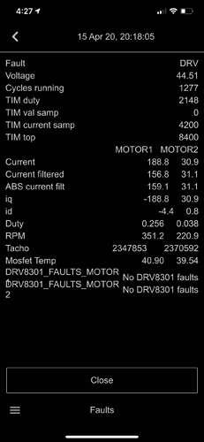

Anyone else get pinged with nonstop DRV error notifications by phone, airpod, and watch?
All notifications have and are always turned off. I thought they were. I’m pretty rigorous about not being bugged by a machine.
In the middle of a sick one, one I wasn’t going to stop for unless I smelled smoke or saw fire.
It wouldn’t stop, pulled head phones, turned off watch. Forced closed app. Rode on through the night.
There are no logs even though I actually started record this time.
I don’t believe it. I’ll check with laptop later.
Nope, mine behaves.
What’s wrong with MOTOR2? Why the big disparity between it and MOTOR1 current?
