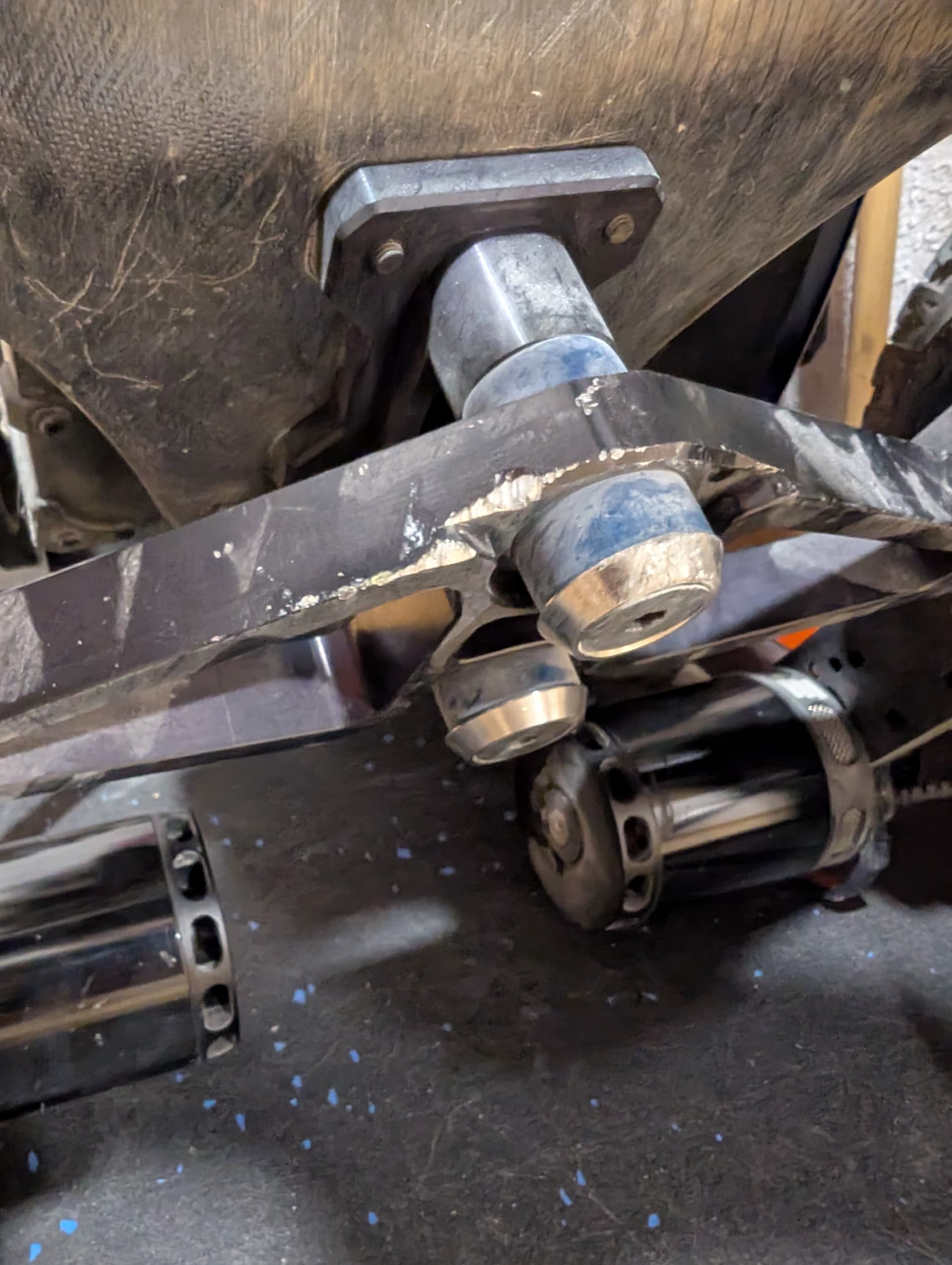

Clearance might be an issue though…
Are shorter bushings a thing?
With a deck tail that wide, you could probably drop-mount without much issue
Yeah they exist. Go to your nearest hardware store and ask for a rubber washer.
If your bolt can go down further.
I bet you can cut your bushings in half with a razor and patience and care.
Worth a try.
Mmm, but my problem is the distance between the wheel and the kingpins, how would drop mounting help?
Ah, I see. good point.
Idk but hacksaws are.
While waiting for more bushings to arrive in case cutting them ends up being a bad idea, I’ve kept riding and testing (mainly the remote, which is delightful now). Have I mentioned I ran out of loctite while assembling the board? Well, the new one took it’s sweet time to arrive and I forgot…
This is your reminder to CHECK YOUR TRUCKS AND LOCTITE EVERYTHING
Fortunately I heard a rattling noise and slowed down to check, otherwise this message would have been typed from the hospital
Good catch! What type of loctite did you use on the kingpins? They’re fine thread so I was thinking blue would be enough.

Yes, blue loctite (243)!
