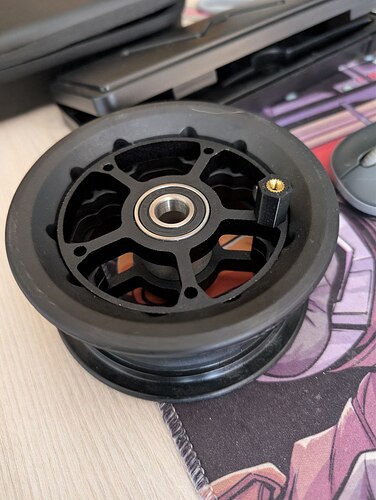

Wheels
Love these things: https://es.aliexpress.com/item/1005004421651908.html?spm=a2g0o.order_list.order_list_main.244.4d12194dNRPymT&gatewayAdapt=glo2esp
But definitely used to be cheaper when I bought them almost a year ago.

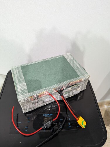

I strongly recommend getting cheap skilled labor to build your batteries (my GF is the best):
TBH not much to say about this battery, except for maybe the 3D printed holders. Standard 12S5P brick layout, 30mm 0.2 nickel strips, 6 welds per cell, LLT BMS with bypassed discharge path.
