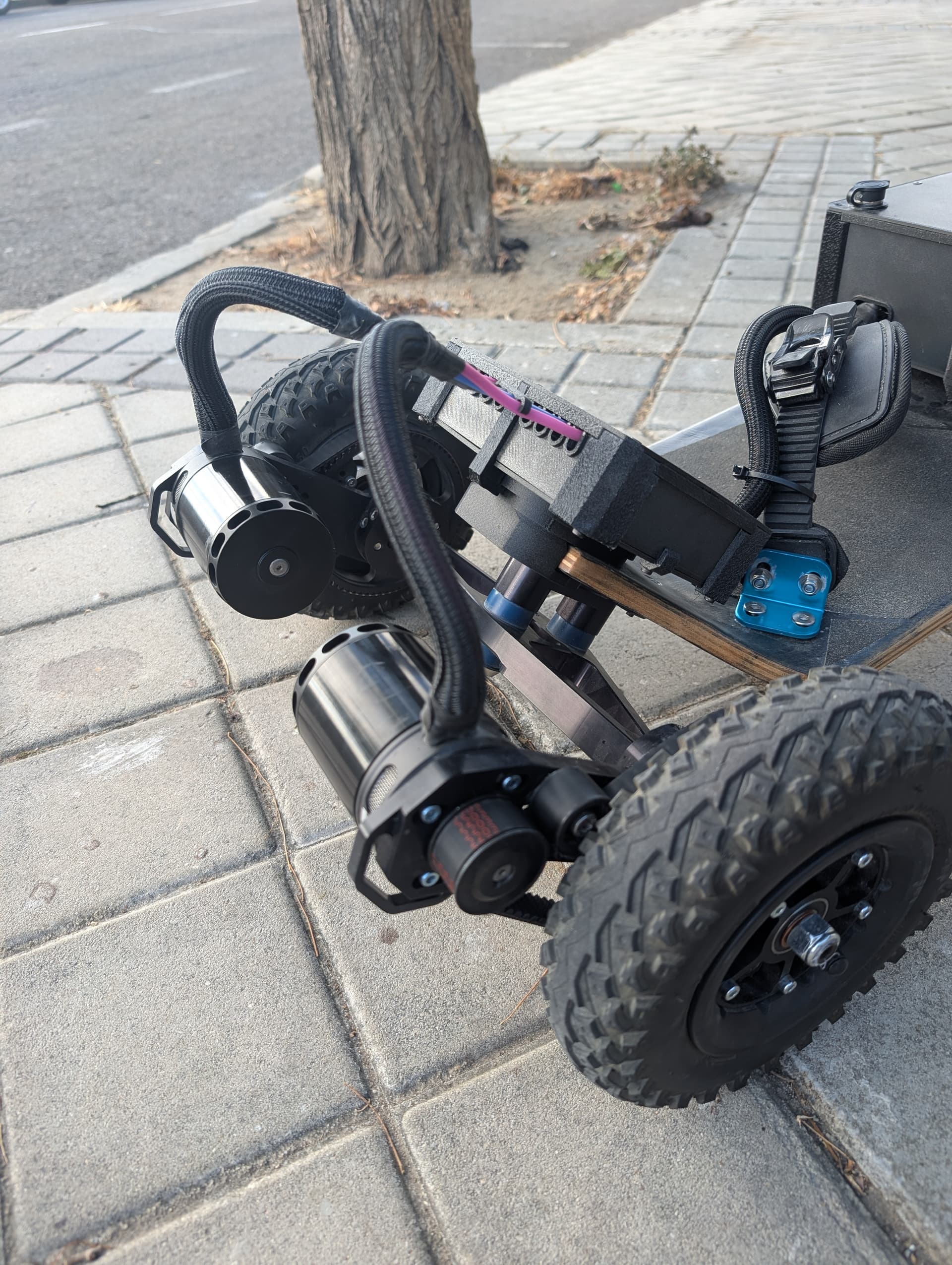

The Idea TB parts are so nice!!!
I wonder if there’s any advantage to mixing duros on the same truck like with Airs. Would be cool to see a tuning thread dedicated to these.
Definitely want to try. Open to suggestions about combos, but my intuition tells me harder duro boardside with softer roadside might help reduce the twitching in the back.

So with Airs, I run the exact opposite, softer board side and harder road side. The soft bushings between the deck and trucks dampen a lot of vibration and the harder bushings road side help with stability. Using the search function on here doesn’t show much about these trucks so I’m curious to see what combo you end up settling on. Will be joining you in experimenting with these in a month or so, ordered 320mm hangers with 53mm axles.

  • Increased bushing preload in rear truck: Still need to test the harder duro, but noticeable improvement in stability. I’m loving these more and more with each km.

Are the trucks on the same angles?
If not it may be worth considering a wedge in the back.
Yeah, they’re about 35deg each. I say about because it’s very difficult to make them 100% accurately with my mold. I’ll consider if the bushings don’t fully solve it, but had bad experiences in the past (bent screws, holes becoming oversized with time…) and would like to avoid them if possible

  • Trucks: a healthy amount of preload has led me to believe changing to the harder duro is probably not even necessary. They ride like clouds, carving is delightful and I feel very much in control of the board.
