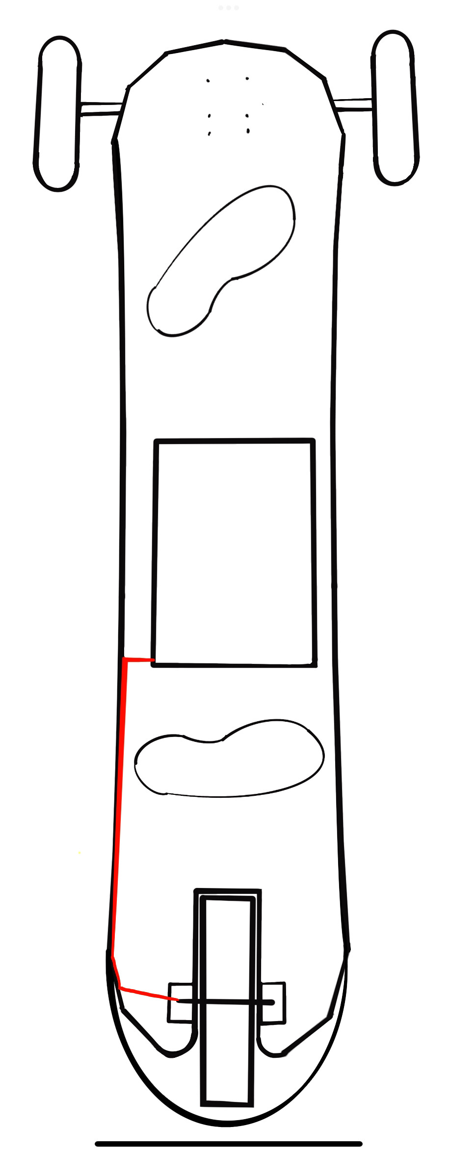

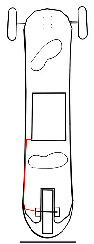

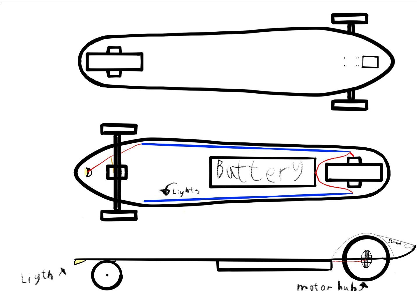

But unfortunately here in Norway we have a lot more restrictions than most other countries. So, building a board that would be legal using off the shelf parts is very hard. But then I realized I could buy a legal E-Scooter (Esk8’s and E-scooters follow the exact same laws). So by thinking a bit too hard I came up with a pair of basic designs.
After this design was created I started looking at MTB’s and altered this design to fit more of that style of board

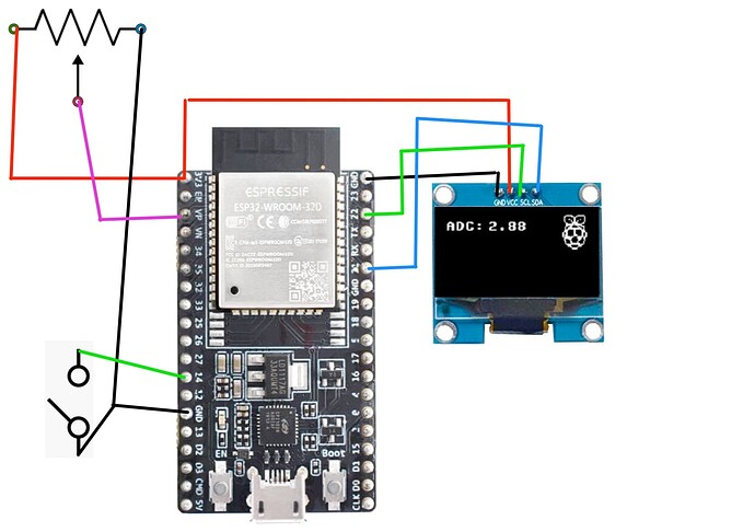

The next thing I did was finding out how to control the E-scooter via a wireless hand controller.

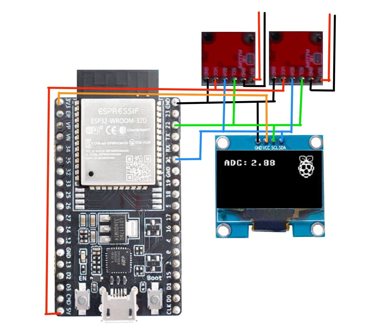

After opening up the scooter I found the connector that controls the throttle I then tasked me dad to help me make a transmitter for the ESC and receiver for the hand controller

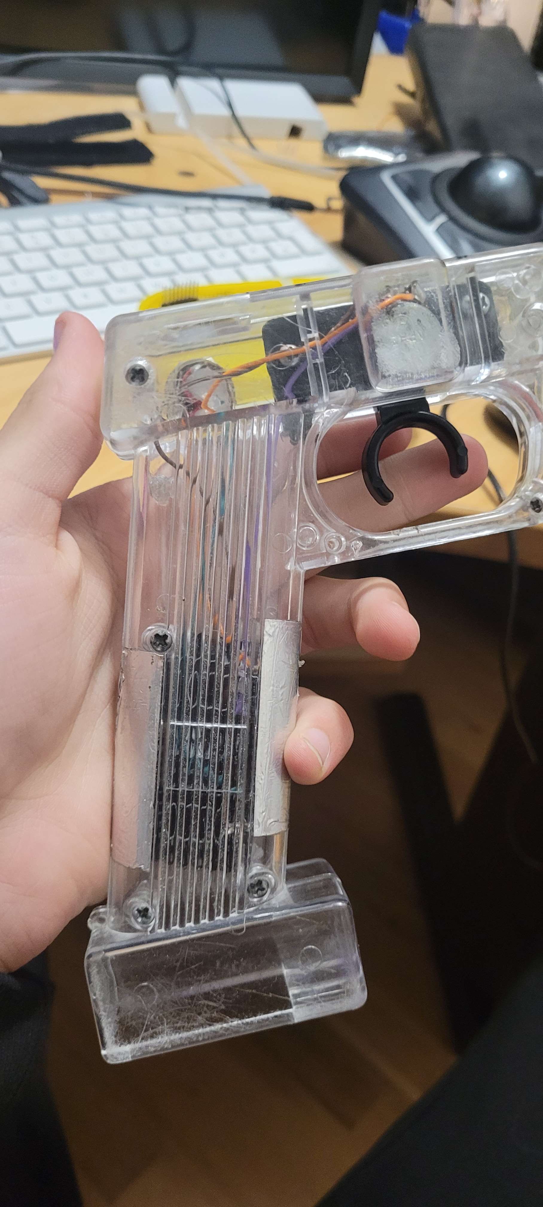

(Hand controller)

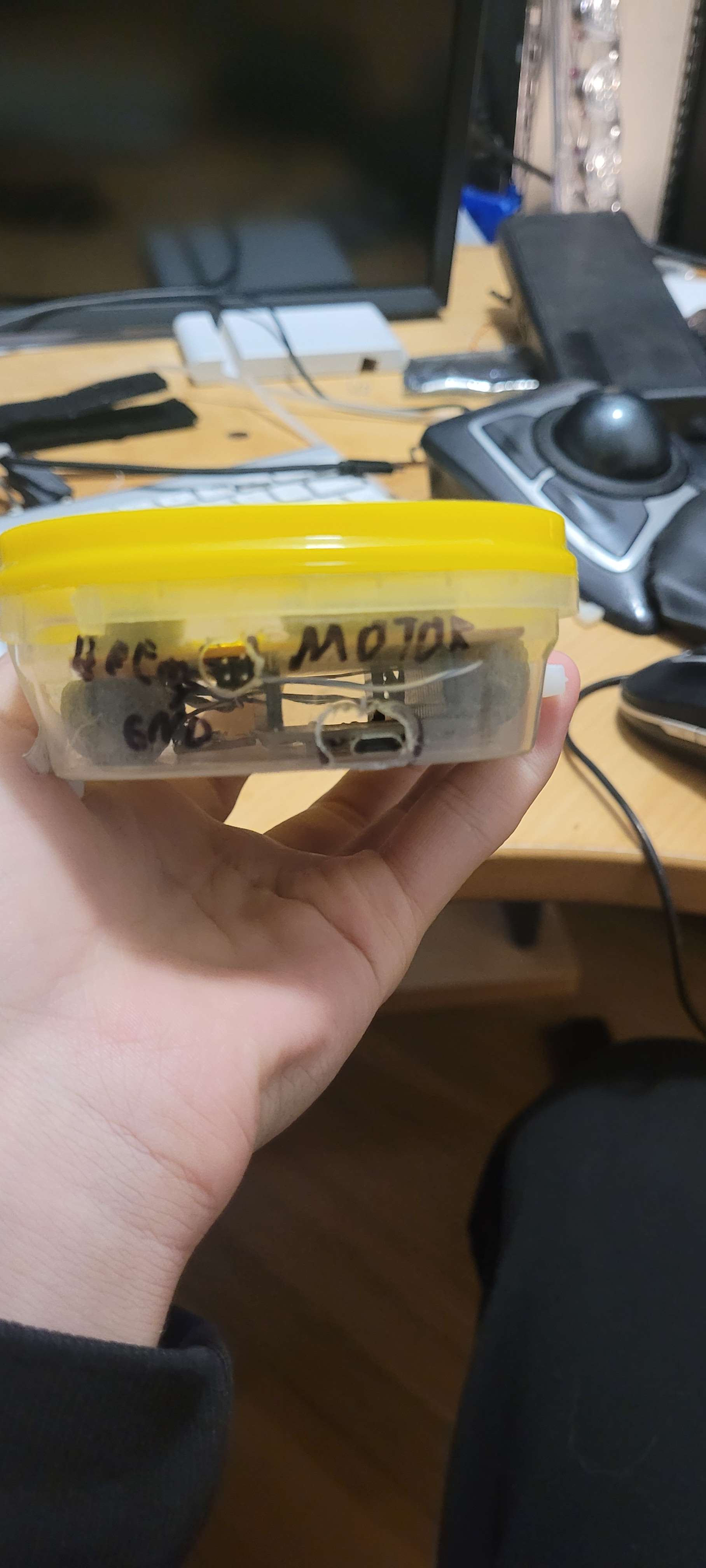

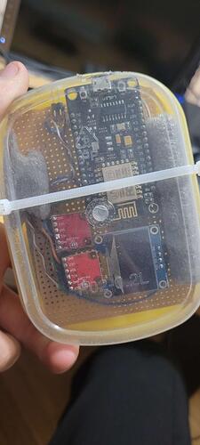

(ESC controller/Throttle control)
These two in total took 2 months to solder and make sure they works.
(finished results)
(bottom showing the screen motherboard, and the “throttle” [the red things])
(Side showing the pin out of controlling accelerate and brake, and the power in [fun fact this things gets it’s power from the light power source {I’m using something else than the light system that comes with the E-scooter}])

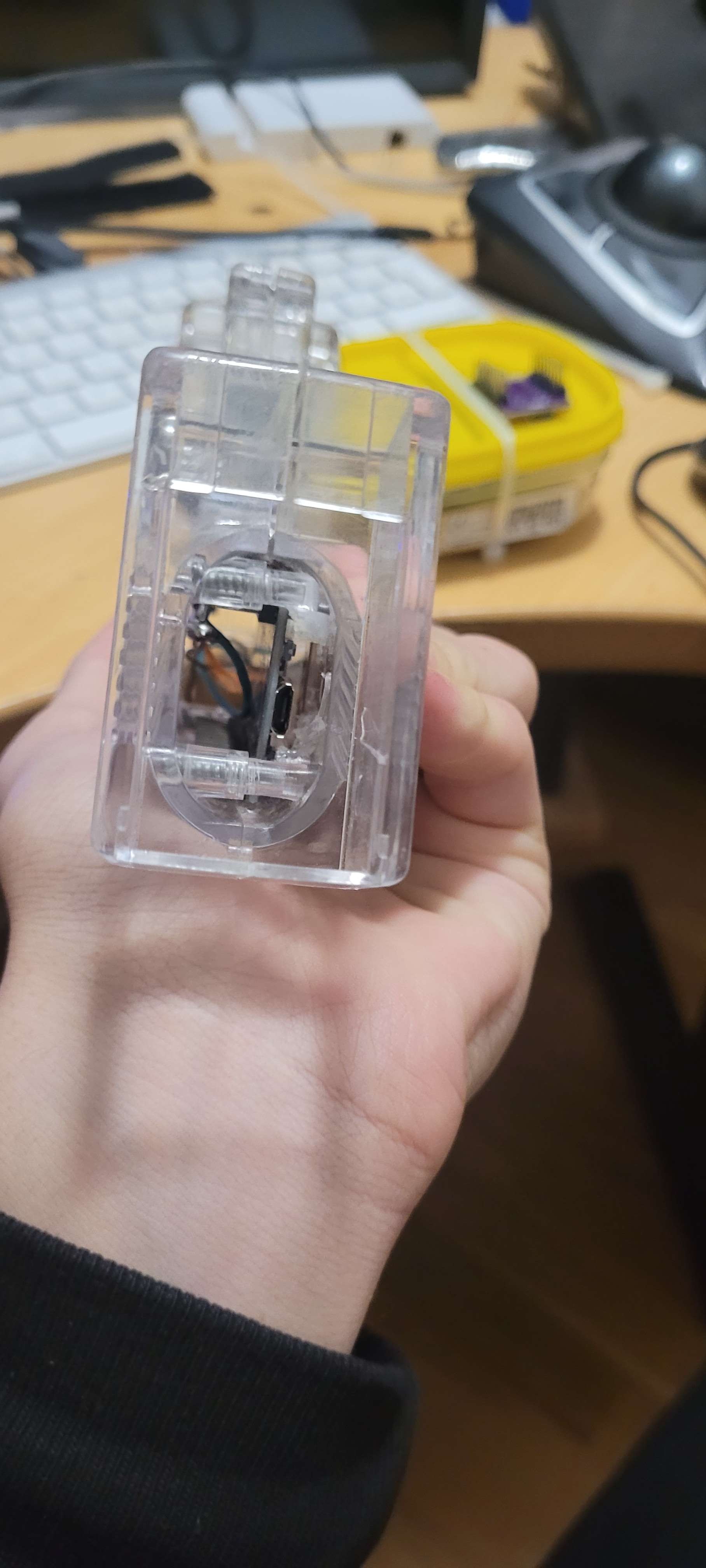

(side of the hand controller, showing the motherboard, button and the throttle)
(this thing doesn’t have a battery inside it yet so it’s powered by a powebank in my pocket)

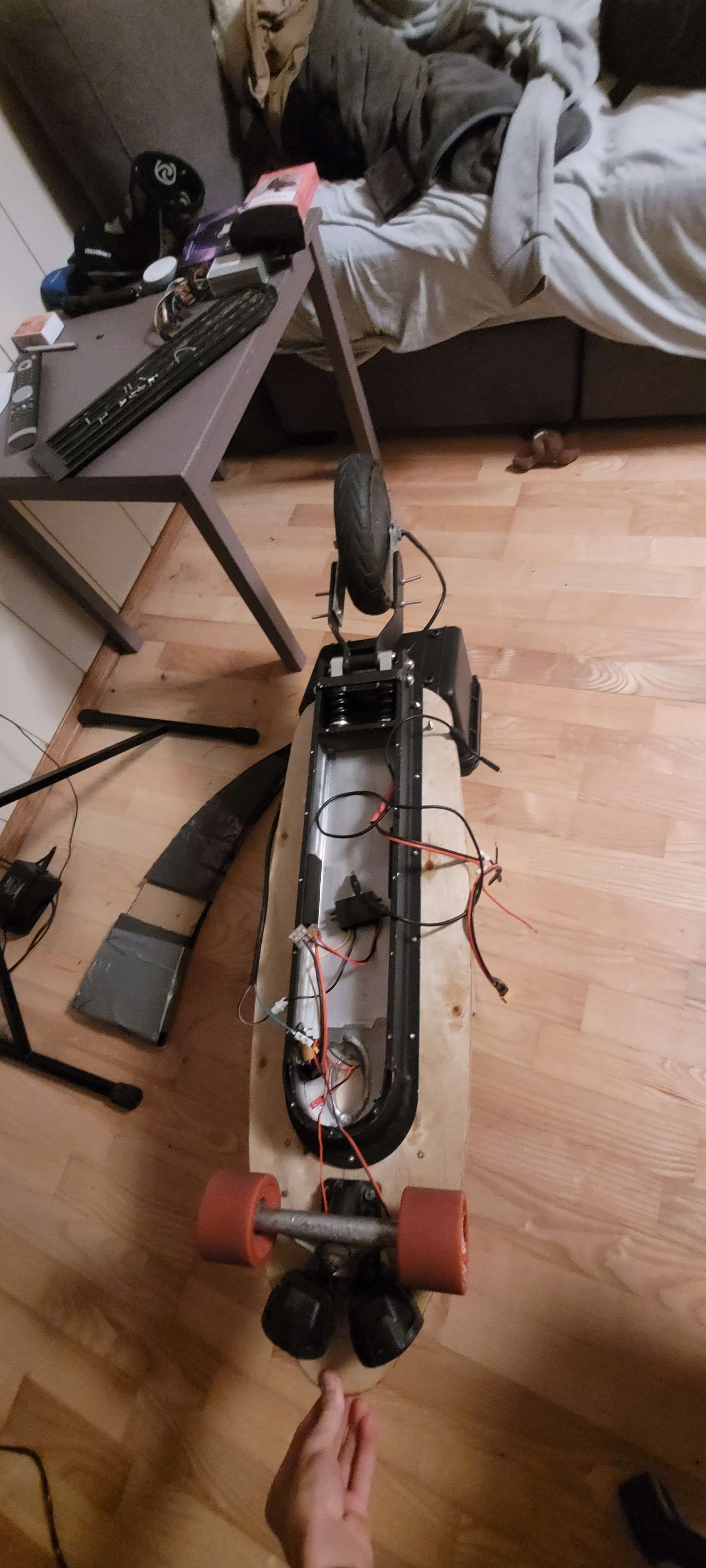

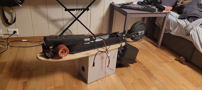

So after inspecting the damage it turns out the ESC is dead and I haven’t checked out the throttle receiver yet, so now the board looks like this in the middle of my room.
(the board would tip over if I don’t hold it [It is very back heavy with the box on the back]
So until the new ESC arrives and I get to repairing the new throttle controller this will stay for a bit.
