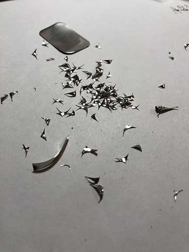

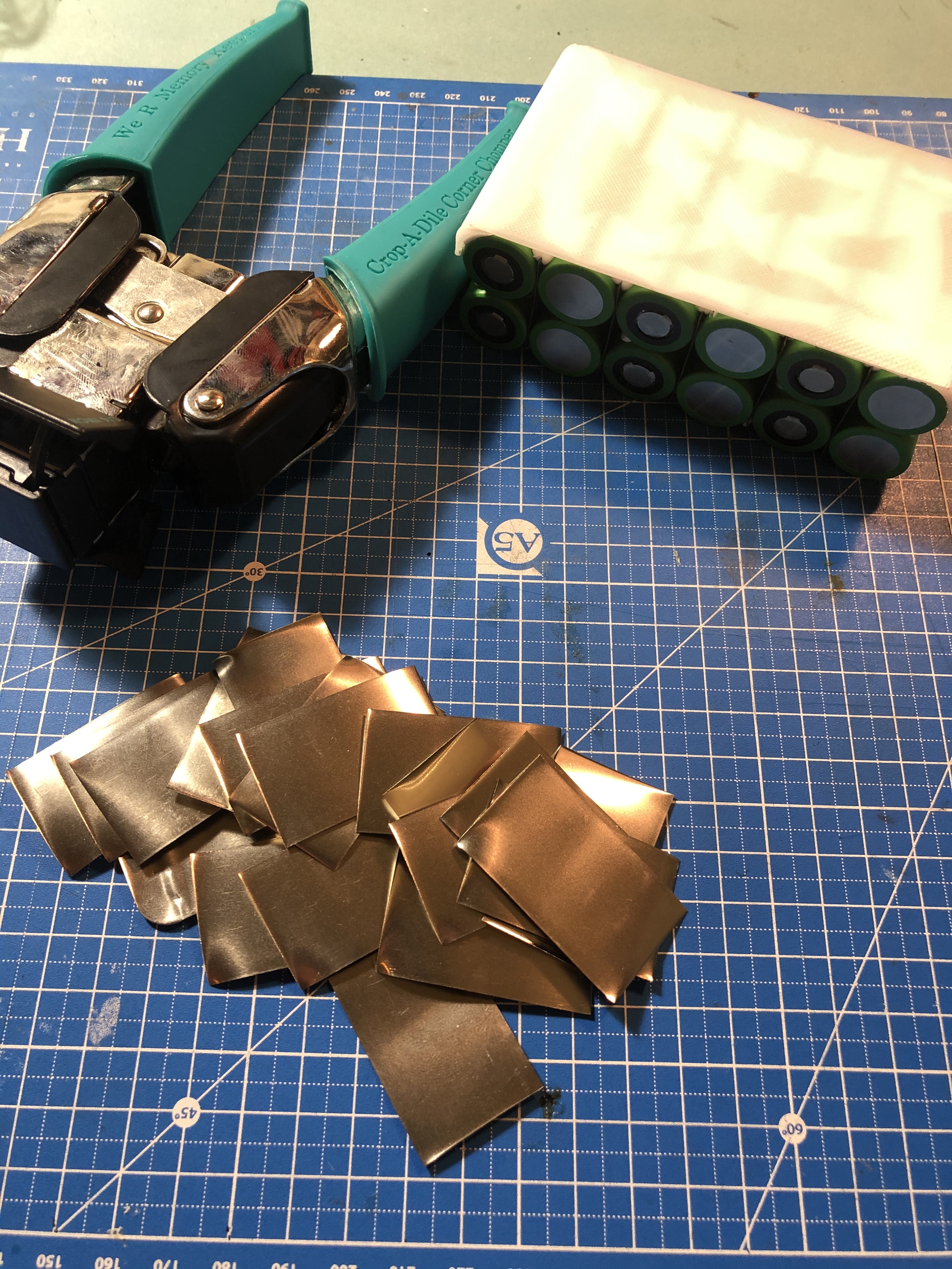

Always get some 5 extra cells and don’t forget to check the voltage of each cell as well as your nickel before starting to put your battery pack together :point_up:
Cutting corners (it’s 25x0.2 Nickel by the way)
The p-groups are glued together with neutral silicone. Fishpaper is inbetween of each group. From top and the sides are covered with a 3D printed sheet.
A 3D printed sheet is between of the two rows of each pack ad well but just added that after welding.

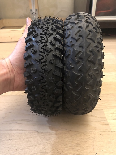

Got two of the 9“ Trampa mudplugger and installed them on the back wheels.
In direct comparison to the 9“ mbs:
The mbs wheels are a bit wider and higher.
As the mudplugger wasn’t inflated in the first pictures, here one with mbs deflated and mudplugger inflated.
The mudplugger seems to have a much more aggressive tread.
I like it.
The mbs is very similar to the 8" Trampa tyres which have a very mellow tread. Good for the road and hardpack trails but not good for loose off road
