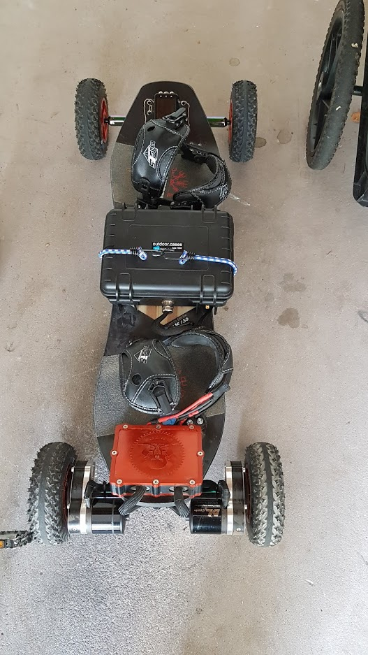

The BRO | 12S8P | Haero Bro Model | E-TOXX Dual Direct Drive | 170kV 6374 Maytech Closed Can | Dual VESC 6 |
Already? And your motor cables looks kinda funky coming out of the motor. (or is it just the cable rubber i see between the heatshrinks)
Didnt the motormount shift on the hanger again?
It’s the heatshrink.
I’m on it
Dumb question. What’s that clicking sound at the beginning?
It came definitely from the right wheel. Bearing?

Sounds like a bearing to me.
this is how mine sounded last year (fucking mbs bearings , who would’ve guessed.)
FAG bearings btw.
Most likely a bearing, lube the axle and bearing seat a little and check again. If that doesnt work check your pinions, one of my pinions came loose at some point and I also heard a similar sound. Could also be a motor, since one of my turnigy sk8 motors also makes a slight bearing like clicking noice, but I doubt it because your maytechs are fairly new.
After 10 km one of the mount plate screws of the left side came loose. A friend picked me up.
But definitely it’s one of the bearings at the front and I can feel the clicking during a ride.
Y u no carry tools?
Would come loose after first meters on gravel paths.
Y u no loctite?
No. I applied some 243.
It’s probably the cause of the slick hanger
I’ll eyeball that further. Right it was an non issue.
